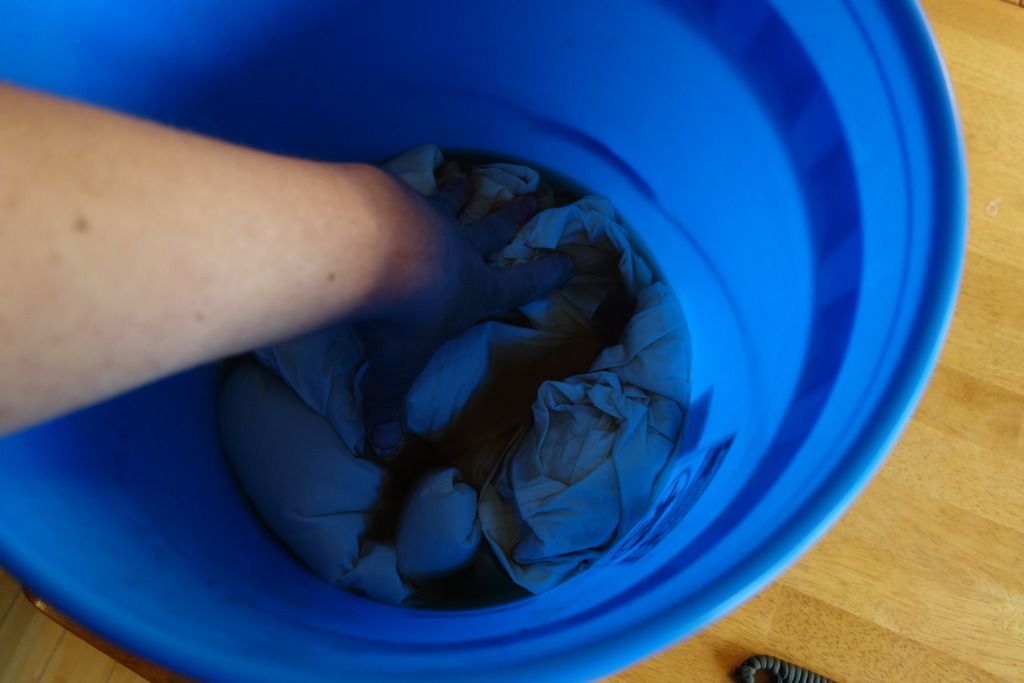

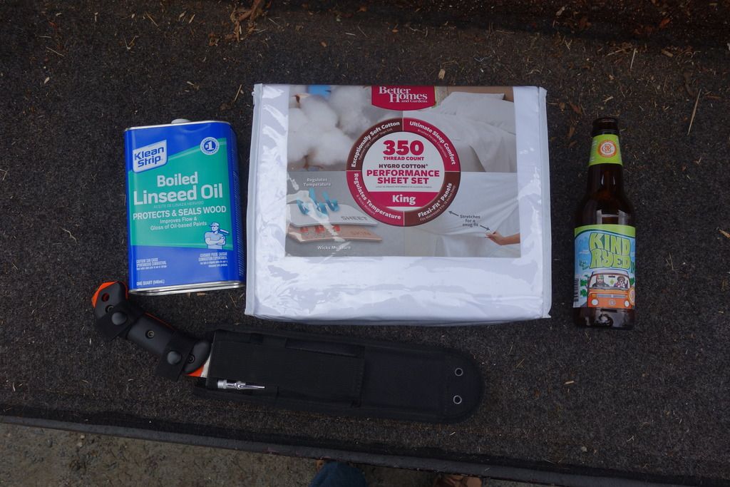

I made my own oilcloth tarp from a king bed sheet. I was gonna take it out and use my BK4 to build a camp setup around it. The tarp dried too slow and it poured rain every weekend. I also did a pillowcase for a drybag for my pack basket.
The tarp was made by soaking it in a 50/50 mixture of boiled linseed oil and mineral spirits. I got a sheet set on clearance at Walmart for $20. :)

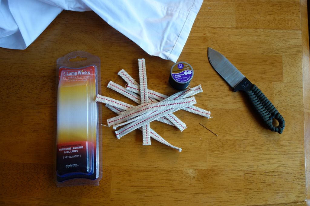

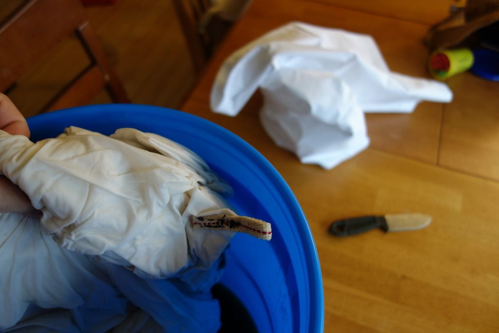

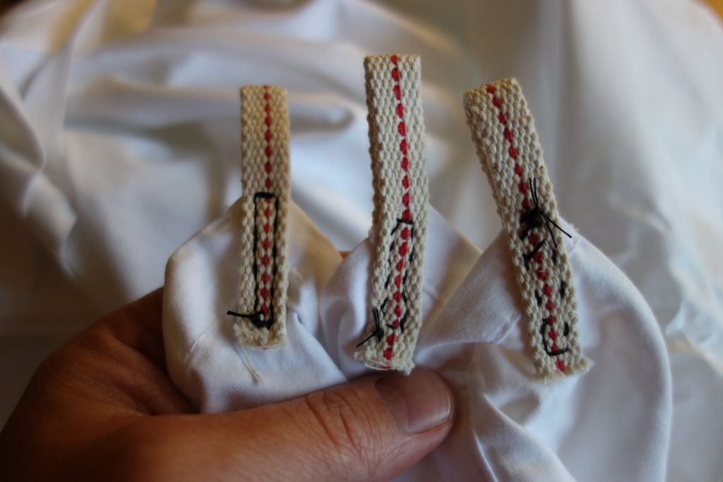

I used lantern wicks for tie outs and hand sewed them on with upholstery thread. I got this idea from someone else and it worked great.
By the third one (the one on the left) I got a pattern going I liked. I went back and fixed up the first two after. They seem plenty strong.

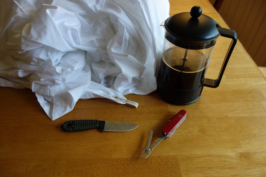

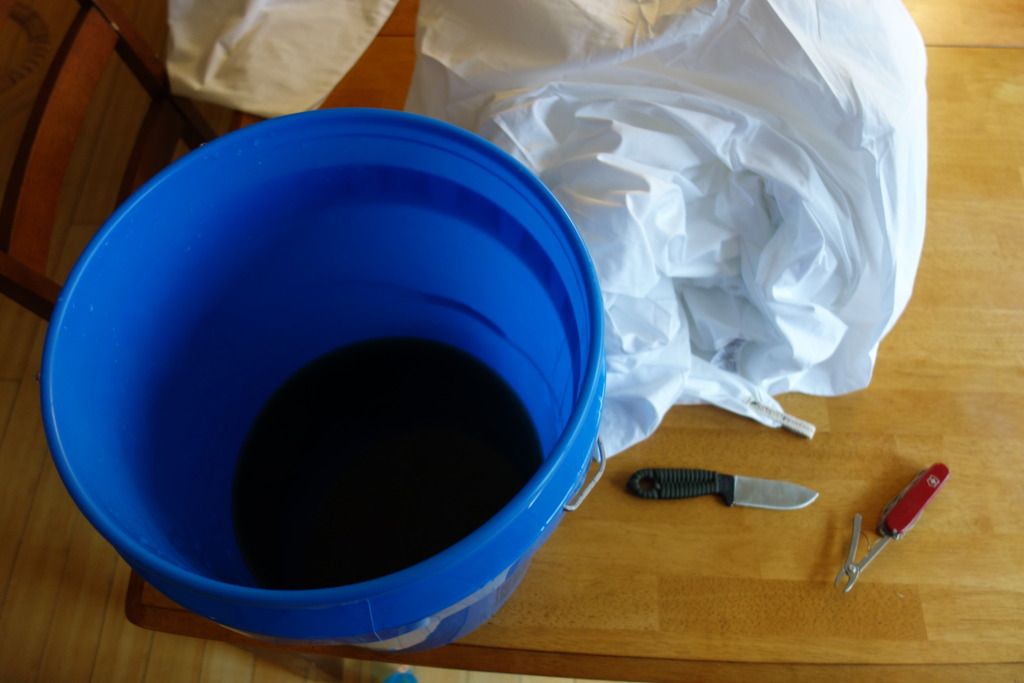

I thought I would dunk it in left over coffee to dye it. That didn't really work at all.
After that I dunked it in the oil mixture and hung it over a bucket and wrung it out. I didn't wring the pillow case out as much and it is stiffer. I wasn't sure how "wet" to leave them and only time will tell I guess. If the sheet came out as stiff as the pillowcase I would not have been as pleased. I bet that in a pinch I could carry water in the pillowcase though. I am gonna try here soon.

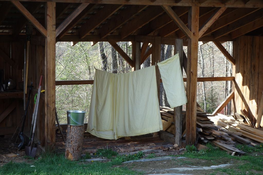

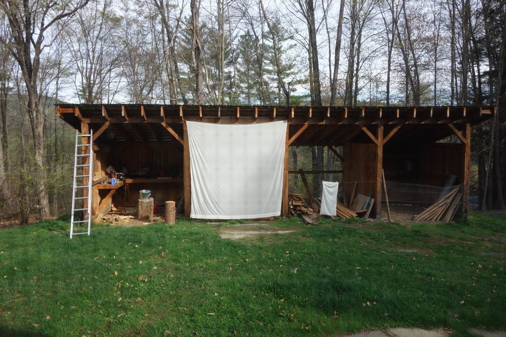

I then hung it up on the wood shed and let it dry. Since it has been raining so much it took like 10 days to dry but it seems to be dry and waterproof now.

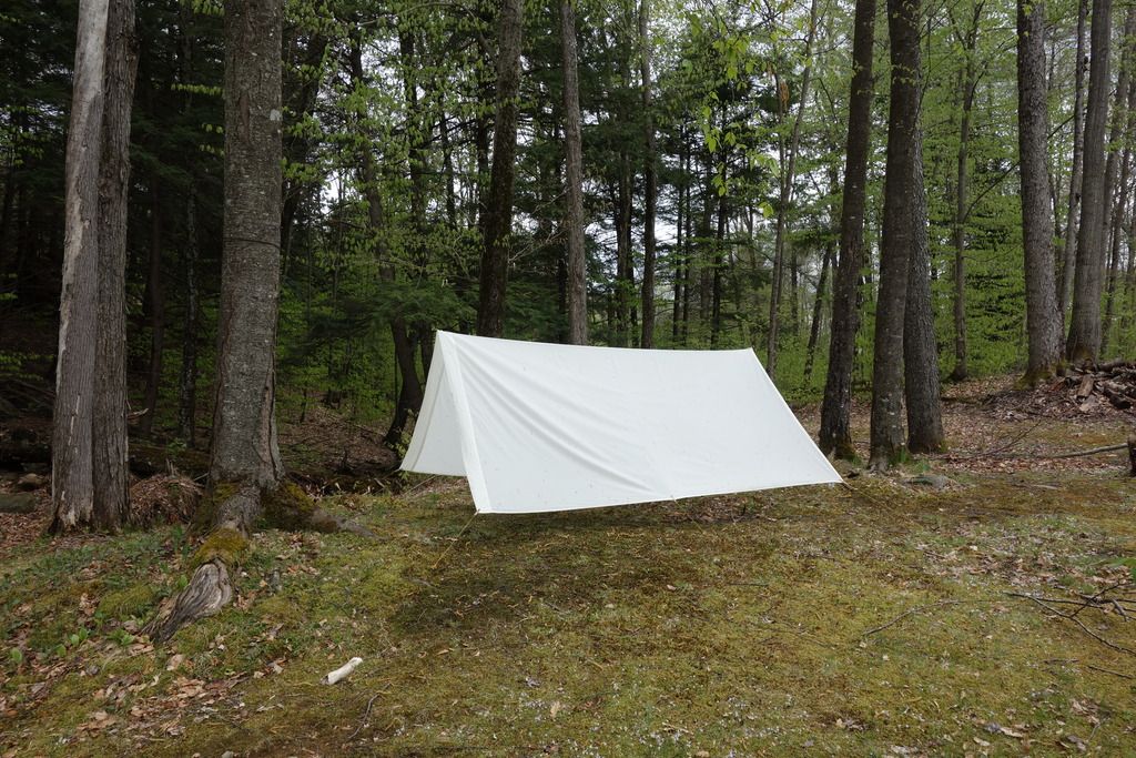

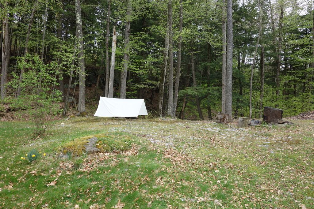

It has been set up in the yard for a week now getting hammered by wind and rain and all seems good. I cannot wait to take it out and sleep under it.
