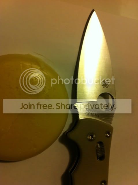

because most of my knives will see food sometime in there life, i made a 3 to 1 mixture of beeswax/USP mineral oil to coat the blades of my less stainless/carbon steel knives. i melted the beeswax and added the mineral, mixed it, then i let it cool and solidify. i rub the block a little on the blade and smooth it to an even thin coat.
