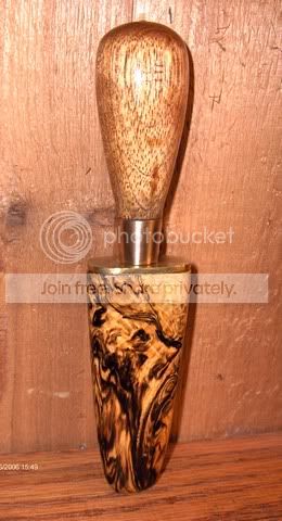

Living in southern Alabama 7 miles off the gulf coast all my life.I have been thinking of making myself a oyster knife.
I go oystering several times a year and thought since I am making knives now,heck make yourself a oyster knife.
At the moment I do not have the ht oven to deal with stainless steel.So .at this time it is not a option.
The steels that I do have are 52100,o1,and w2-(thx Don Hanson).Of these 3 steels,which is a better steel for a oyster knife.
For a oyster knife the blade would have to be able to withstand alot of torqing and side pressure.
I know that rusting is a problem ,but I intend to keep the knife clean after every use.
Thx for your help.
I think any of the steels will work just fine. You can put a mustand finish or gun blue them to help with limiting rust.
They'll all work fine I think, I'd personally use the 52100, the O-1 is the most expensive and rustingest steel in the lot and the W-2 is the most scarce. 52100 will work fine and is the easiest to replace, both in availability and cost.
I made one over a year ago from 1084 and it has held up to alot of use. So far it has shucked at least 100 oysters.
Blacksmith oysters knife.
Mild steel forged to shape then use belt grinder to refine and super quench, works for Puget Sound oysters, maybe I got a picture, have to look.
