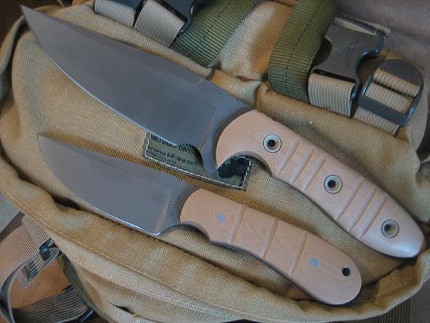

Here is the updated version of the p fighter, I am really liking it. It balances right in the finger groove, being just a tad blade heavy.
Made from 1/4" 1080 steel, coyote G10 with stainless tubing in the handle. Parked of course.
11 3/8" total length
5 3/4" blade tip to handle

the little guy is a 360 out of 3/16" 1080
the soldier who ordered these requested a little more traction in the handle than I usually do, and I like it a lot.
