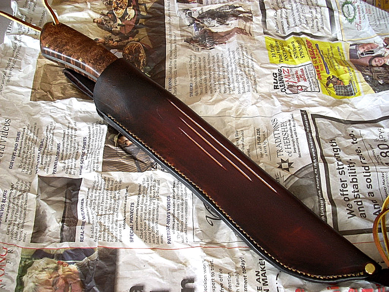

Curly maple handles with red mahagony stain and 3 coats of Tung oil.

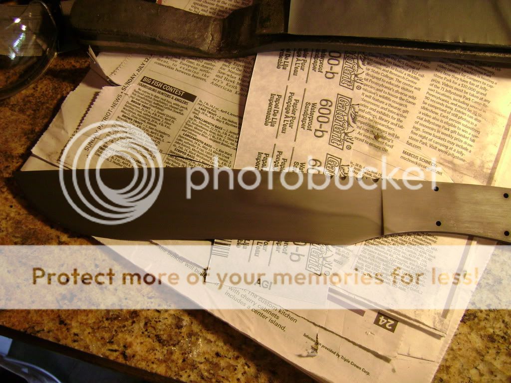

Blade is hand polished to 600 grit and a ColdBlue finish.

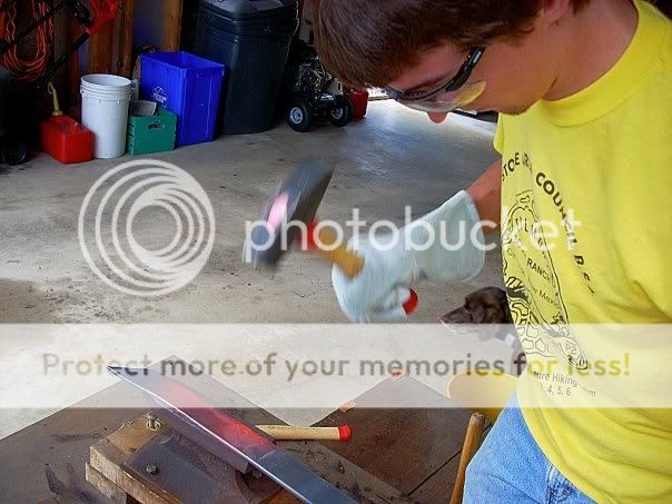

Cutting the 5160 at about a 45 degree angle to help save some work
Forging away!

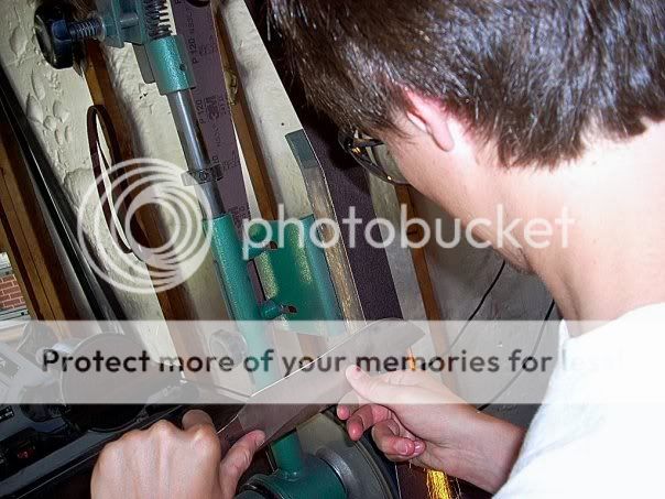

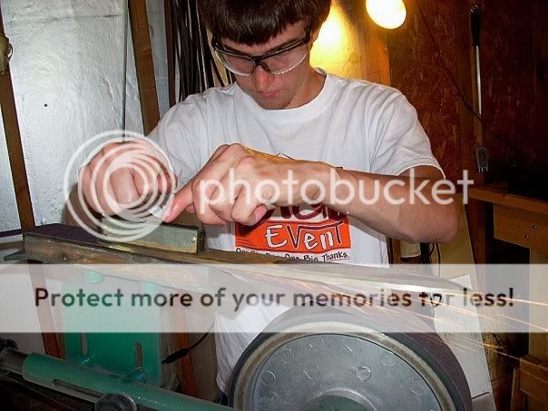

Flat grinding the tang for a perfect taper and straightness
Attempting to grind in the taper and beginning point of the blade. I didn't quite have the hand, so Bob did most of the grinding here.

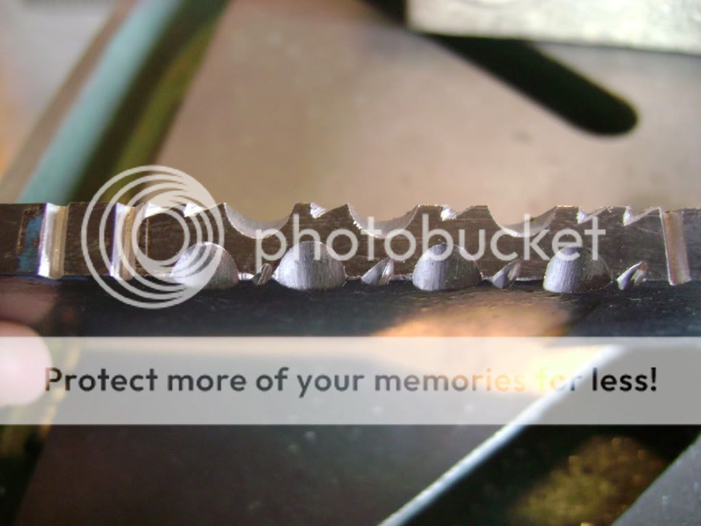

Using some small hand files to put some filework for both asthetics, thumb grip, and a transition from handle to blade
Lots and lots and lots of hand sanding! Started at 100 grit and worked up to 600. I think it took about 3+ hours!

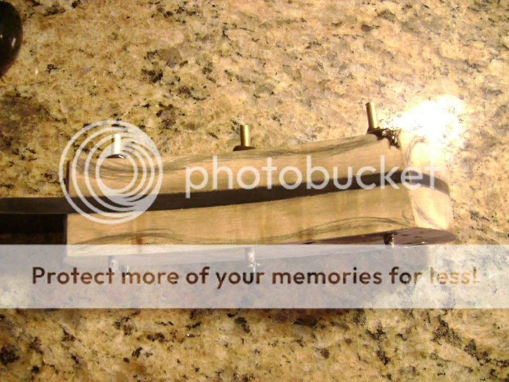

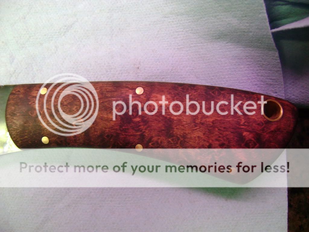

Here we have the scales cut to shape and glued up with some ugly pins just to hold it in place

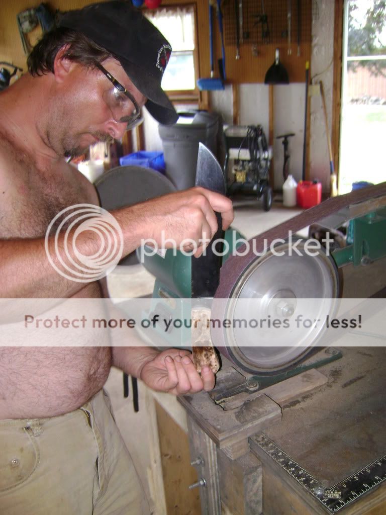

Here's Bob shaping up the handles on with his belt sander. It burned the woods since we were using old belts, but we managed to get it all out. He did a really nice job with the contours and although its a beefy handle, it's very comfortable
Applying the Red Mahagony stain. We put 3 coats of the stain, and then 3 coats of high gloss Tung Oil
The Birdseye Maple turned out absolutely gorgeous and even has hints of Tiger Stripe along the top and bottom of the handle. I really love the deep grain that is shown
