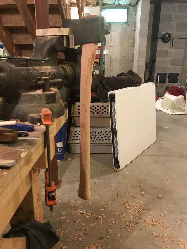

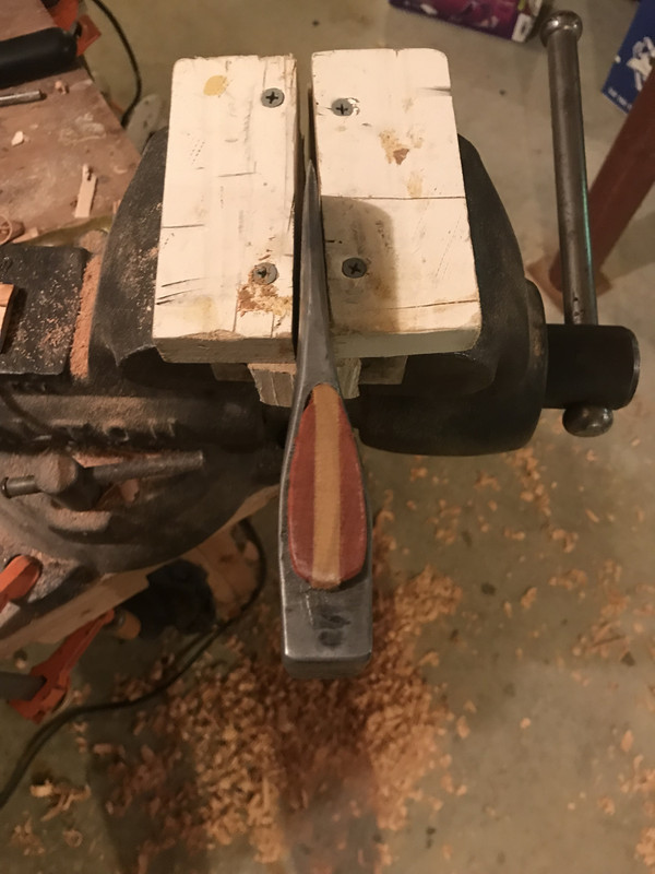

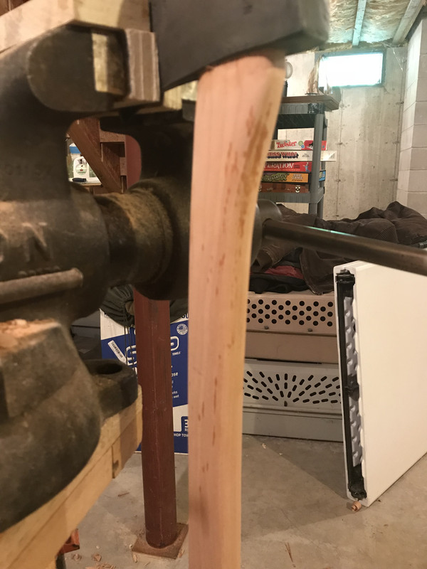

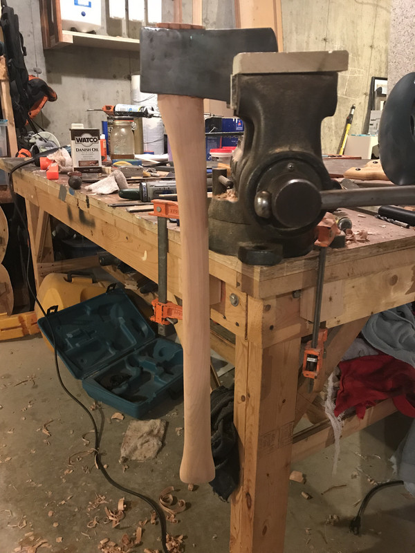

Thoughts on cherry for a 24 inch stright handle. I have a board in the garage that keeps eyeballing me....

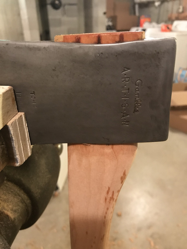

The dark spots are oil that has penetrated down from the top of the toung. It’s made it down the handle over a foot. Thought it was kind of interesting to see how far the oil travels in the wood. The handle is cherry, kind of an experiment to see how it holds up and how I like the handle shape. 2 pound head 6 eye ridges 24 inch stright handle.
The axe sir is beautiful...
That Wilton vise is awesome!

You don't usually see curved handles on double bladed axes. Is swinging the axe anymore challenging when you swing from the head opposite the curved handle?
