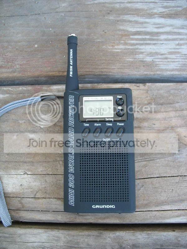

Google the Grundig Mini 300 AM/FM/SW Pocket Radio. Several of us here have them. Good compact radio for the price. Not waterproof, but rubberized a little bit. I use mine a lot. The only complaint I have on mine is that there is a ton of drift in the tuning selector. It often gets out of tune with temperature changes.

i have the grundig mini 300pe. It's got a great reception and sound but is hard as hell to tune up really well. If they'd raise the price $10 and put in a REALLY SMOOTH pot, it'd beat anything you can get up to $70. As it is, it's tough to use for SW listening, and a bit hard to really tune up well in crowded AM areas. The ONLY downside to the great reception is it makes your MW band crowded! :D
Also- if you own one don't waste your time on an antenna unless you are going to do a 60 footer. the little reel roillup ones do NOTHING for the radio. Making them is easy, you just need wire and an alligator clip.
