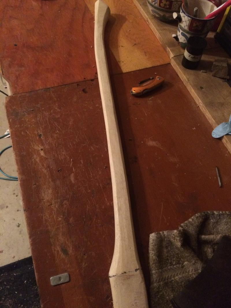

Several months ago I stopped by an army surplus store and they had a barrel of handles in the back. They were, for the most part, really thick and some were pretty uneven looking . I picked up a 28” single bit handle that was really over-sized that I used to hang this axe and am satisfied with its soundness for a tool handle.
The other one I picked up is 36" and was like the first – too thick overall to just hang something on it without going at it somehow. Being that I am on an octagonal handle kick I’ve been trying my hand at octagonalizing on my own. This is my first attempt.
Anyone have any tips or tricks to running a spokeshave or what to look out for when octagonalizing?
Wish I had a before shot but I wasn’t really planning on it turning out well to be honest.
Here is what it looks like at this point:

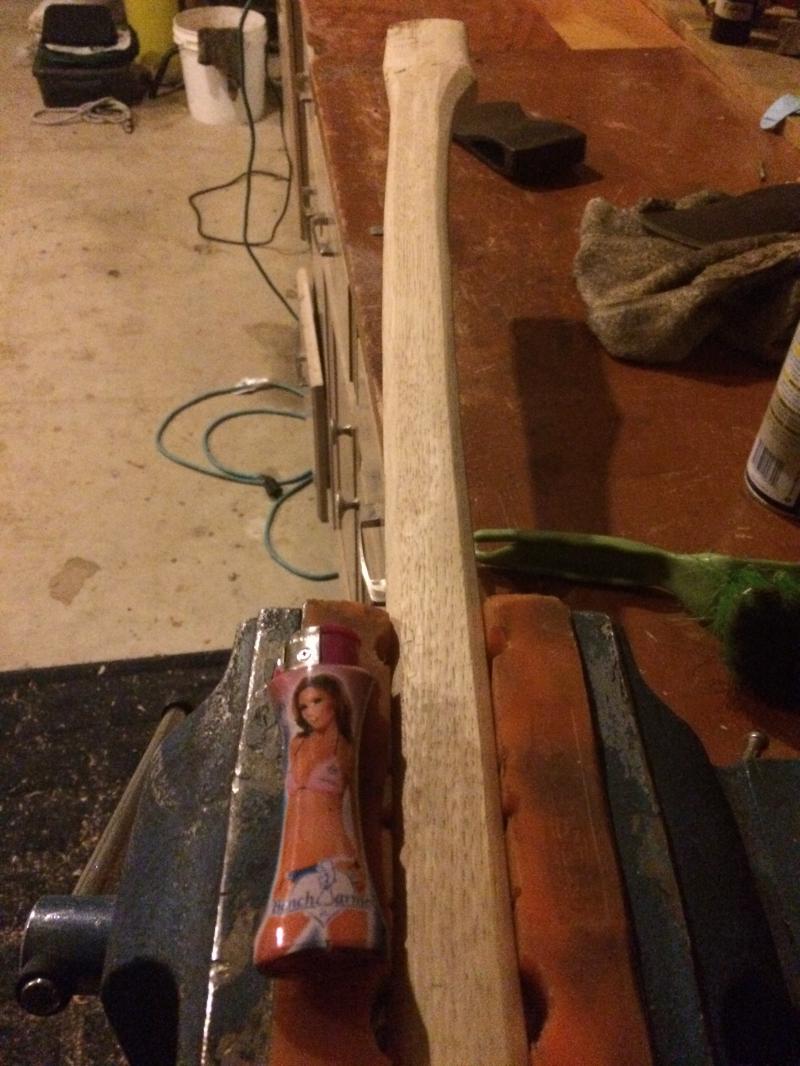

Oh, my wife was joking last night about me being concerned about the wrong “curves”. This was sitting on my vice here when I got up this morning. She can be pretty funny sometimes. At least she supports my habits/hobbies that keep me around the house lol.

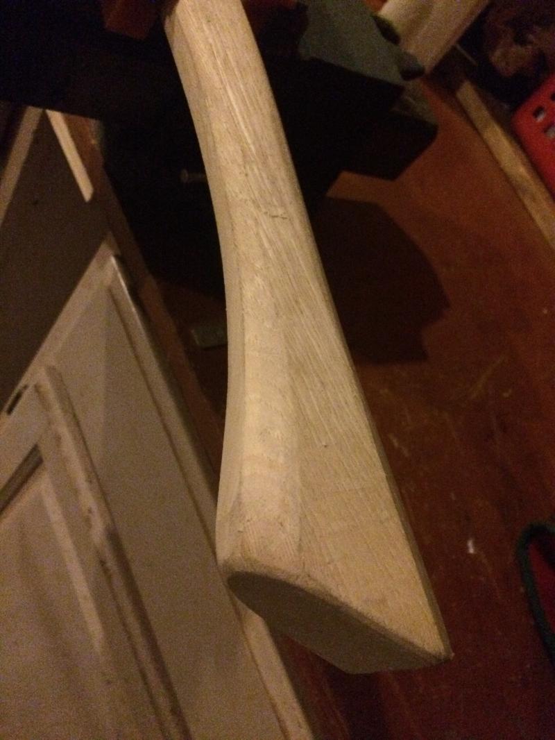

This is a head that has yet to be cleaned up but I set it there for reference. The handle is 36” and the kerf cut was only about an inch deep. Kind of think these were seconds that the store picked up cheap and was selling cheap. Haven't looked at grain orientation from the head down yet. The orientation at the swell-end is about 45 degrees. Didn't seem important as I'm not concerned to mess up a $4 handle as an experiment.
Wood-gurus - my spokeshave is sharp yet every 6" or so I have to reverse my approach to my draws. If not, it tears out the grain. Does this indicate that the grain is running-out? I mean, instead of staying the 45 degrees (which I assume would let me draw the shave for a longer span/entire handle), could it be dropping the grain every 6 "'s of handle just to pick up orientation again?
I prefer a little shorter handle for use but maybe I will change my mind.
Anyway, any input is appreciated. It’s still dark here but can get some better shots outside later if it helps with making a general assessment.

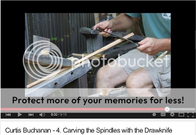

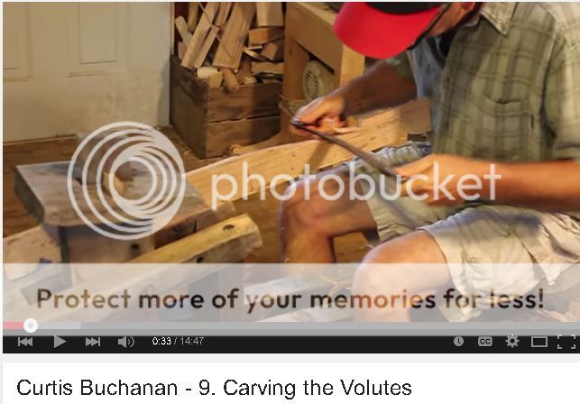

I posted a couple of videos yesterday here:
http://www.bladeforums.com/forums/showthread.php/1233816-COTS-Projecst-Thread/page6
Shows a lot about wood grain.
Here is a shot from the second video:
The grain in the piece runs straight along the length of the stock. He is cutting "down hill". Going the other way "up hill" risks getting the blade between the long fibers. This can cause tear out or worse dig in and split the piece.:eek:
He is using a draw knife but the I've seen this same advice for using edged tools in instructional books and videos for spokeshaves, planes (hand and powered), carving knives, etc. With that said, I have seen expert carvers cut "up hill".
If a piece of wood is just plain stubborn (funky grain) I would switch to rasps, files, sandpaper, or scrapers.

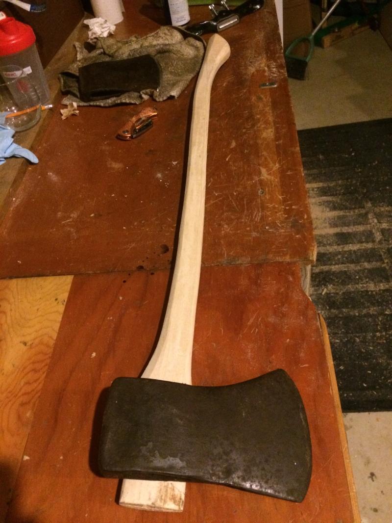

I’m thinking I’ll try that no-name head on it. It’s the largest one “in stock” that I have at the moment. Was 3 and ¾ lbs common? Only asking at it weighs 3lbs 10 5/8oz. It looks like someone already removed mushrooming and some bit from sharpening but how much steel would that equate to – to still leave that much over 3 and a half?

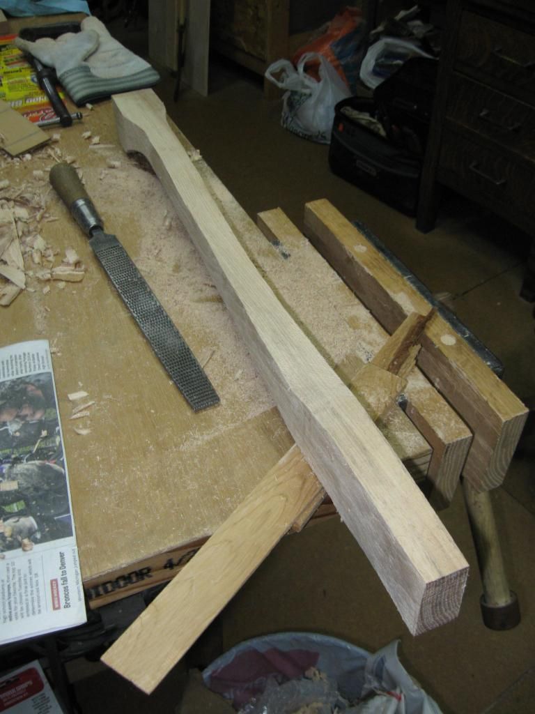

This is the start of my first hickory handle. I roughed it out with a band saw, then tried a chisel, draw knife, and rasp. I found I prefer the rasp.

Here in one of the videos I referenced, after he makes his spindle blanks square, he then makes them octagonal for the same reason.
He will finish the spindles with a spoke shave. Note that when he was making the blanks square he made sure the grain was dead straight.
