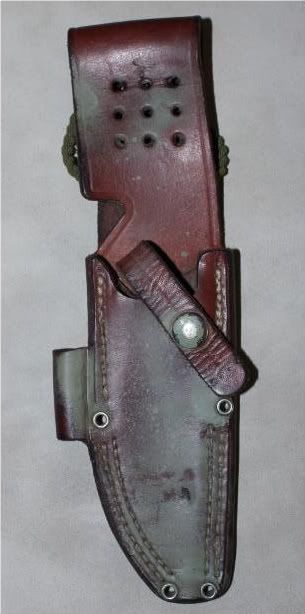

Hi,
short story, bought a Bravo 1 with a leather sheath thrown in for $10.00, previous owner spayed the sheath with paint.
Sooooo, how do you remove the paint safely while trying to protect the leather from damage ?
Tim
MMMM, Not sure if a solvent would muck up the leather or not but other than sanding I don't see any other way, acetone should work.You may have to dye it again.
Richard
Hi Richard,
maybe i should of just posted on the Aussie forum afterall.
Will try acetone.
Thanks mate .
Just tried it Richard, nail polish remover :)
Worked a treat.
Will put the sheath in the sun tommorrow and hit it with some leather care product i have .
