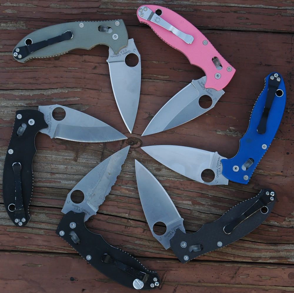

I have done at least six clips and have been carrying the knives for over a year and they are still in perfect shape. Sand or emery paper the clip to make it rough, one coat of spry primer, then a coat of black spray paint and then about six coats of spray lacquer. Let it dry for about two weeks and you cant smell the lacquer anymore, and you are done.

I used Brownell's baking laquer on some clips with good success, but I have also used black high temperature stove paint. Dull the clip well with sandpaper or a Scotchbrite, degreaser, spray then put it in the toaster oven for 30 minutes or so.
All of these were done one of these two methods (except for the pink one, of course):

also it seems that in the picture the spyderco imprint on the clip disappears after painting am I right?
