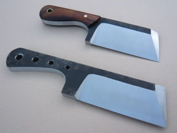

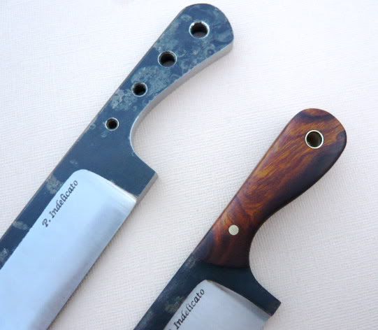

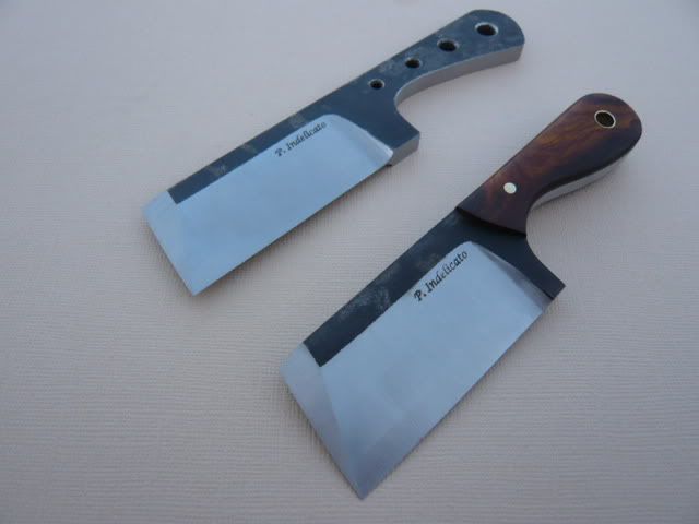

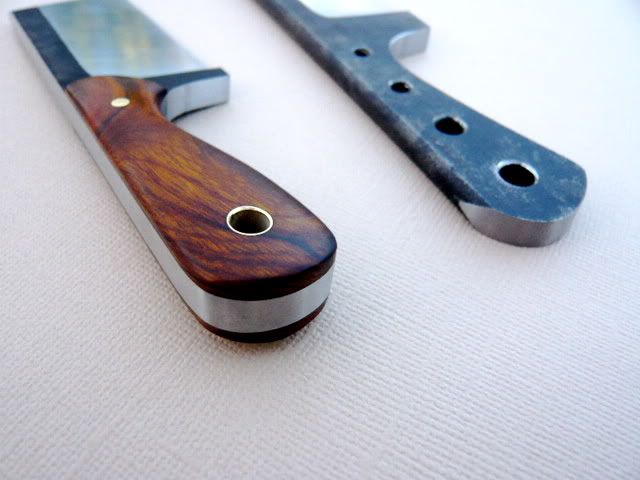

I did a couple of small fixed blade pocket knives like these for fun a while back as a change of pace, and I ended up having people wanting to order them, so here are two more that are almost finished.
These are flat ground from 1/4" 5160, and I left mill scale, heat treat coloration, and rounded mill edge for contrast to the finished surfaces. Scales are thin Desert Ironwood with brass pin and thong tube.
Approximate dimensions for the Ironwood version are 5 1/2" OAL with a 2 3/4" blade, and the skeletonized version is ~6" OAL with a 3" blade.
All comments are always welcome; thanks much for looking!
