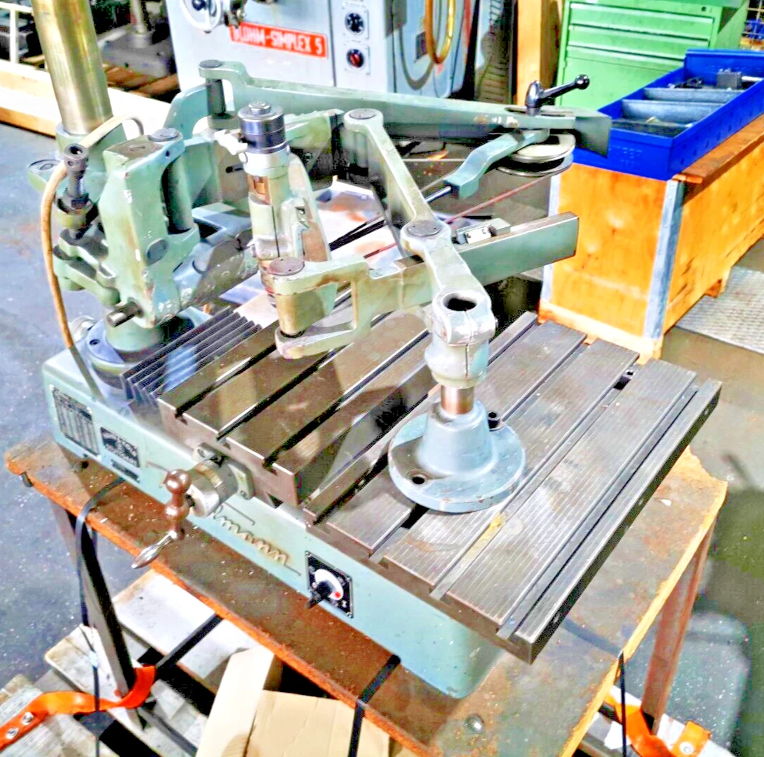

Kuhlmann made a table model. I don't know if you have them in the states
