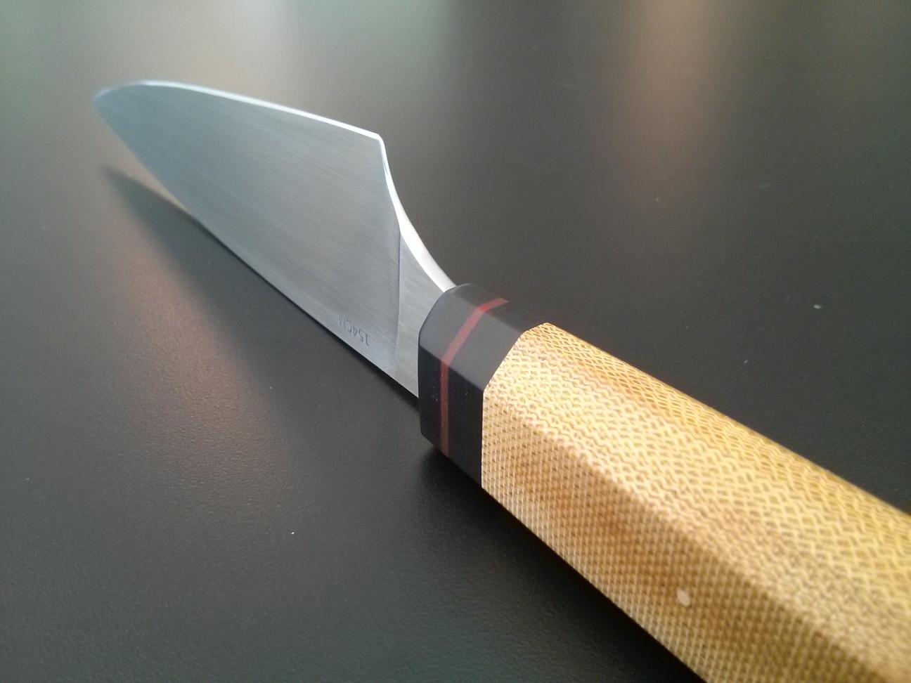

Salem's description is why I prefer G10 for bolsters. sanding down a swollen handle to match the bolster is easier than cleaning up a bolster that may have grown in many directions, including toward the blade and at the ricasso. And G10 obviously won't tarnish like brass either. The bolster seems to take the brunt of moisture from use and washing. Then the rest of the handle could be whatever you want, and less likely to grow in a troublesome way. Of course for slab scales, this might be more trouble.
This one is a 3-layer G10 bolster with canvas micarta for the rest:
