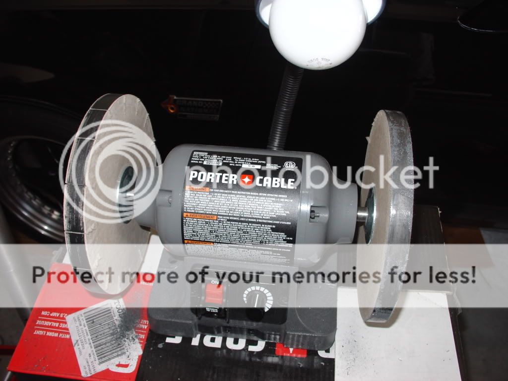

Month or so back, I spoke with Richard J breifly in PM's here on the forums about paper wheel sharpening. Took his advise and gave them a shot. Took me 2 attempts on my beater CS Lawman and I pretty much had the technique down. Edges would slice paper like nothing and shave hair off my arm. I was able to get all of these knives sharper than the factory edge easily.
I do think there is room for improvement though, thinking I just need to play with the angles a little more. Richard, if you read this, maybe you can throw a few tips at me :thumbup:. The paper wheels are the real deal and will put a polished edge on your knife in minutes, if not faster. I was confident enough after sharpening my Lawman to hit these four on the wheels and they came out sharper than the factory edges. A Scrapper 6, SR RMD, SR Rodent Solution, and one of my EDC's, Spyderco Superleaf. Needless to say, I am very impressed with the wheels and anyone on the fence about these, do not hesitate.
Tried to snap a few pics to capture the edges, hopefully they come out ok. Thanks again Richard :D

Thrill,
Here is a picture of my setup. Bought the grinder at Lowe's hardware, it a variable speed grinder, about $65 I think. Bought the wheels from my local Woodcraft store. Think you can go to Woodcraft.com and see if there is a location near you. The system is called "Razor Sharp Edgemaking". Think you can get the wheels, wax, rouge all for around $50. So I have little under $120 in the whole setup.

I have pretty much the same setup as Bapple's except I use a 6" buffer that I got from Harbor freight. I use the 8" wheels.
I turned the base of the buffer around so that the wheels spin away from me.
