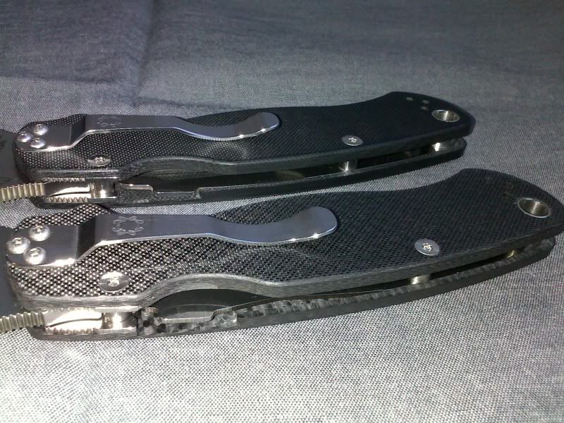

I've noticed some improvments on my Para2 sprint versus the regular version:
- the tab which allows unlocking has been moved a little bit further
- the liner leaf has a cutout, while on the regular model it follows the contour of the spine
while the first one seems to enhance leveradge, I am not sure I understand the second one; maybe the leaf becomes 'more springy'? I can feel that my Para2 sprint locks with more authority than regular G10 version
anyway, great job
I know Spyderco is aiming at Constant Quality Improvment but I didn't expect it on a 3-months old model :)

The G10 Para2 has been out for at least six months. There must have been some reengineering that was necessary before more were released. Why else would you have a six month production delay on the most highly anticipated new/revised model in years?
I could be completely crossing channels in my memory, but didn't someone like Sal post, some while back, that the reason for the production hiatus on the regular version was because they were making changes? The changes first would appear in the CF/S90V sprint and then be rolled into regular production? I could be totally mis-remembering...
That could be right? Where's the scratching head smilie?
I also remember people bringing that up and being told, "No, it's just because there is no production capacity right now."
anyway, great job
Good eye! Would have never noticed! Just looked/compared - Looks like a substantial tooling change for them.
