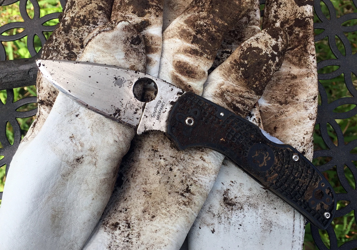

Don't let one picture make you miss out on a knife steel in a class of its own, which may disappear and its kind never be seen again, due to influence of opinions like yours.
I use mine moderately all the time. Most here call it abusive. The blade is extremely hard and will chip with enough force, but less so than a couple of more popular steels on this forum, one closely related to one you mentioned... my 1st hand experience.
Here's another picture. It proves nothing other than dirty and intact, you'll just have to take my word for the way it's used.
