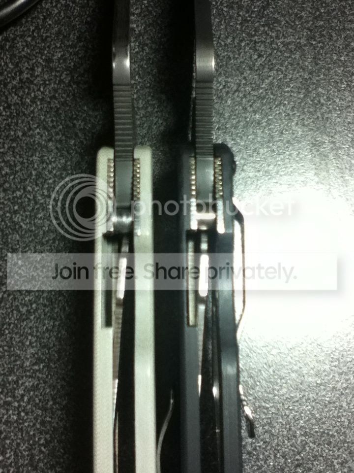

The one on the left has been used really hard, even abused(not by me), the one on the left is my regular edc. I don`t baby my knives, but I don`t usually abuse them. The lock wears on the blade tang, creating a burr, and that burr, and some other factors, is what makes the lock sticky. I`m not gonna say I`m the end all expert for Para 2s, but I`ve talked to sal and others at Spyderco about the lock and the mechanics of the knife, since this is something that interests me a lot. Side to side is unusual, but minimal play is normal, up and down due to the wear of the lock, and removing of the burr on the lock is to be expected. The left knife locks up solid, and the blade play of the left one doesn`t affect the performance, or the strengh of the lock.
Its not my pic, and its an original gen para, but it should get plastered all over the knife forums until everyone with a comp lock gets why blade play doesn't much matter with this lock design. But the para2 play is mostly due to the pivot bushing.
