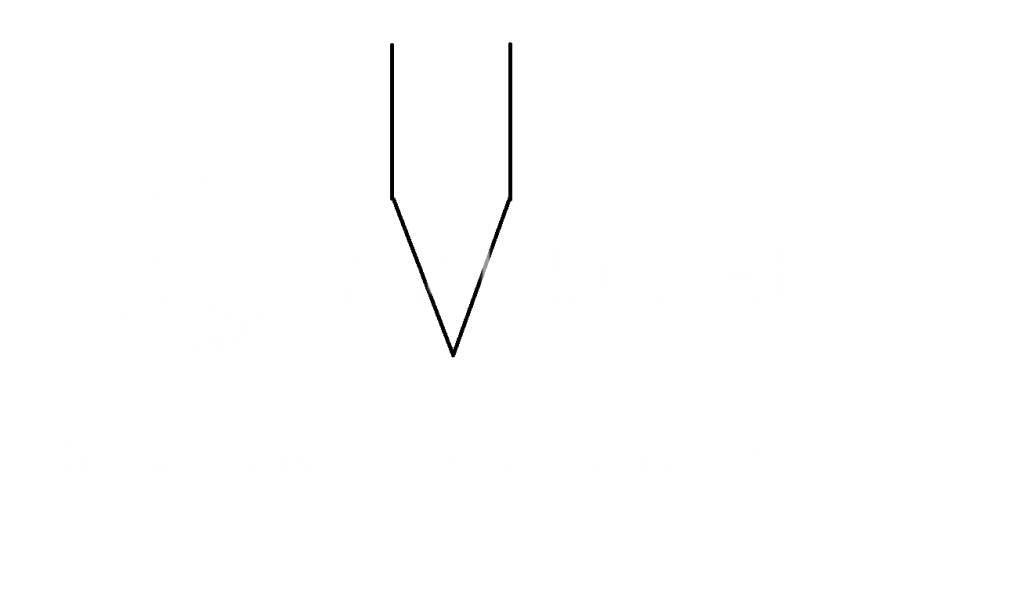

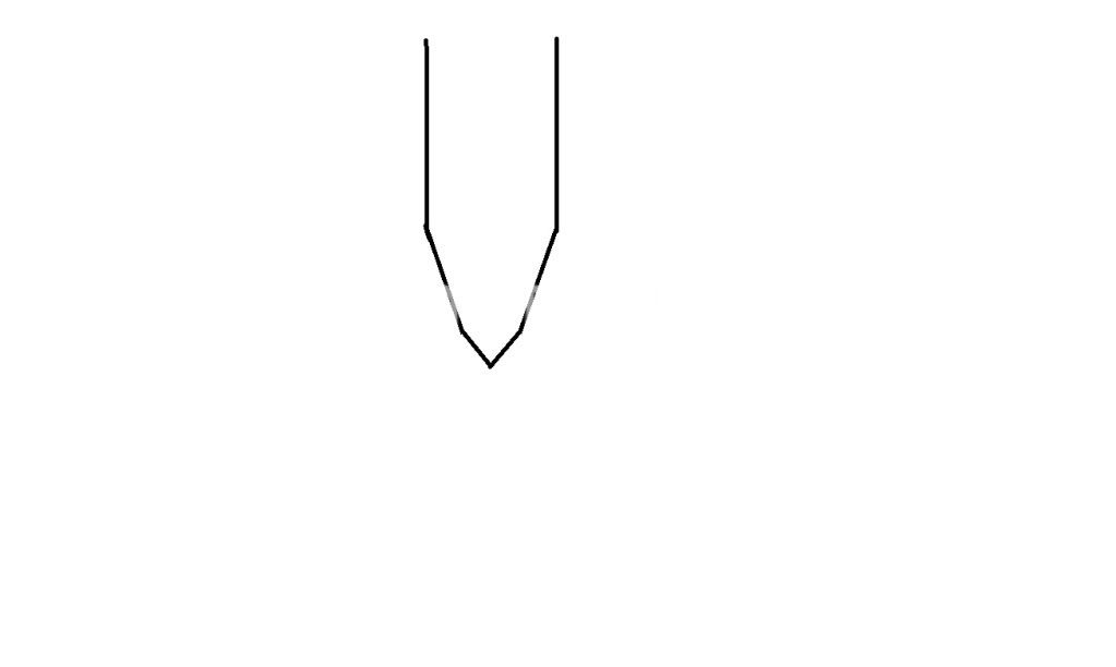

Would someone please explain what a micro bevel is? Don't all knives come with them?
On a knife you have your primary grind: flat grind, hollow grind, convex grind ect. Then you have your primary bevel or main edge. If you put on a micro bevel or secondary edge it is at an angle which is larger than your primary.
Edge with a micro bevel:
Edge without:
Your terminology is a bit off. The primary grind IS the primary bevel, a bevel being cut or ground away from flat. All subsequent grinds or bevels proceed from there to the edge: secondary, tertiary, quaternary, etc. Each time the grind angle or trend changes, a new bevel has been added. A "micro"-bevel is a grind of such minute width it is difficult to see, such as would be accomplished by a single stroke along a hone at a higher angle. Most knives possess a very acute primary bevel (or grind) and a slightly more obtuse secondary (or "edge") bevel that extends to the apex. On many "Scandi"-ground knives, this secondary bevel is so miniscule it is called a "micro-bevel".
On the OP's knife, it sounds like his Para2 was sharpened (on the secondary bevel) to 15 dps (30 inclusive), but after dulling, rather than resharpening to this same angle (which takes more time and metal removal), he simply increased the sharpening angle to 20 dps (40 inclusive) for a few passes and achieved the edge he needed. The result was a knife with three grinds - primary, secondary (15 dps), and tertiary (20 dps) micro-bevel at the edge.
Yah I was having a brain fart with my terminology ;). Thanks for explaining it though. I was trying to remember the terms, but couldn't find anything to jog my memory.

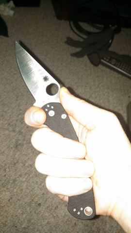

lutejones....I couldn't help but notice you didn't post a picture using the thumb ramp+jimping for your thumb? Is this what you call "hammer grip"? I am usually using the grip pictured below when I use my PM2..
Cheers
Well, blade to handle ratio or whatever you wanna complain about. I've had more PM2's that any other knife. Must have had
15 at one time in s90v, CTS-XHP, CTS-20CP, D2, M390 and a few I forget about. I loved them all. Only have a few "lessers" remaining, and those I'll keep. I have one 20CP that's a favorite, and an all-black in S30v that's a kick-around knife. But the folks who talk about all these ratios are just trying to find an excuse to NOT buy one and try it out. A wonderful folder, and the compression lock kicks butt. Just don't cut off your finger-tips playing with it.
Hey T.L. You've noticed it. I don't really like using the thumb ramp is kind of awkward to me since I learn how to use a knife without it. So, feels uncomfortable. Instead I put my thumb on the side, on the pivot screw.
What I call hammer grip is pretty obvious if you think in the way you would handle a hammer.
Mateo
