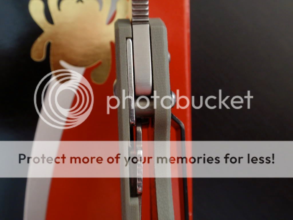

Just got a user para in a trade and was wondering if some issues are normal.
1. There is very in handle detent to speak of, to the point where I would never carry the knife tip up even if it were possible.
2. The compression lock feels rather feeble. This is the first example of the lock I've ever handled and it definitely doesn't have the authoritative snap as lock backs and liner locks. Do compression locks wear like liner locks do? Mine moves over about 75-80%. There is a tiny bit of blade play vertically and horizontally.
3. The pivot isn't adjustable because it's not pinned on the other side. Why would they do this? Am I supposed to buy two sets of torx screws :confused: The blade is centered - I just want to tighten the pivot for some more detention.

Do you have a pic of the lock issue at all?

Interesting, does anyone have a picture of the para's engaged lock viewed from above?

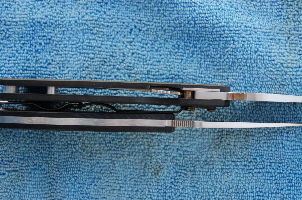

Here's a shot I had laying around the harddrive.
Thanks yablanowitz. The lock bar on my example does indeed move over about 2mm more than the one pictured.
Edit: Btw, is that photo of a new para? I ask because there appears to be some rust on the stop pin and liner.
No, that one is far from new. It has been used hard and put away wet more than once. My work knives lead hard lives.

Here's another shot of the compression lock for comparison. I don't use this knife very often - If I had to guess how many times it's been opened and closed I'd say 300-450 (ball park guess :o)
