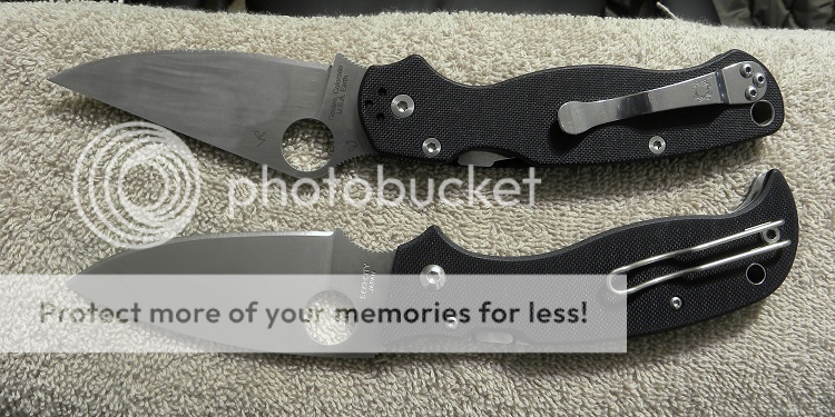

So I looked around and found the SuperLeaf. VG10, Wire clip, mostly the same design. No brainer. So after I got it, I tested both out again, and here is my comparison for those wondering which one is the better buy. Note to all: I paid $109 for the PM2 and $106 for the SuperLeaf, I view this as the same price respectively.

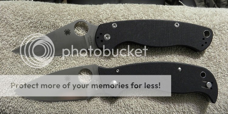

For starters the blade steel: PM2 has S30V, SuperLeaf VG10. I love VG10, it's my favorite steel to work with, in my experience it gets sharper, and can be sharpened easier. Anyone who wants to get a knife with S30V should seriously consider a diamond sharpener of one sort or another.

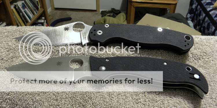

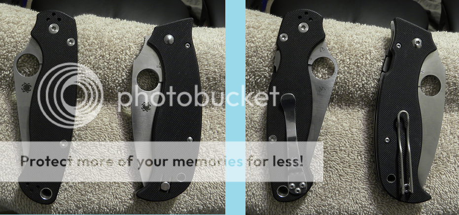

Notice that screw on the upper left of the SuperLeaf...... It bothers me. There are two round pins, and one flat one. That screw just doesn't fit. They should have done 3 round pins and one flat one. The PM2 on the other hand has symmetry all over.
Do you see how big that choil is on the SuperLeaf. It feels far superior than the PM2. I will give credit to the PM2 for sharper gimping. I would definitely choose the bigger choil for my fat fingers, but the sharper gimping is missed.(for the record, I do use the choil all the time).
The Gimping on the back of the SuperLeaf is sunk into the handle. They really should have either raised it a hair, or Gimp the Liners like they did with the PM2. I'll call it equal, I love how big and roomy the SuperLeaf is, but I wouldn't find fault with anyone who liked the sharper PM2.
I love those steel liners on the SuperLeaf. If you wanted a generally beefier knife, then this one fits the bill.

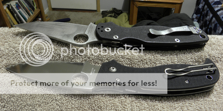

And of course the wire clip is great. The retention on that wire clip is a bit stronger than the one on the PM2. One other big plus for me is that lock.......... For those who don't know, when you close the PM2 you get a little bump on the tip of your finger, it's the choil sticking out a little too far. The SuperLeaf doesn't have that issue, the choil doesn't bump your finger every time you close it.

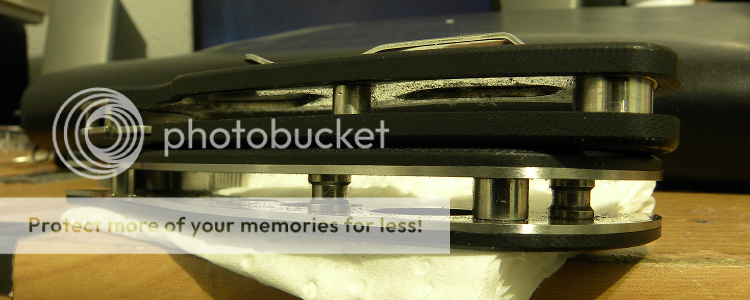

Another of my small gripes with the SuperLeaf is the inconsistent pillars. I like those two that dip in the middle. But there are only two, why two? It doesn't make since to me. At least make that third one in the back the same, then you could make the lanyard hole straight and keep the theme of making everything the same and the Lanyard hole pillar different. The PM2 however stayed symmetrical with all 3 pillars.

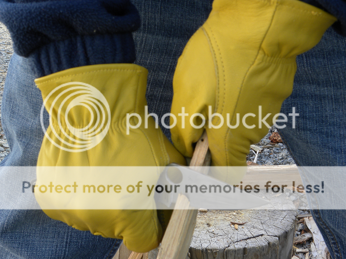

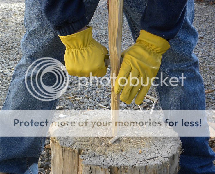

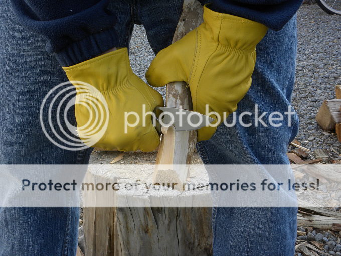

Next is wood working. I tested 3 things..... Splitting, shaving, and the tip. Note I don't chop with folding blades, but the SuperLeaf one, but again, I just don't believe it is something you do with folding blades.
The PM2 sucked to push on the back of to increase the ease of splitting. Every time I did so I was met with that sharp tip.

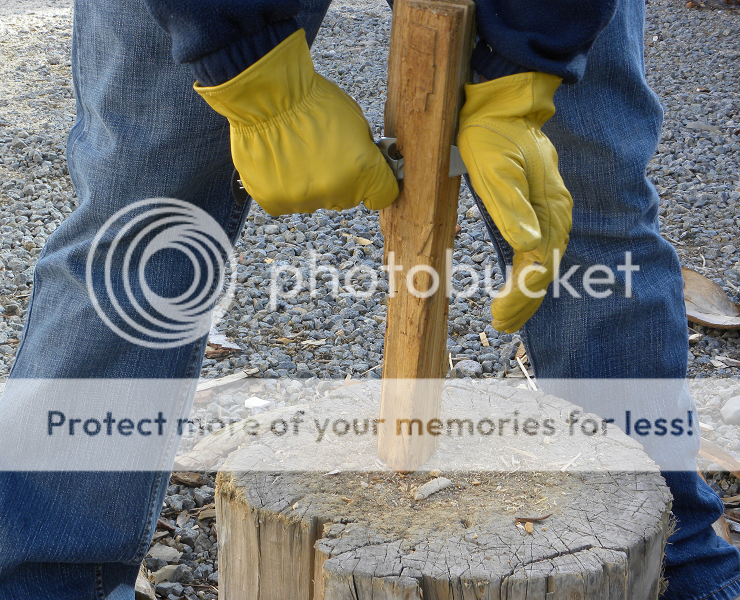

The end of the blade on the SuperLeaf is thicker than the PM2 making it easier to use your hand on the back of it to push your blade through for splitting.
The back of the handle is also sharper on the PM2 making it yet again a little more of a chore to work wood with.
The alternate pic with the SuperLeaf below. Much less stress on the back of the hand.

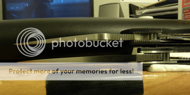

The tip test was fun. In terms of stabbing the PM2 won hands down. But................
As we can see the added stabbing power comes at a cost. The SuperLeaf however came out unscathed.
