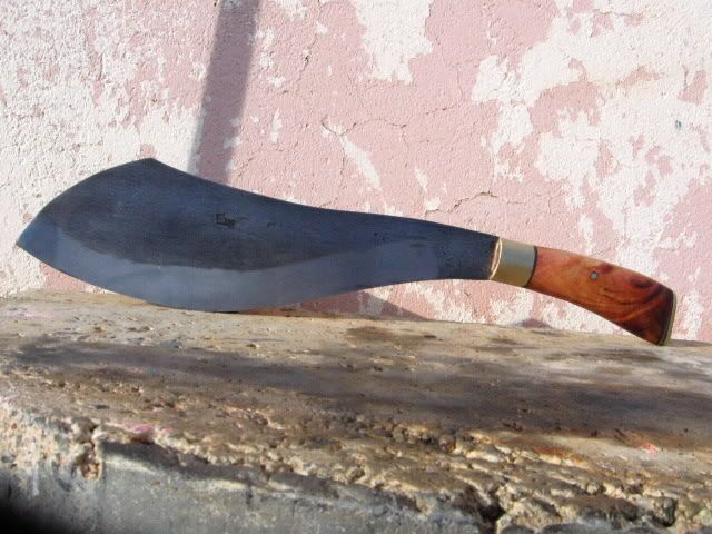

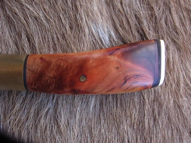

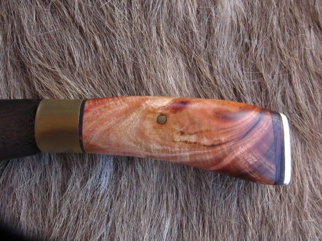

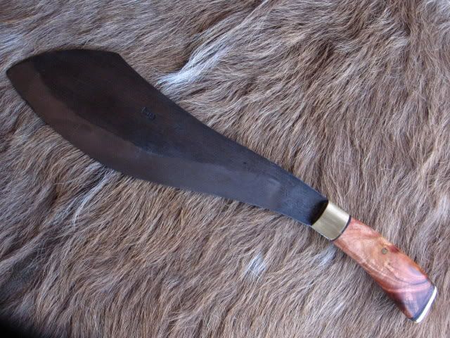

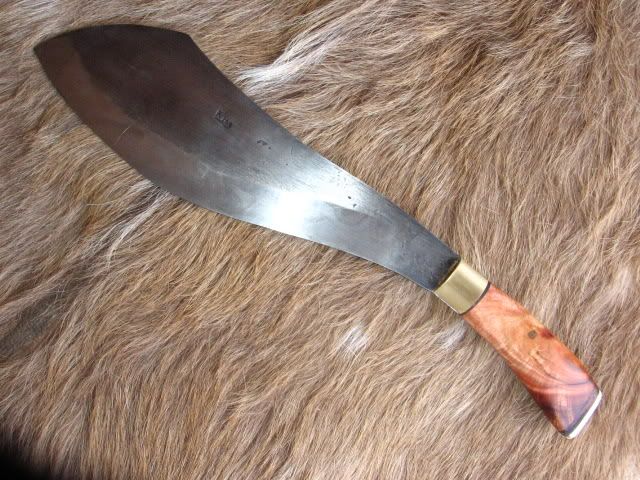

This one is posted here for Pipeman. It is the first ever Parang I made, the blade is from an old circular saw blade so probably M2 or L6 or some such, 4.5mm thick and tempered back to about spring steel. Construction is traditional - i.e tang through the handle and riveted at the back. Handle is Common Taaibos (Rhus pyroides) burl that I got from a friend - amazing wood - this particular stump has been laying in the veldt for 30 years - and nothing has eaten it yet!! There is also a couple of leather spacers and a sliver of Purple Heart just in front of the brass buttplate,
Thanks for looking

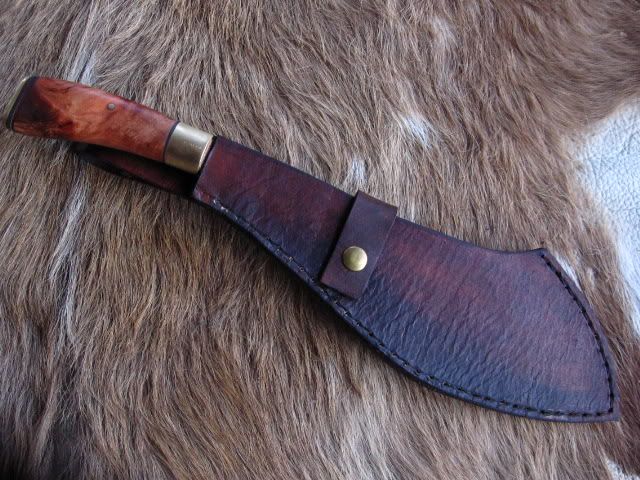

That is one mean looking piece of metal. Very nice work on putting it together, looks great. Nice sheath also.....
