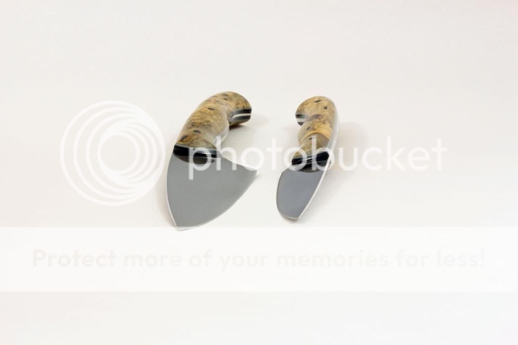

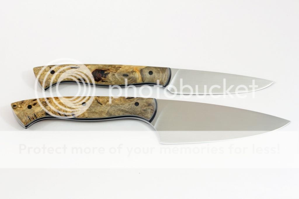

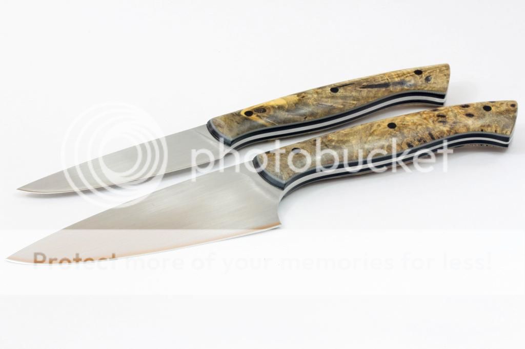

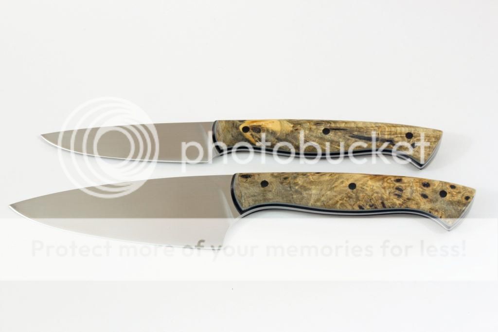

These are both ridiculous slicing machines with THIN edges. They both cut like a laser.
Specs:
Both double cryo'ed and triple tempered to a tested 62 hrc.
Stabilized Buckeye Burl over black and grey G10 with carbon fiber pins.
Satin 400 grit hand finish.
Paring knife is full tang 1/16" AEB-L, and is 7.2" tip to butt with 3.1" of usable cutting edge. Ground to a very thin tip for all the fine work that parers are good for.
Petty is .09" AEB-L with a tang that's been tapered down to .035" leaving the neutral balance point at the front finger. 8.3" over all length with 4" usable cutting edge.
Both sold
Thanks for looking everyone!
