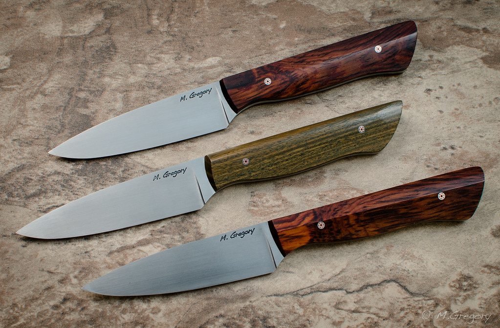

I don't have a good paring knife in the house.
Yeah, I know... a knifemaker is supposed to have great knives laying everywhere. I suspect if you asked MOST guys, they'd either be embarrassed to tell you they have crummy kitchen cutlery or they're still using the crummy knives they were given as wedding gifts, or bought at the grocery store, or who knows where else. The same holds true for me. I'm always meaning to get around to it.
Well, I finally did.
These are 1095 steel, fully distal tapered and ground to just about .002" right behind the edge. The handles are cocobolo for the top and bottom, and lignum vitae for the middle (I took this photo a scant hour after finishing the handles, so it kind of looks like the lignum vitae was rubbed on a freshly mowed lawn - eww! It's a strange wood, but immensely tough. Over time it will mellow and develop some real character!
The cross section of each of the handles is roughly diamond shaped, although it's hard to tell from the photo. Each handle was done just a pinch differently, with varying levels of beveling. It's a point of contention in the house - I prefer the hard, sharp look of the bottom knife, but she like the slightly softened edges of the top one. The lignum vitae version has the bevels fully smoothed in, and a slightly different shape to the butt. They all feel great in the hand, so it really comes down to the preference of the individual, I guess. The mosaic pins are something I NEVER use. I bought this pin stock from Koval Knives I think, so it's got to be eight or ten years old. Just felt right on these.
All thoughts and comments welcome!

These are super slick Mathew! :thumbup: I like the variations of the handle shape and the facets look (and I bet feel) very nice. The edges look nice and usable all the way to the heel. I bet they are real slicers!

Beautiful and very fit for function, doesn't get much better than that.
Cocobolo is one of my favorite handle woods, so particularly fond of one and three.

I personally don't like carbon steel for kitchen knives, mostly too reactive. Everyone has their own preference.

Paulie, that's funny as hell!!! What's REALLY funny is that they all start out with the sharp bevels - otherwise I can't keep them symmetrical - and I work them smooth afterward. Softened the cocobolo handle on top by hand, and did the lignum vitae on the platen on the grinder. That stuff is just plain brutal to work by hand. Tough stuff!!!!

STeven, I tend to agree with you, btw. I have a handful of these waiting for heat treat in Sandvik 13C26 (aka AEB-L). 1095 can get properly thermal cycled and heat treated by me in-house, and I don't have a liquid nitrogen dewar yet, so no go on the more complex stuff. Soon, perhaps!
