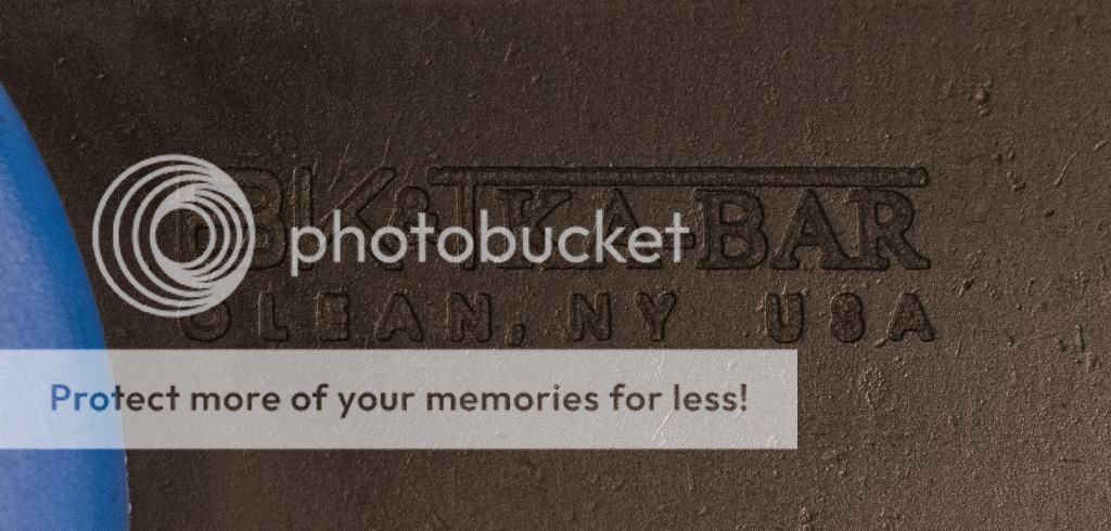

So yea been playing around with Parkerizing. Can do the Black Manganese Phosphate coating as well as the Grey Oxide. Haven't done the grey yet yet though.
Will be doing some tests to see how it holds up under heavy use, but from what I have seen so far, it does really well.
So I finally have the equipment I needed and now I can electro etch the logos really deep, Strip the coating, Blast the metal, then Park it to perfection!
Impact sockets are parkerised. If you have those it will give you an idea of how well it holds up. I can tell you if you don't keep it oiled, or waxed, it WILL rust. The black phosphate, or black oxide coating is a form of etching. The surface just holds oils, and waxes better. It's not a way to deter rust on its own.
STILL... IT IS AWESOME AND MY FAVORITE!!!!
Ding Ding Ding! We have a winner!
