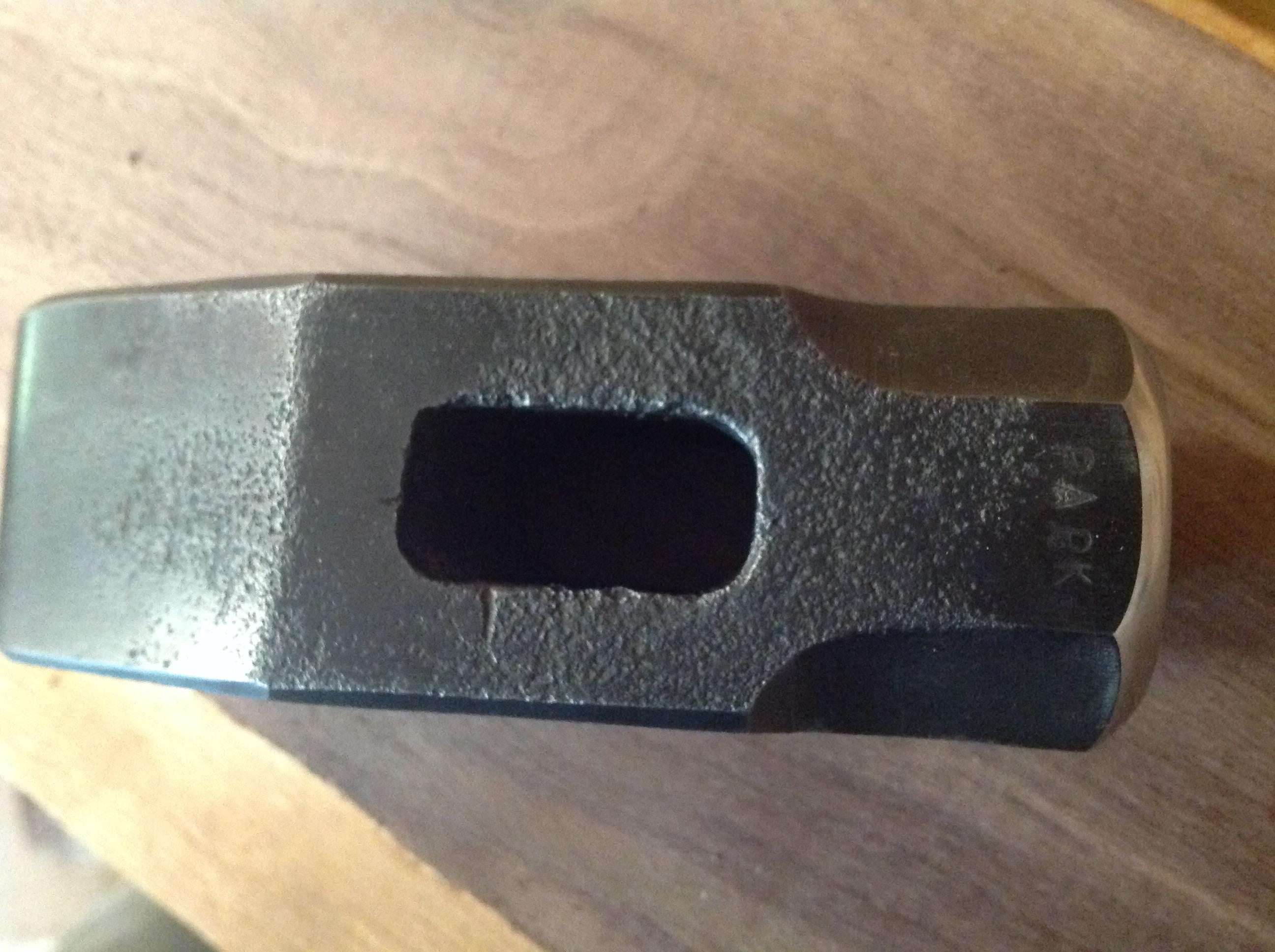

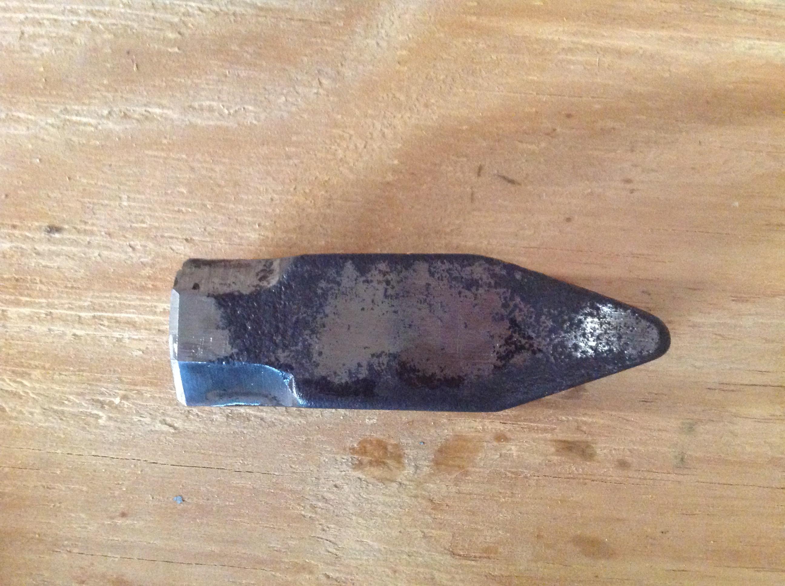

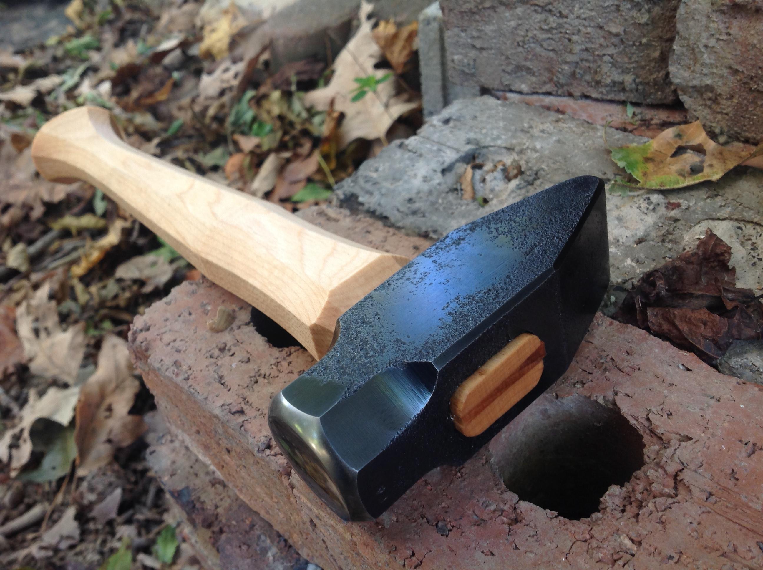

I got the bug after going through the sledge hammer thread... I need an engineer's hammer / cross peen, and the stuff at the hardware stores is pretty much trash. I'd have to actually remove the handle to do the work making it a usable tool to my liking, so it was less work to find a really beat up head and start from there. My restoration standards are a bit different than what I usually see on here. I like to grind things back to straight and even, probably more straight and even than they were factory, it's just what I like to do to create the tools I want to own and use, since it's hard to buy tools in that condition anywhere. I rarely use a wire brush or vinegar soak.

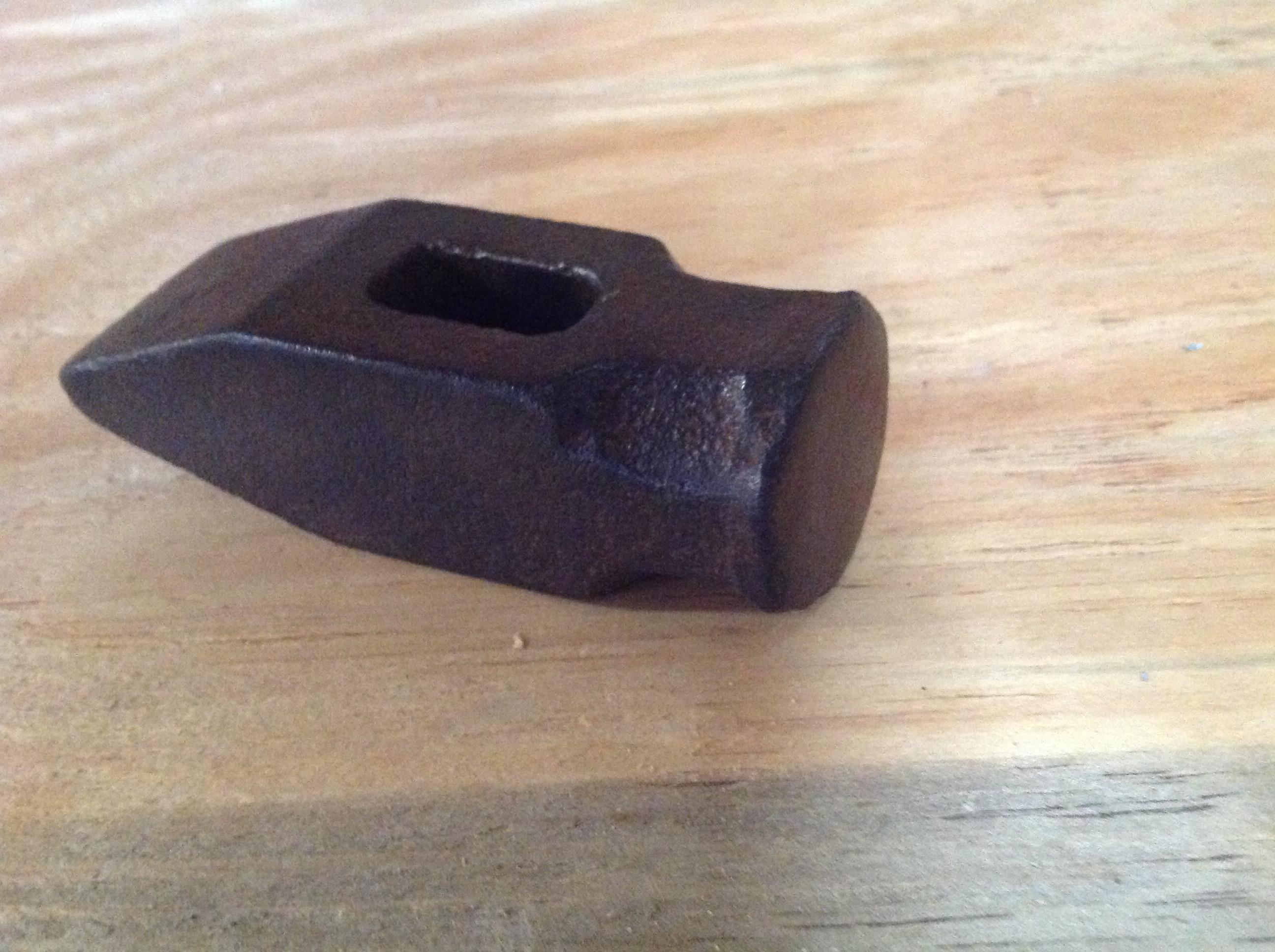

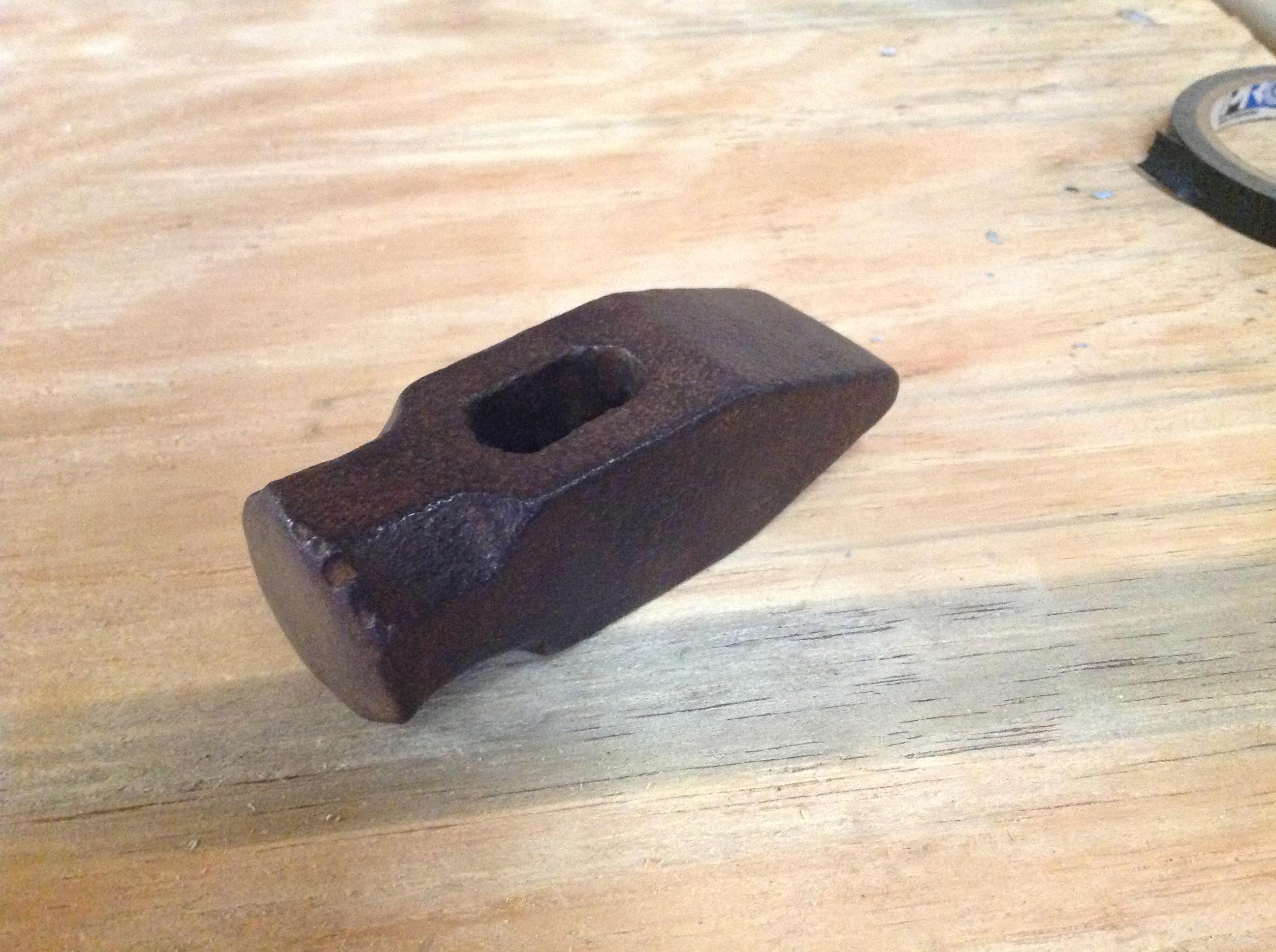

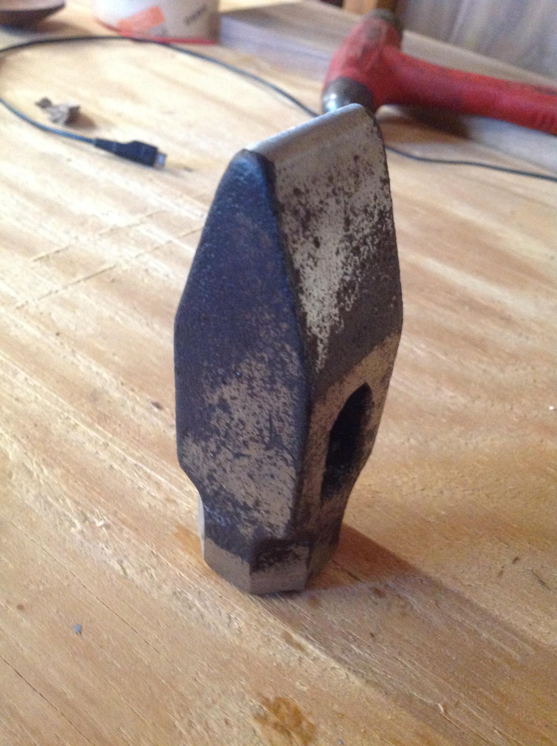

So, I started with an unmarked (or so rusted the marks are gone) hammer head from the bay. 2.99 plus shipping, bidding on something no one else wants to mess with is satisfying, and after shipping I'm still at ten bucks cheaper than the junk from the box stores.

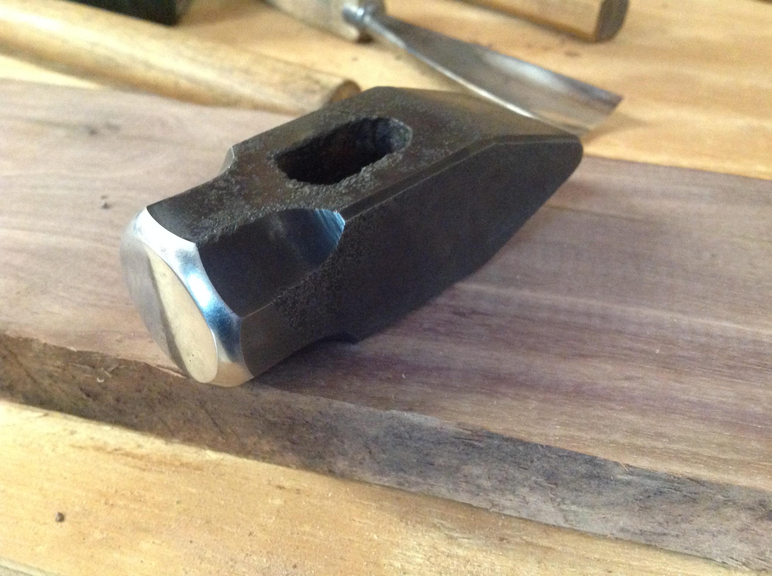

Mushrooming is pretty bad, there is some very uneven wear on the striking face, and some chips on both ends.
I started on the belt grinder at 60 grit flattening and evening, then going into the bevels.
I went from 60 grit up to 150. With some help from the spindle sander I got into the end of those bevels and evened them out. After chamfering the rest of the edges, I did a rough garnet blast all over, followed by three coats of gun blue with 0000 steel wool in between and barricade penetrating oil.

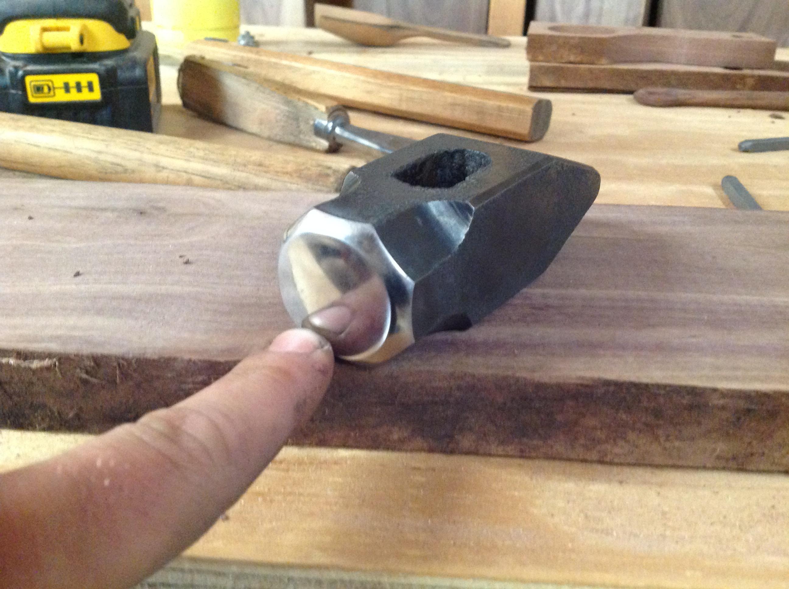

For polishing hammer faces to "good enough" I have a cheat method. Clamp my five inch random orbital upside-down in a vise and go from 220 to 320. When the grit stops cutting with the 320, it starts polishing. It's not a mirror finish, but it's perfect for a hammer IMO and takes 2 minutes with no buffing.
Added a ghetto stamp

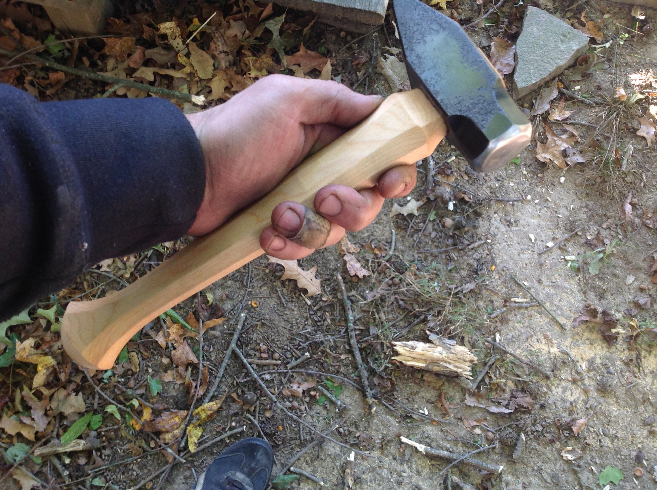

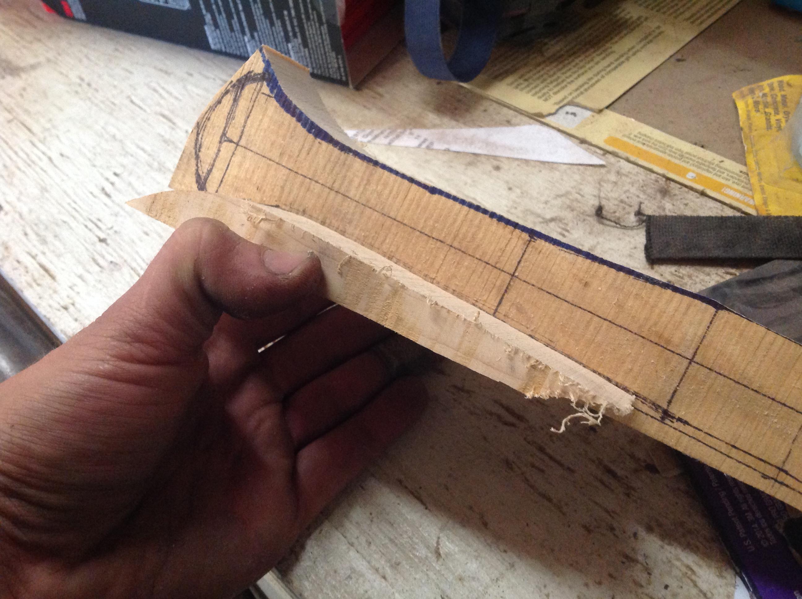

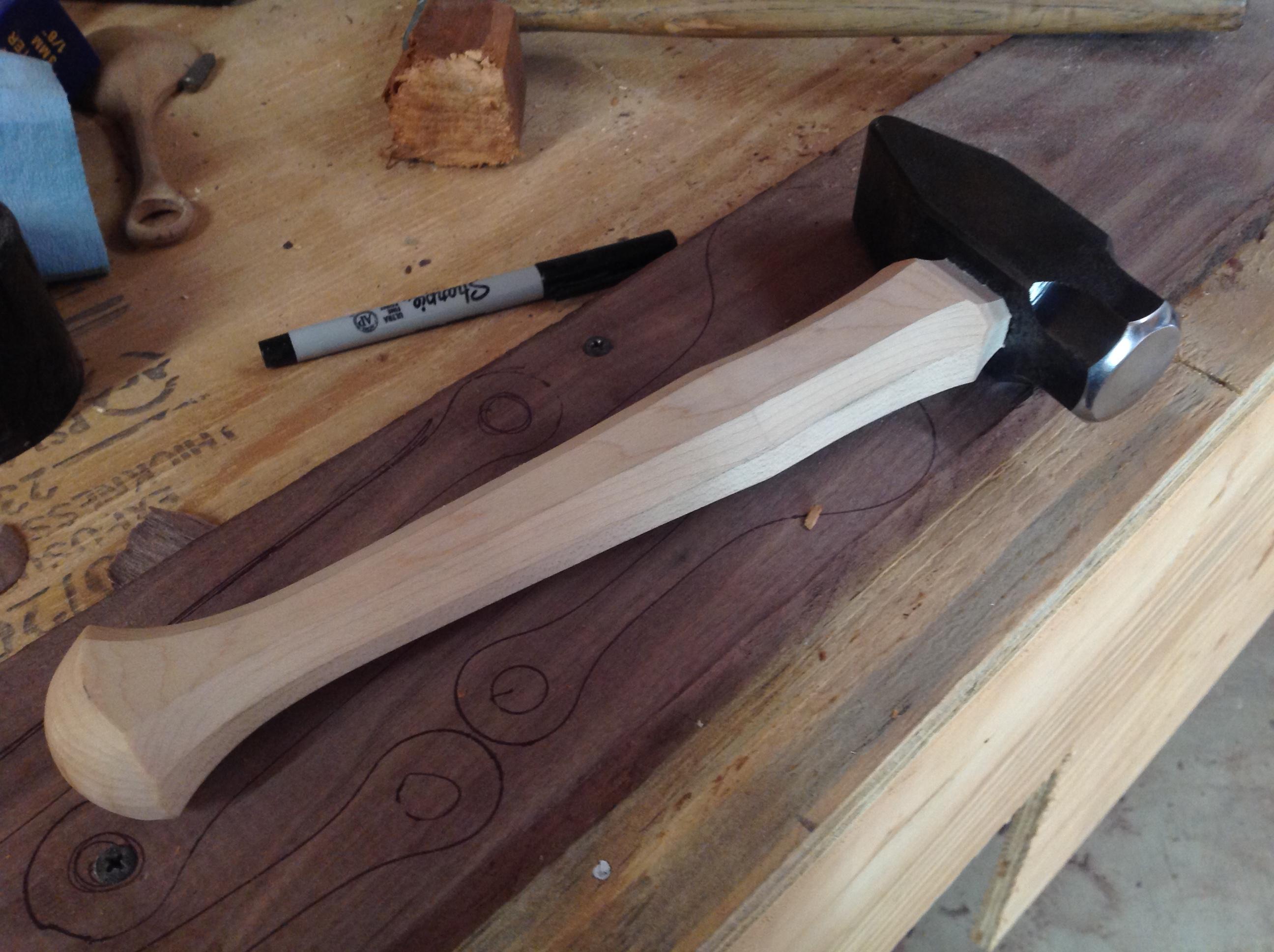

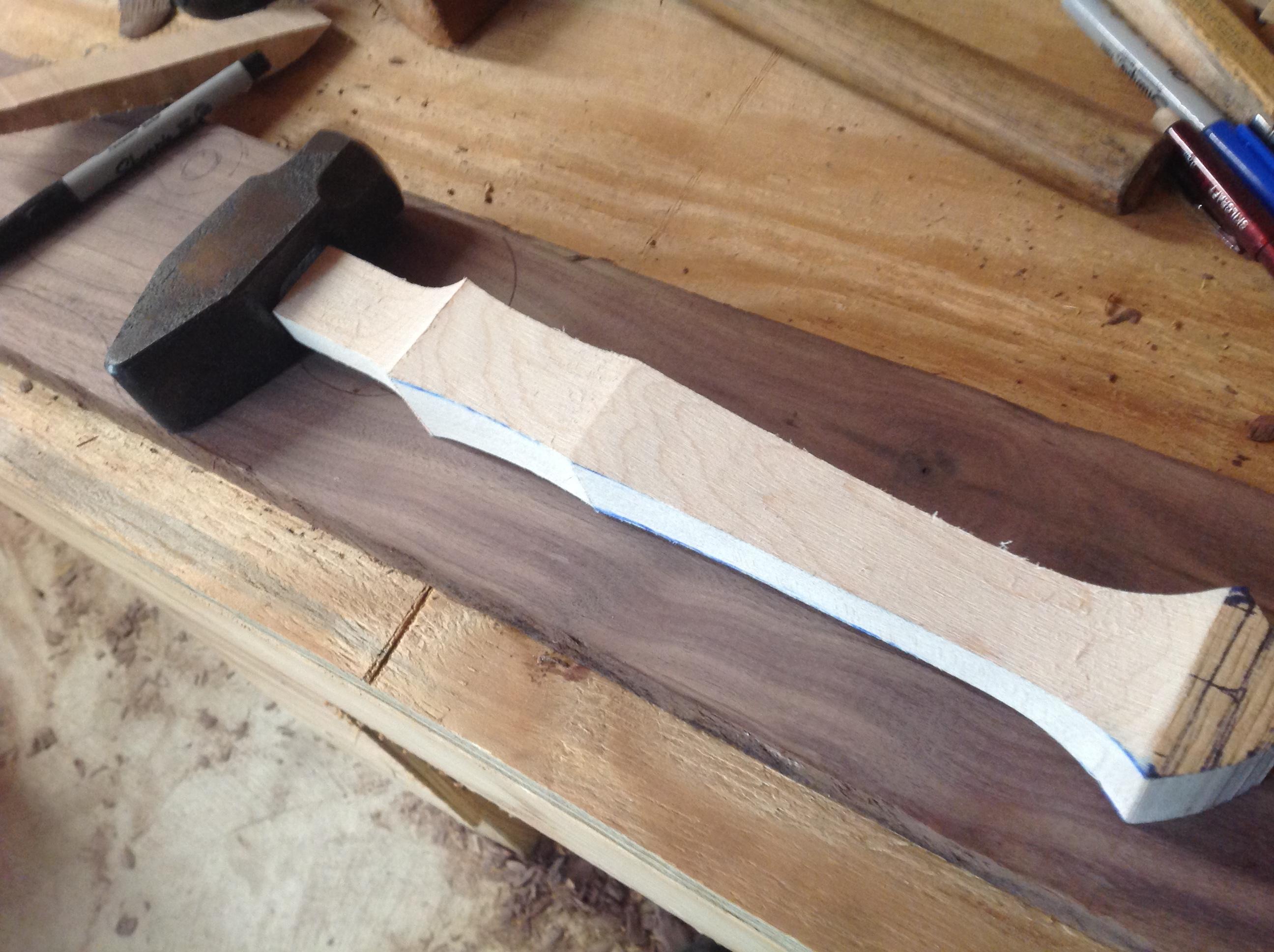

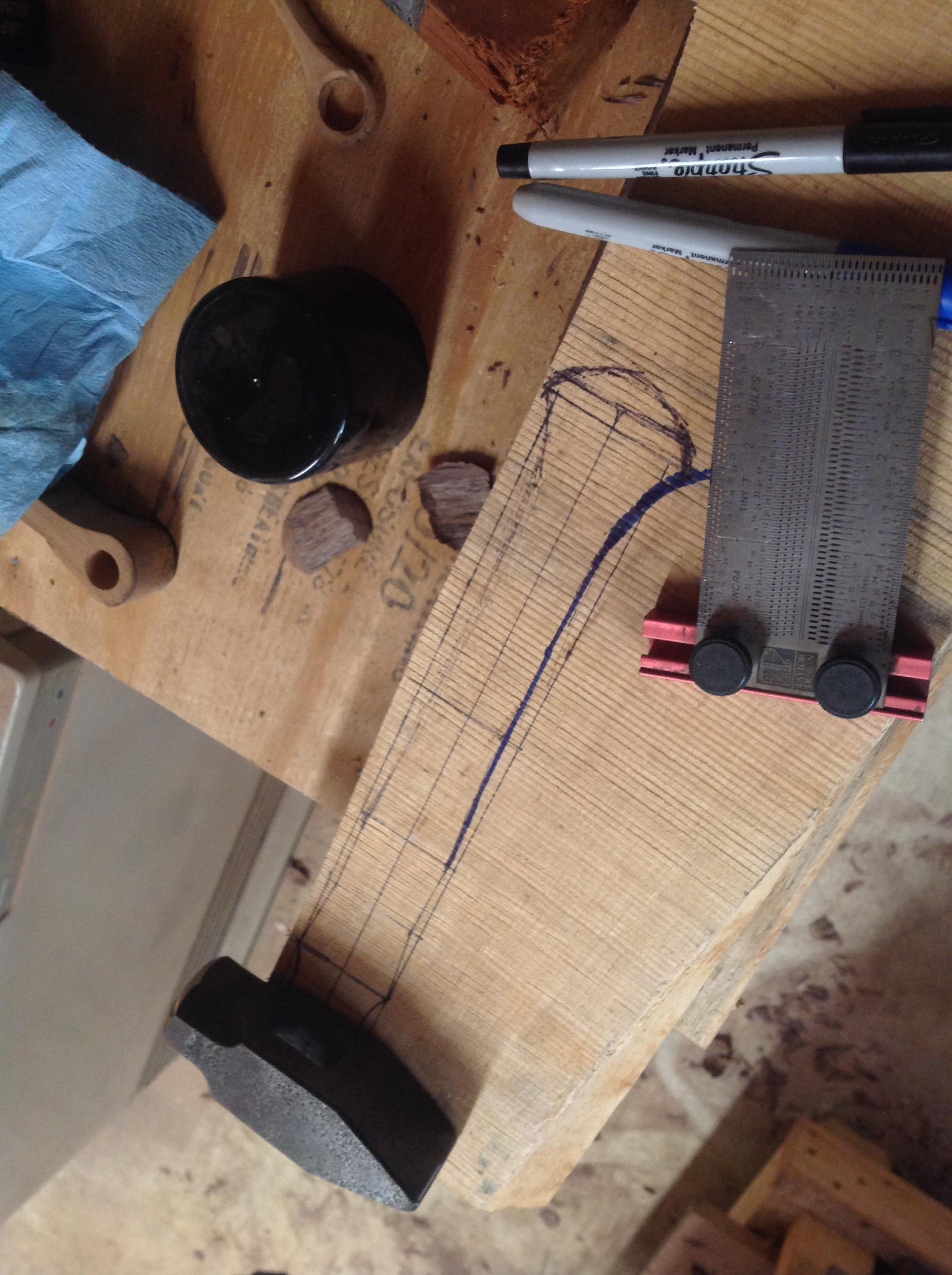

Sketched out a profile on a scrap piece of 5/4 sugar maple. I'll use the full thickness for the shoulders and the swell.
I use the cutoff to mark my opposite cut, works better than trying to eye it.
Cut out both profiles on the bandsaw.

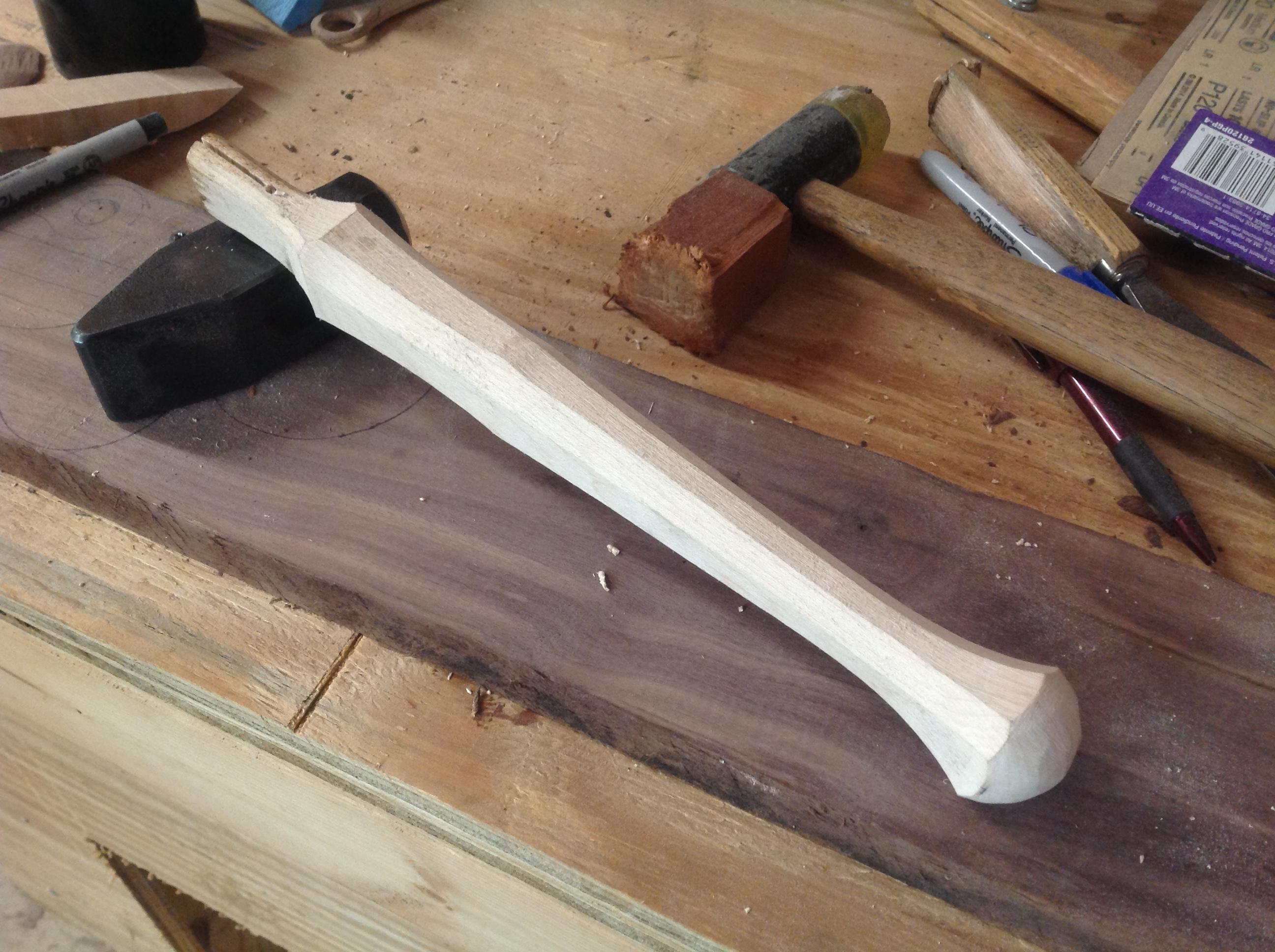

Rough profiled on the belt sander's 3" wheel with 60 grit. Kerf drilled and sawn.
Wedged with birch
Oiled and finished

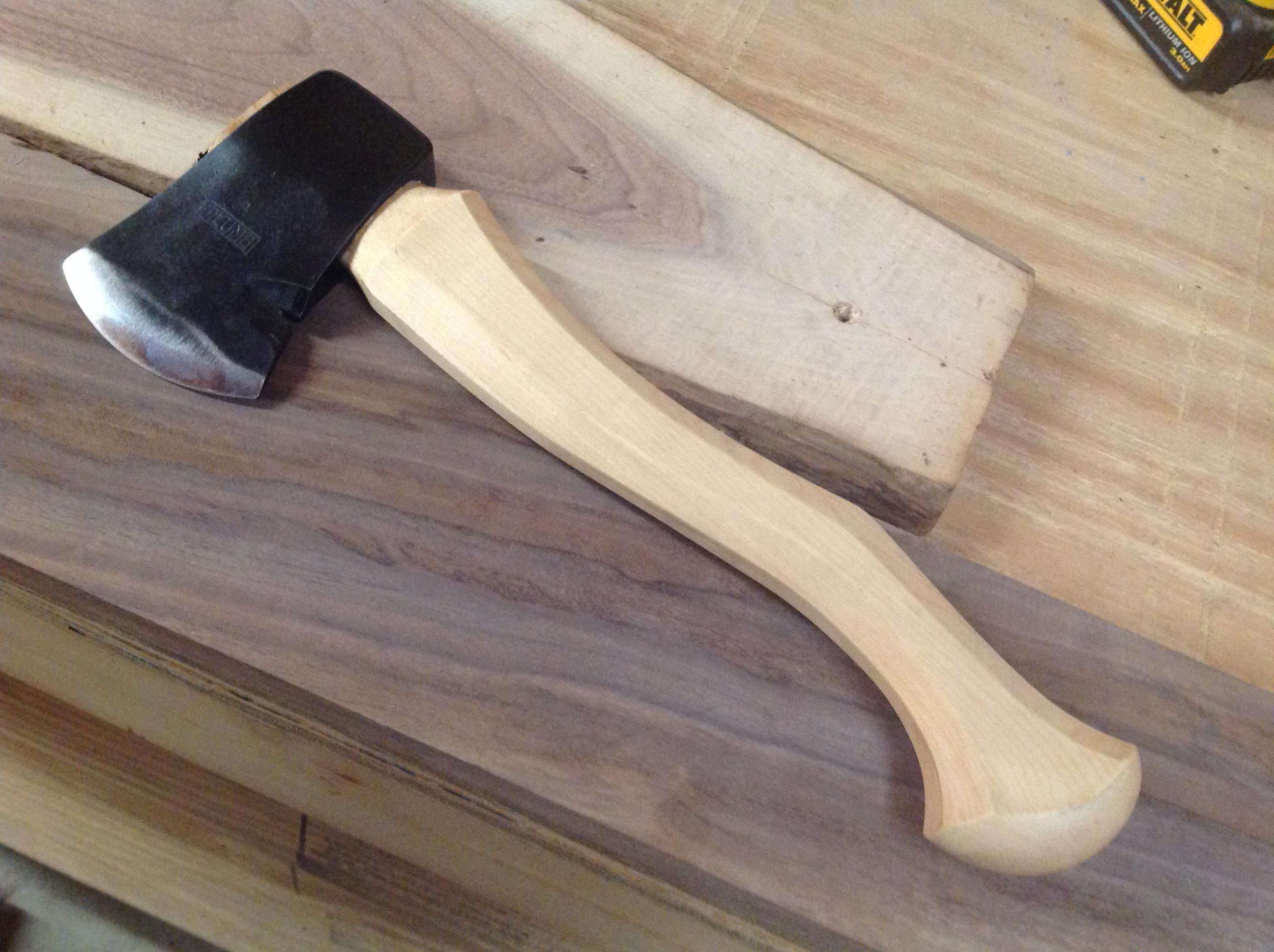

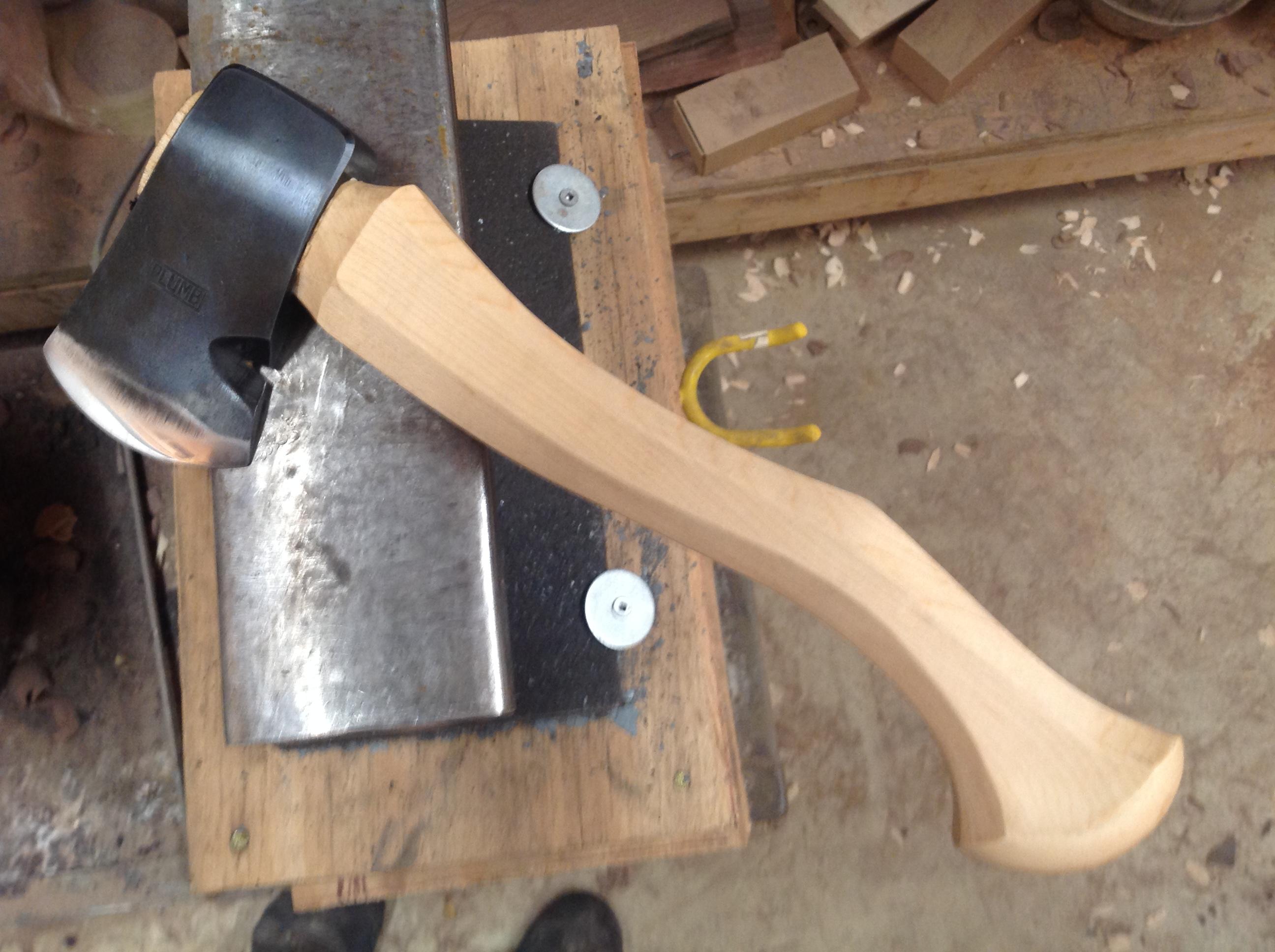

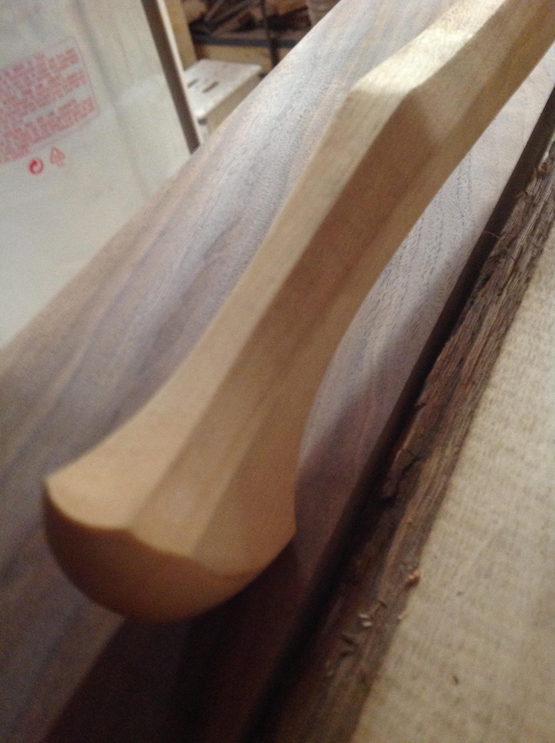

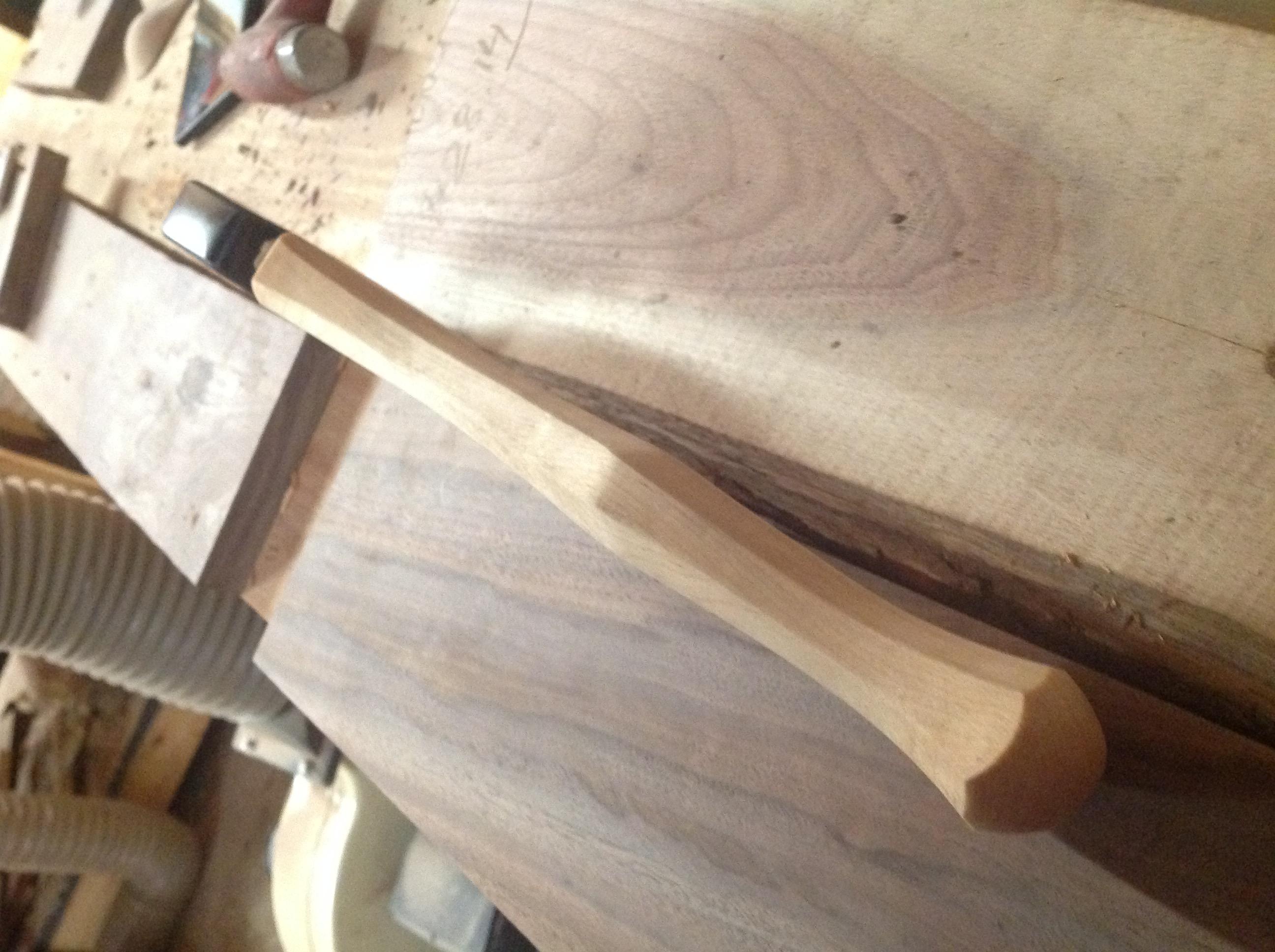

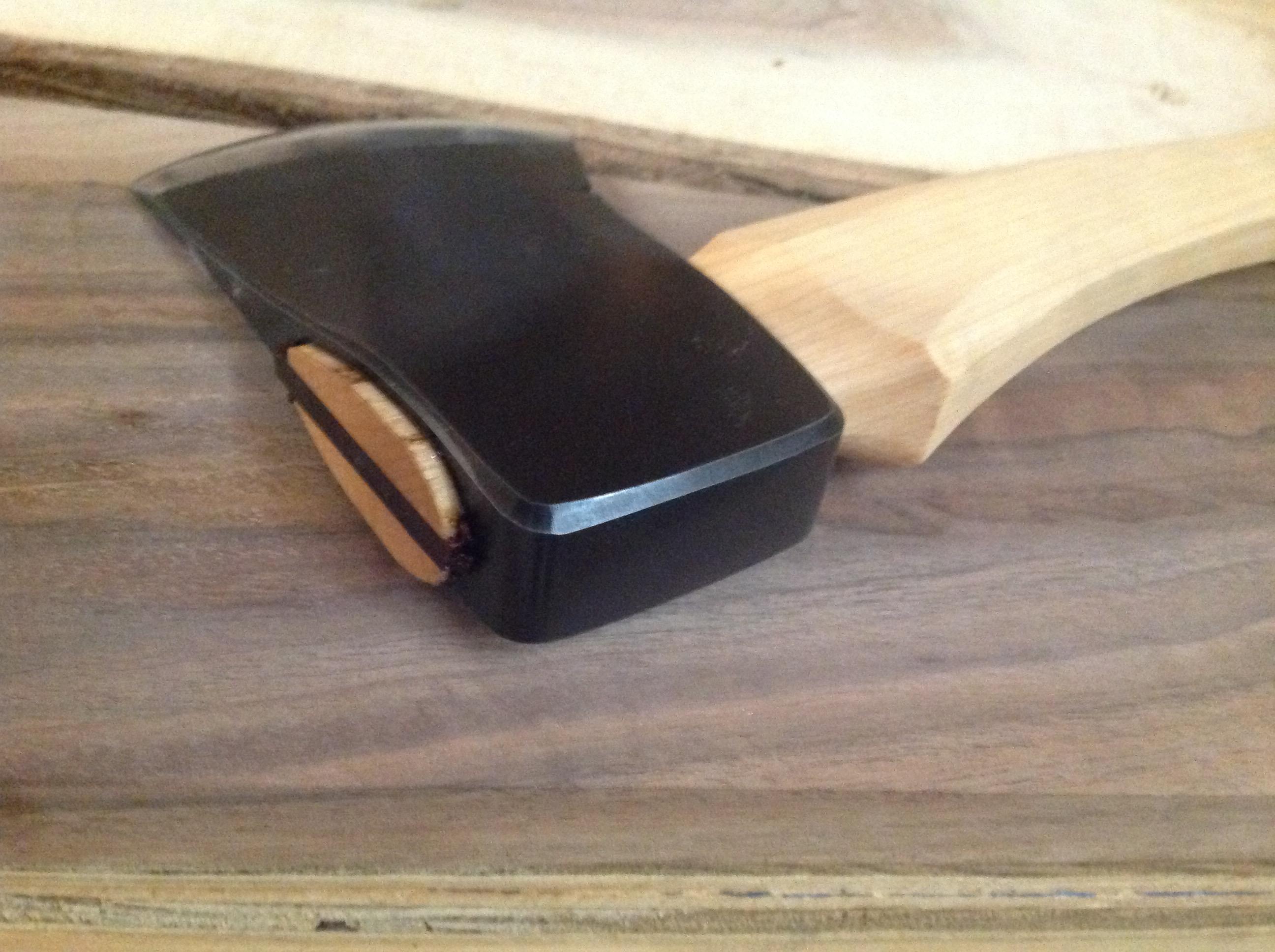

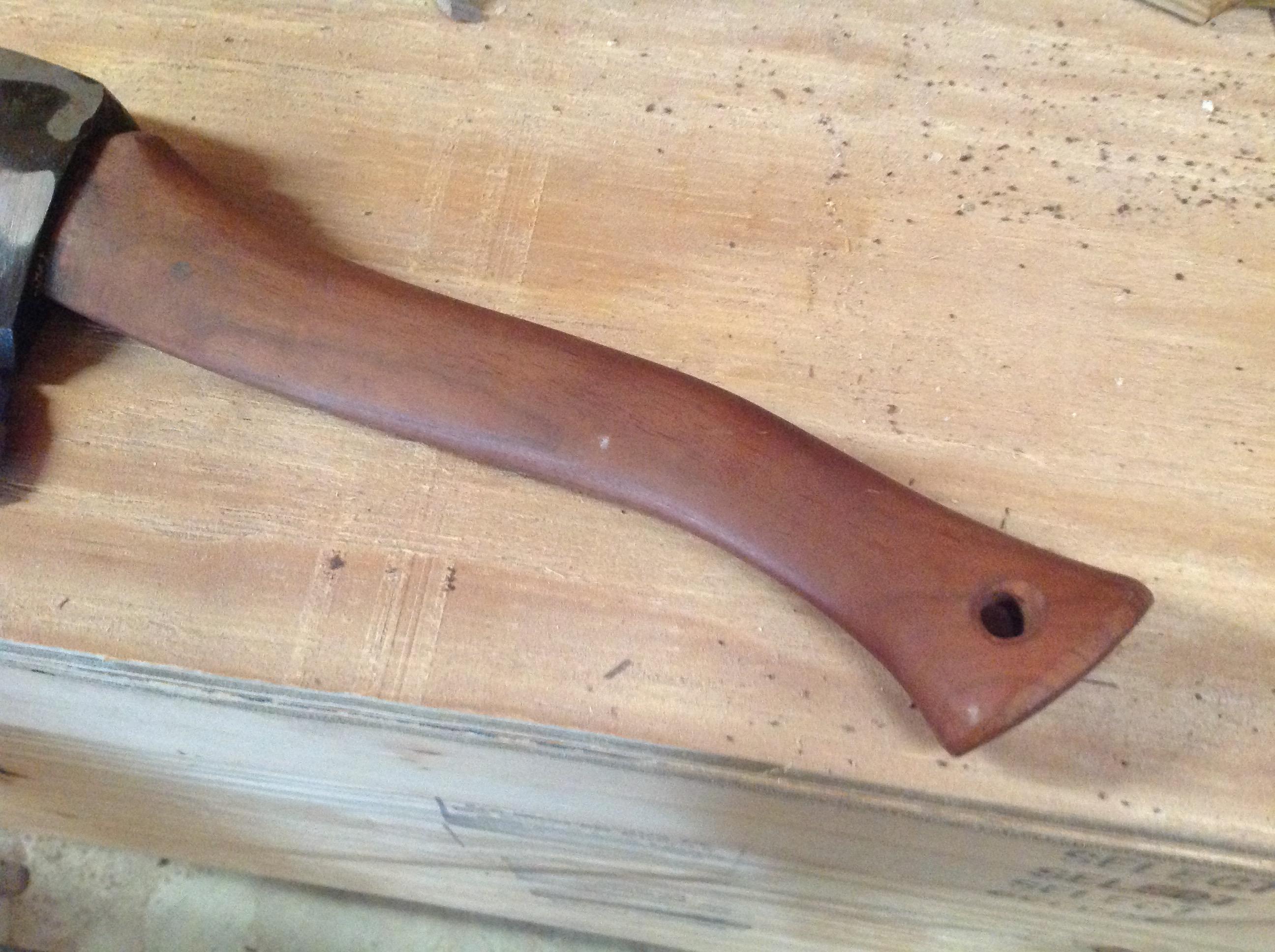

I have a Plumb hatchet that I rehafted a couple years ago, but never really had it quite satisfactory. I decided to give it as a gift to a friend of mine who's coming to town next week, so I cut off the old cherry handle, completely reworked the head, and made a new aggressive octagonal handle from sugar maple. Once again the head was taken to 150 for the surfaces that were straightened or adjusted, then chamfered to 150, sandblasted, gun blued, sharpened.
The old cherry handle done with hand tools only. I like cherry for a hatchet, but GOD cherry sure is ugly with an oil finish :D

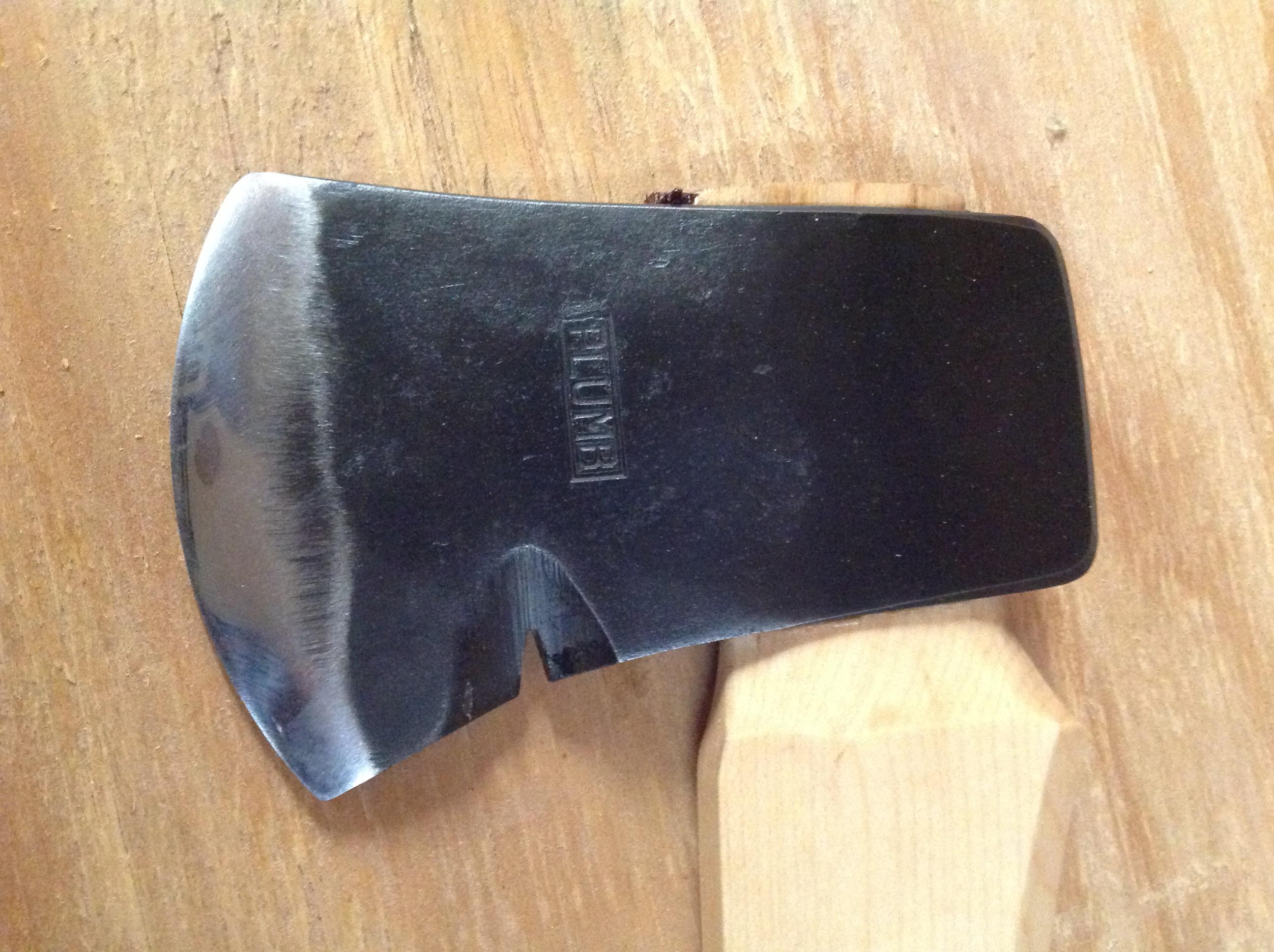

Really killer stamp on this hatchet, please excuse the crap iPad photography.
Yeah, I went overboard with curves and swell. I was inspired by some European carving axes I've seen recently, so why not?

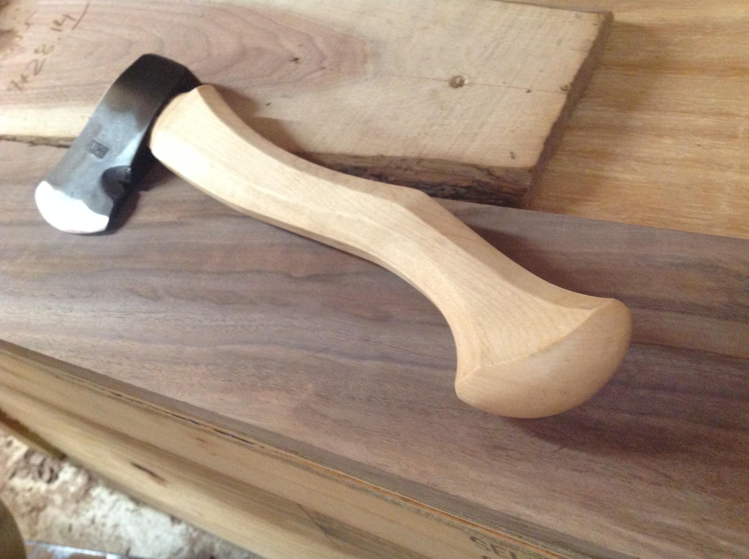

The shape of this haft is actually sort of complex to describe - the sides swell out where the kink is and the plane of the sides actually do an 's' twist which ends up leaning forward toward the swell.
Maybe you can see it here.

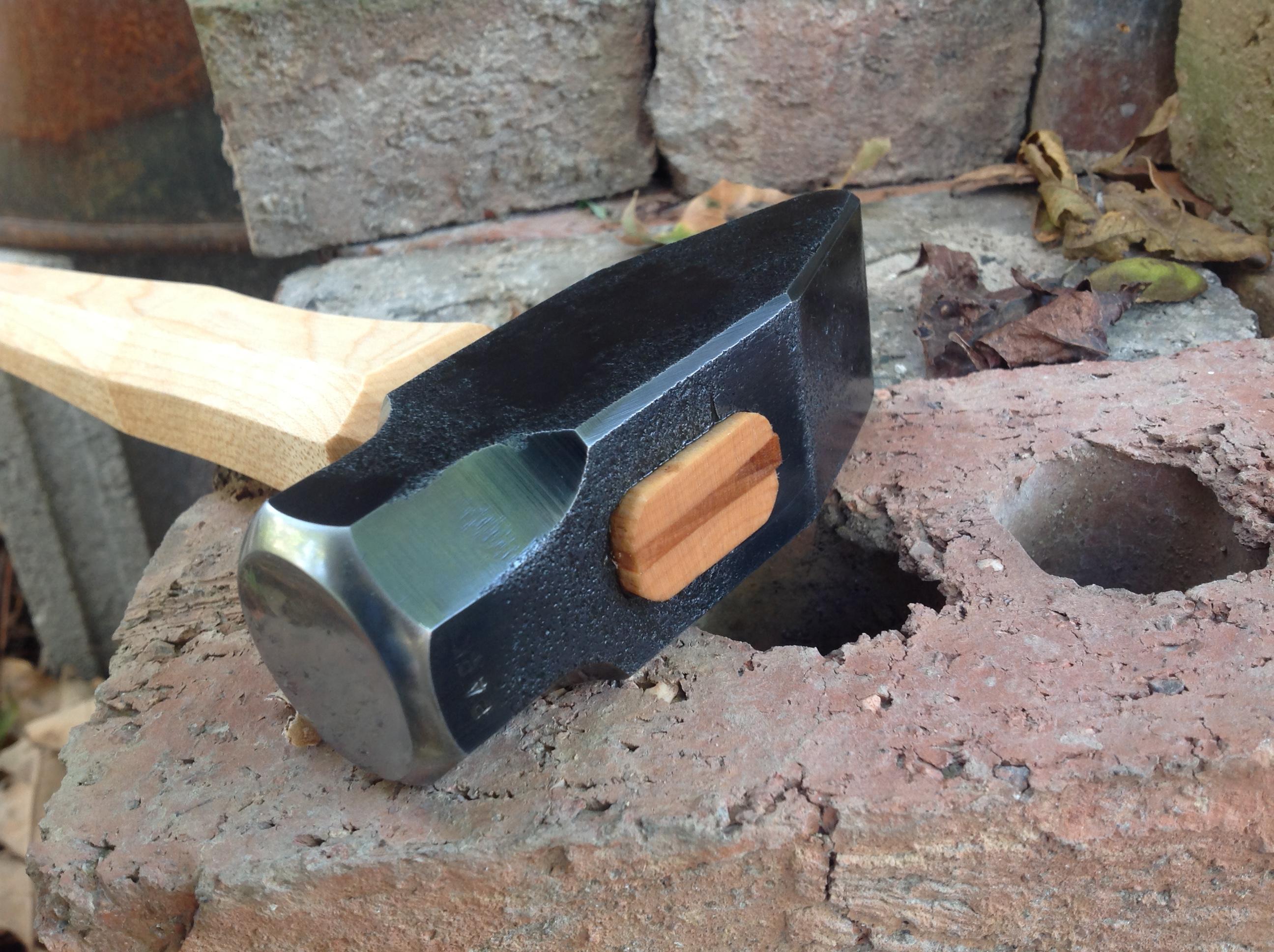

Poll and chamfering detail. Wedge is Black Walnut.

I get the feeling that this head may have had some mushrooming to the poll ? And if so I'd say you definitely made it right, if you can't preserve all of the patina your work is the next best thing.
You've got one lucky friend, and I already envy this person 😁
That is one of the nicest looking hatchets I've ever seen, you've managed to turn a run of the mill plumb scout hatchet Into the stuff of legends.
Thanks, that is a hell of a compliment and much appreciated. There was a bit of mushrooming, but even before chamfering the poll I ground back the uneven forging (not that I mind forging marks, but it seemed like the right thing to do here for some reason).
