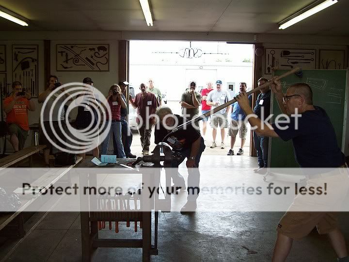

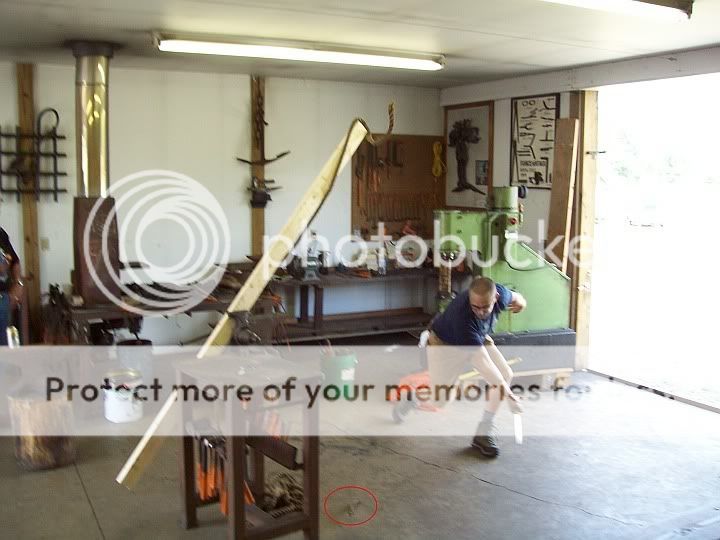

As many of you know, the first aspect of the test is the 1" rope cut
After some precision positioning, ;) all of the rope cut practice in my barn paid off :thumbup:
One whack and I felled the the rope (you can see the drop in the red elliptical circle near the floor)

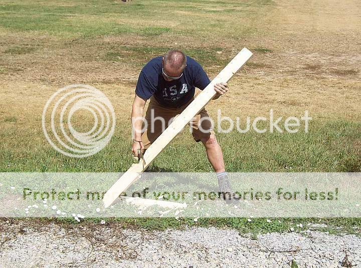

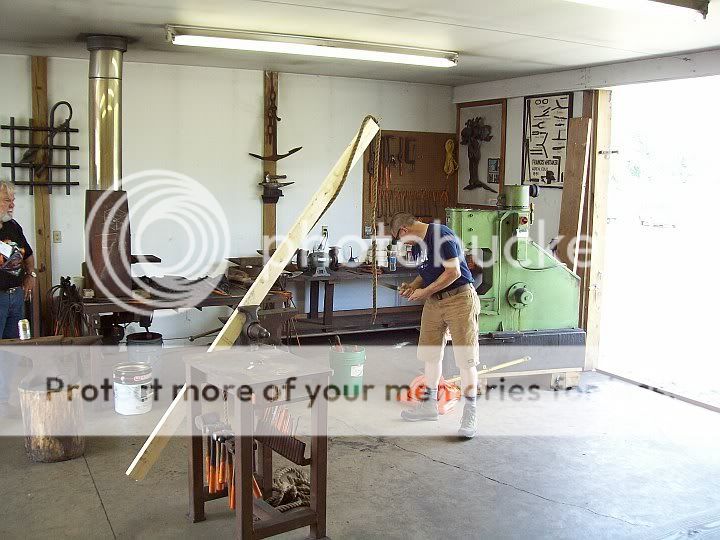

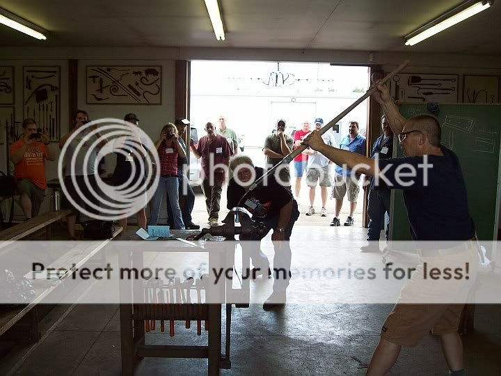

Next part of the test is cutting of a 2x4 .......... twice
After cutting the 2x4 twice, the blade should still be sharp enough to shave with. Many weeks of practicing left me with very little hair on the lower part of my arm, so we had to go higher ;)

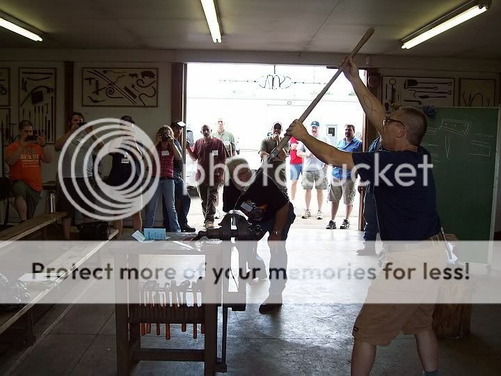

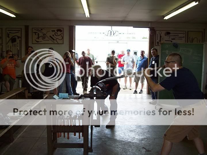

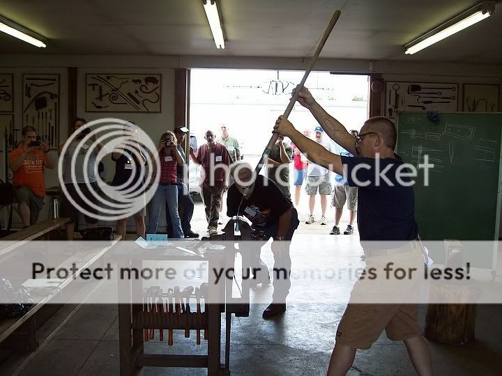

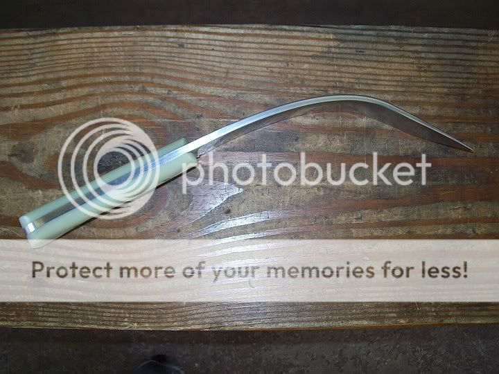

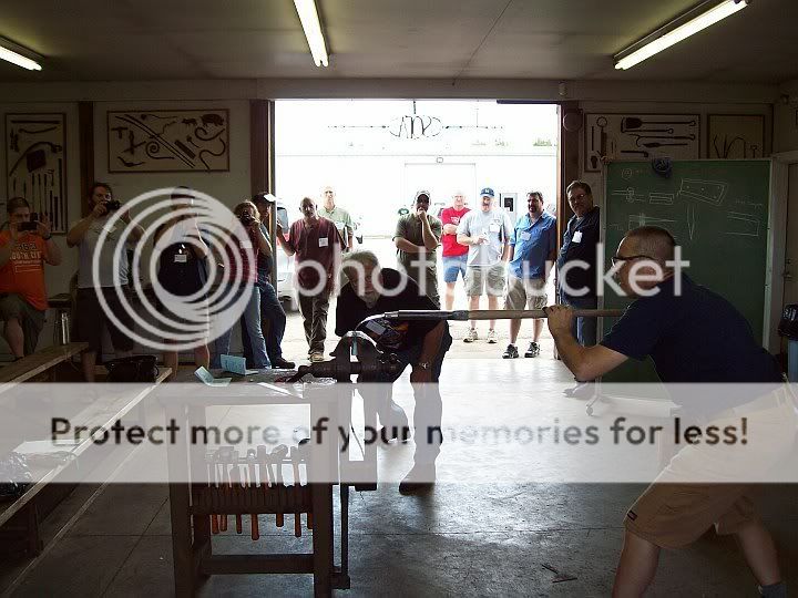

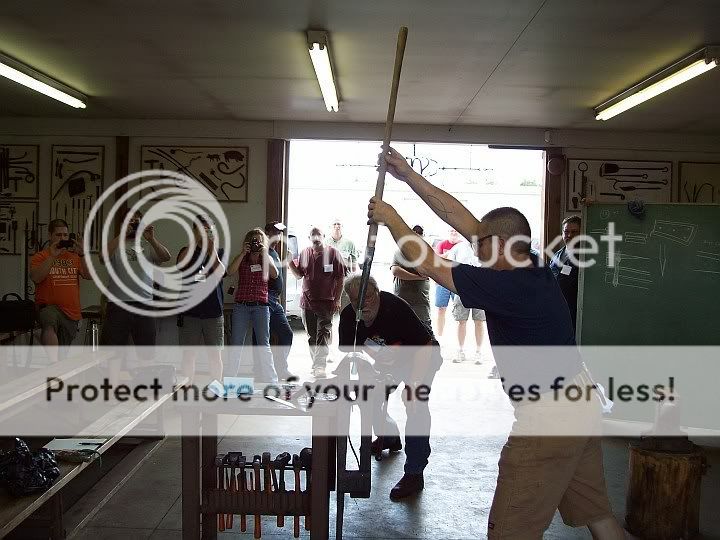

The final part is the bend test ...............
And she passed with flying colors !! No cracks, no chips :D :thumbup:

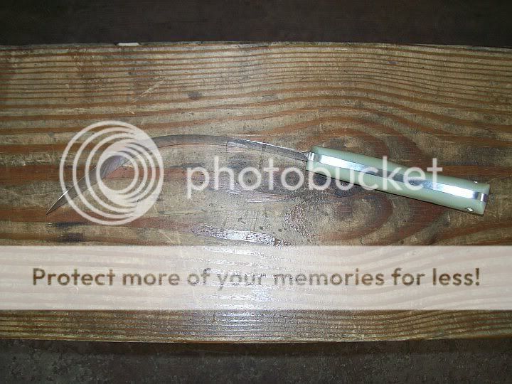

FWIW, my performance test knife was forged using Aldo Bruno's 1075 steel. For Heat Treat I clay coated the spine and soaked the entire blade for 15 minutes in my evenheat kiln. I fully quenched the blade in Parks #50.
That's it. No drawing back of the spine at all. The clay did exactly what it was supposed to do :thumbup:
FWIW, bend test results were nearly exactly like my first test blade here at home :thumbup: :thumbup:
This last shot is a comparison of how consistent heat treat appears to be between my home test blade and the actual performance test blade
