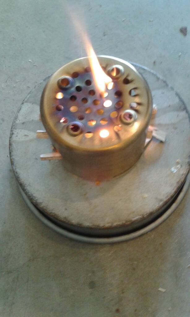

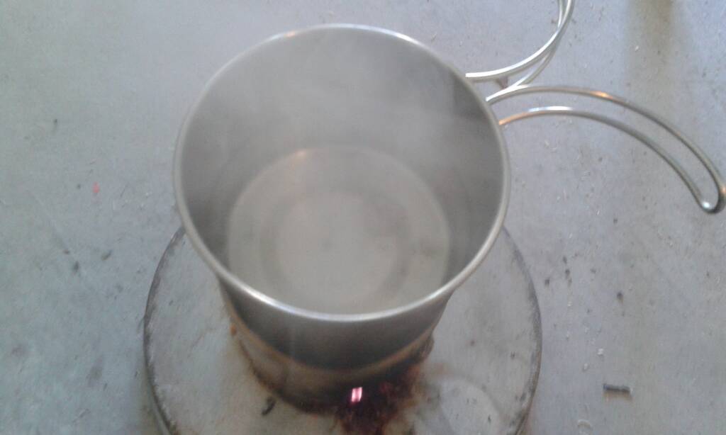

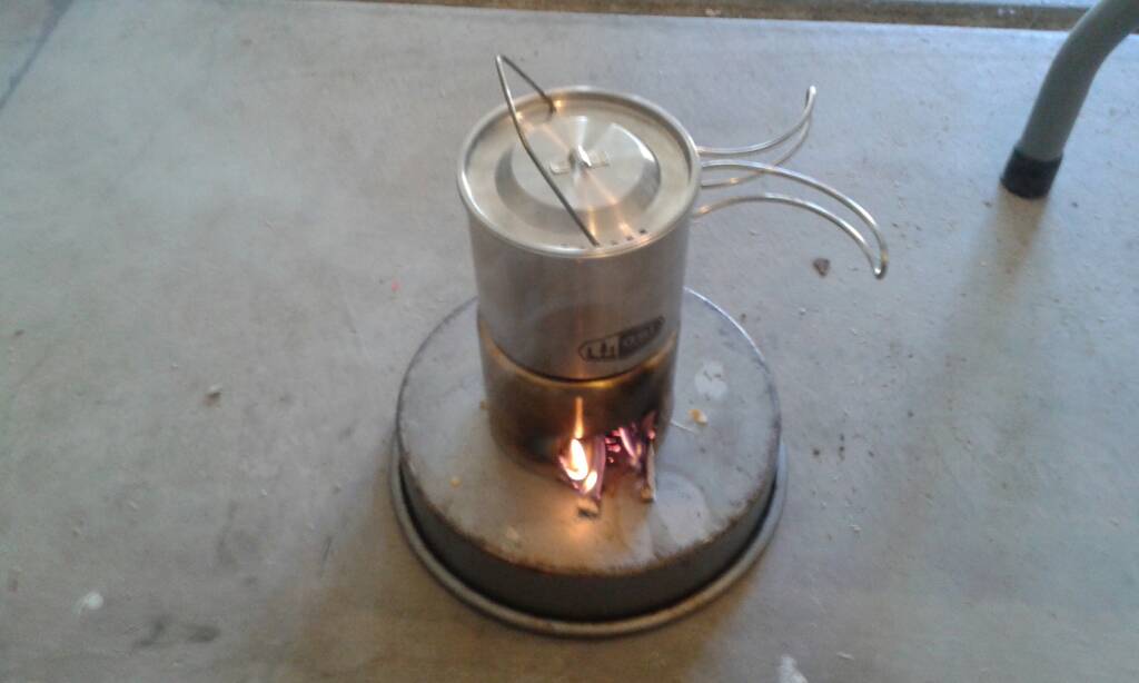

I know this is kind of a necro thread but I have some in use pictures and experience with the pathfinder stove.
I use this stove because it has no moving or additional parts to lose and it nests with my GSI cup and Blackthorn USA bottle.

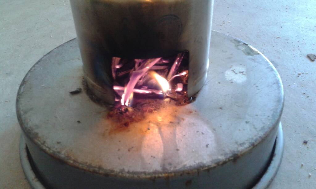

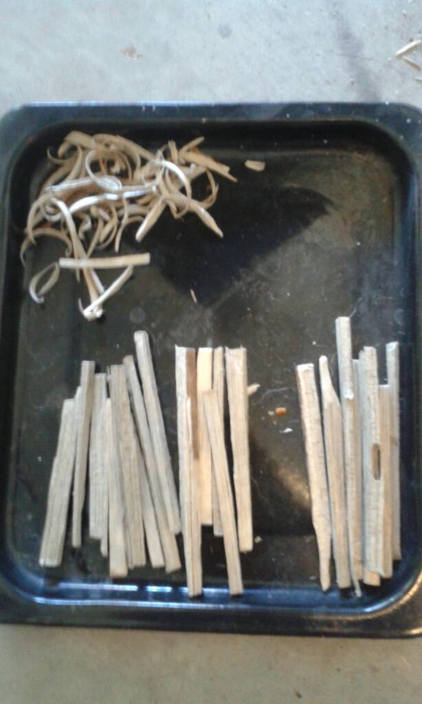

This picture shows the size of fuel I was using for the stove. Pencil thickness seems to work best but you have to be careful not to overload the stove as it will not get enough air and will extinguish itself.
After it gets going you can get some nice red hot coals going.
This setup boiled water in under 14 minutes from lighting to actual rolling boil. It may no be the most efficient but it will also work with my Swiss military Trangia and fuel tablets. Also it is a benefit as I live in the desert and there is a lot of small dry fuel and oftentimes regular fires are not allowed. Also yes I know all this was garagecraft but it was a pretty windy day which actually seemed to help rather than hinder the setup.
