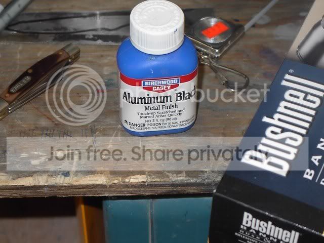

I put a patina on my Clipper by using aluminum black, and it turned out great!
I have done the lemon juice patina on a couple Old Hickory knives I have and it worked great. Not cheating, just helping along :D
barny, what is aluminum black? Do you have pics of the results? Sounds interesting.
Aluminum Black is sort of like blueing, but it actually comes out to a black or deep gray and I will post pictures when I can find a working camera.
Hey barny, does the aluminum black affect whether or not you can use the blade for food prep?
Ok, Longbow.... I think you just saved my life, yes I'm pretty sure it is not safe for food prep, because the bottle had a big warning saying harmful if swallowed, but I'm not sure if still is harmful when dried, but I'm taking out tonight, and cutting apples for a patina.
This is the bottle.

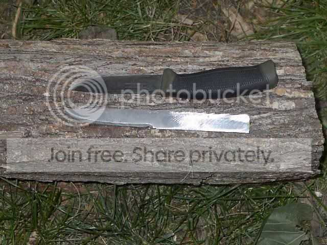

This is the outcome.
It is a great solution for a quick patina, but not for food prep.
I would bet that once it's dry, and has been on a whiile that it won't hurt food. Looks like it gives a nice, black patina too.

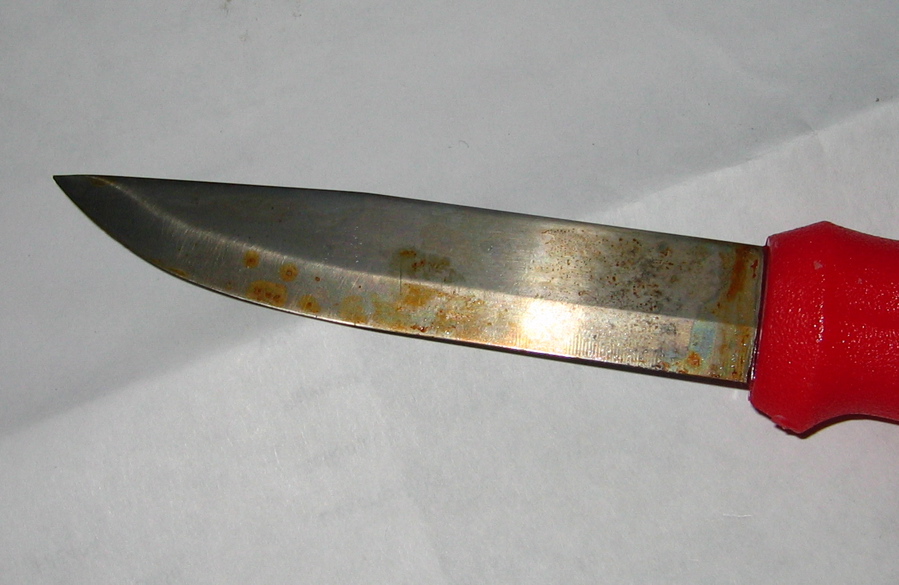

Ok, so I tried this on my beater mora and this is what happened.
What am I doing wrong? is it ruined? I rubbed it down with mineral oil to try to clean it off, but it looks stained.
Thanks
Cru
I used some vinegar, rinsed then lemon juice. Maybe that was a douchy move. Whatever, I'm not too concerned about the looks, just wanted to screw around.
Thanks
Cru
Crujones, don't panic, no harm done. Just rub that clean with a scrubby sponge or something similar, sandpaper or whatever. Take a paper towel, soak it with vinegar and wrap the blade in it for a half hour or so. You should have a black blade after that treatment. Rinse the blade in fresh water and dry it. You should end up with something nice.
