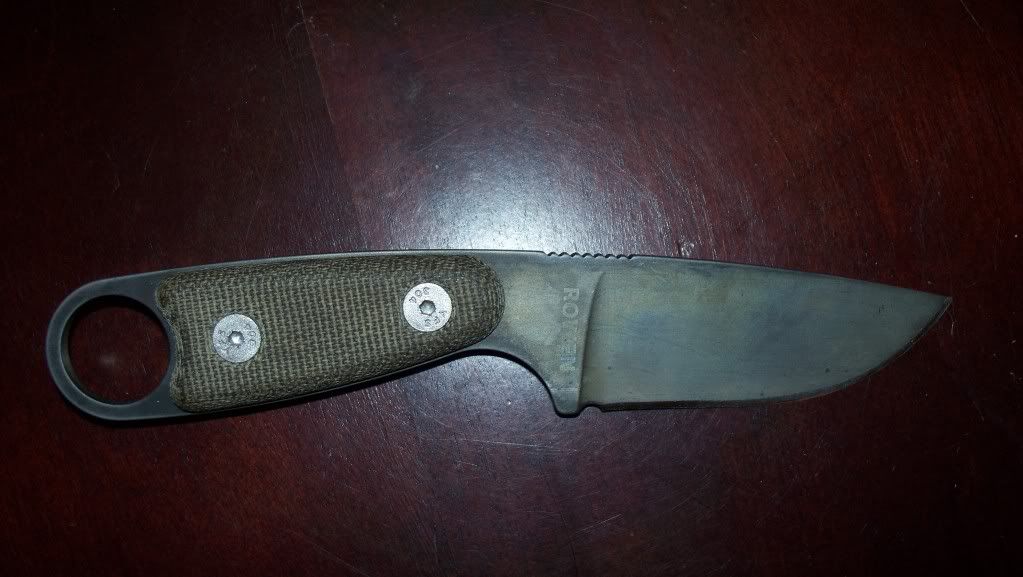

Here is an older picture of my Izula. It was taken after a lime-patina. I just cut up a lime and dabbed the Izy every 15 minutes for a couple hours until most of the blade was darkened.

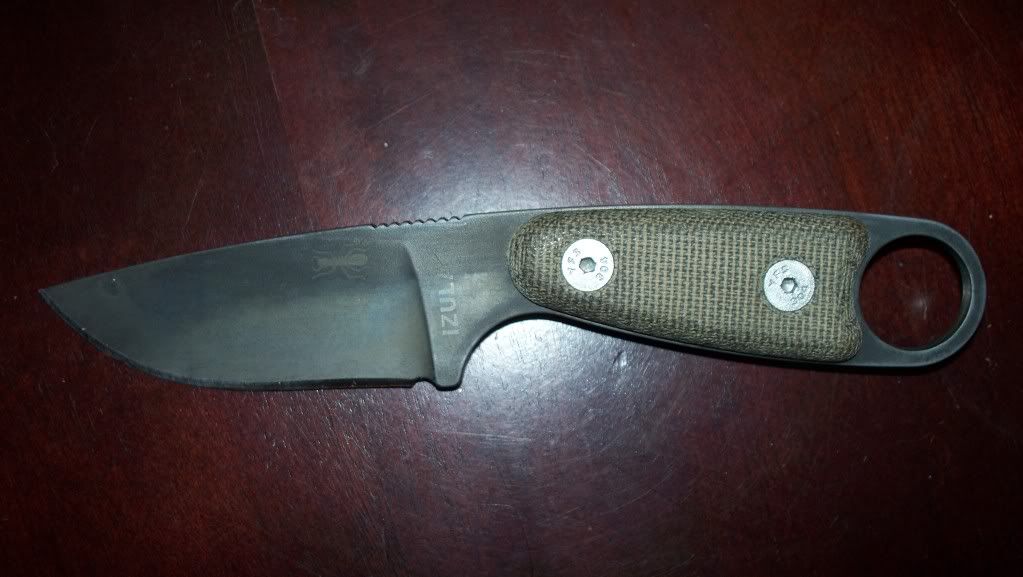

Here is an "after picture." This photo was taken after I got back from an extremely wet day hike in a tropical jungle. It rained continuously and the hike was all upstream -I really wanted to see just how bad rusting could get. I took the blade out every 15 minutes or so to wipe off the oxidation-grit. It saw a fair amount of use that day as well. Here are the results:
Not bad eh?

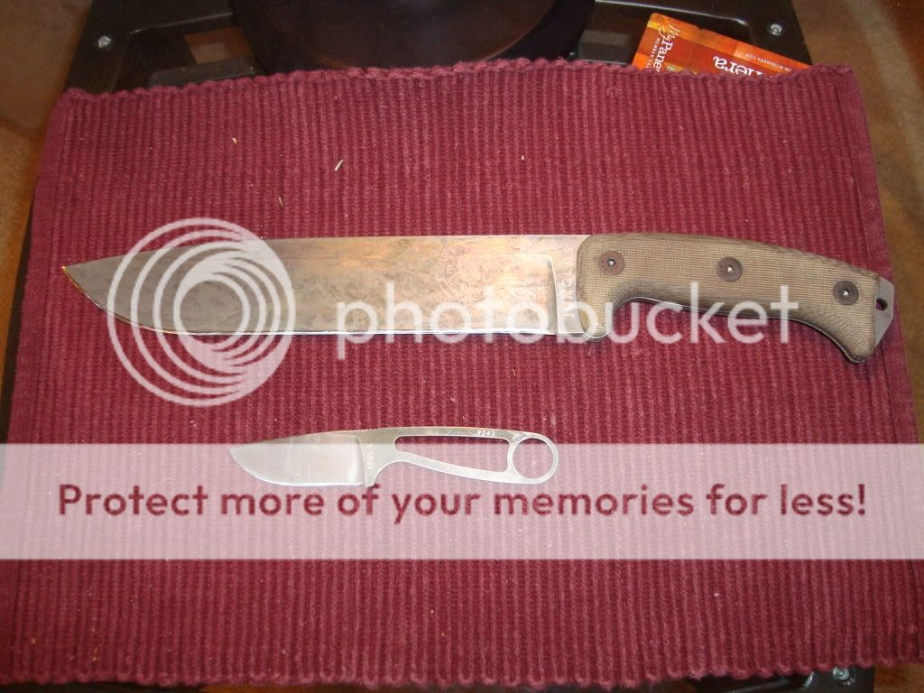

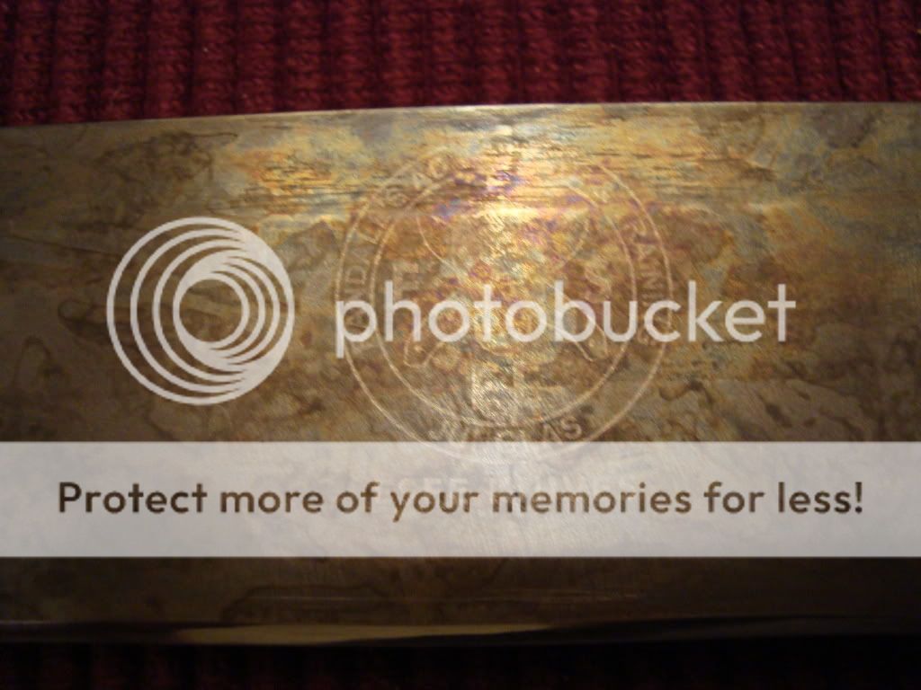

add a couple of pics of my 6 stripped and mustard patina and dyed the scales.

Here they are....

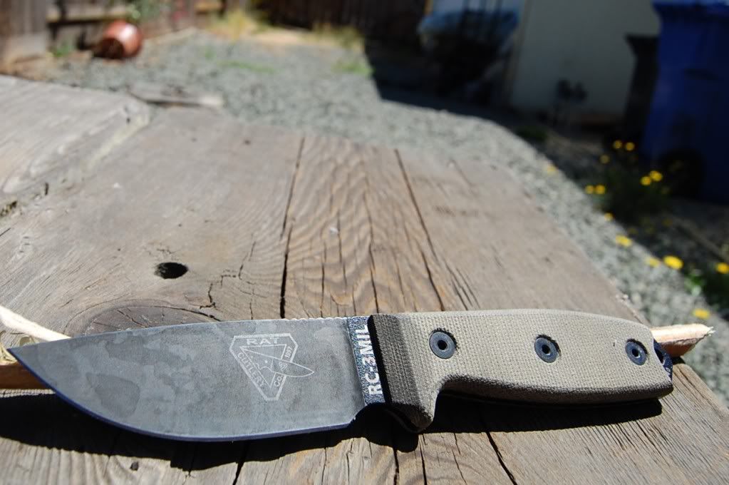

stripped it. scraped it. Think I might have spent a minute sanding it a bit, as the finish is strange with the coating off. But pretty much could have skipped that step. Then I cut up a bunch of plums that my neighbor had graciously donated to me (or, they neglected to prune their branch that overhangs our fence and yields a ton of fruit) for a fruit salad, and just let the knife sit with the juice on it for 45 minutes or so.
very light patina, not sure how I feel about it, though.
