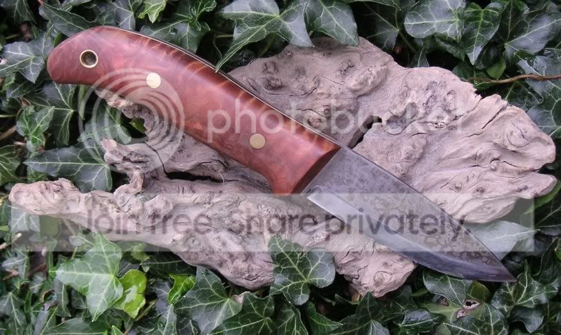

O1 tends to grow grey in its patina. I tend to let mine develop on their own. My peacemaker sees a lot of kitchen duty and the kids aren't the best at wiping my knives down after using :( So every once in a while I take a green scrubby with comet powder to them when they get too blotchy and that just sort of blends in the dark splotches with the rest of the patina. Here is a shot I just took of the knife as it is in my block. Sorry Bryan - I didn't oil up that wonderful osage orange handle to make it look purty and it looks like this puppy needs another cleaning!. Great blade for kitchen and belt carry!
