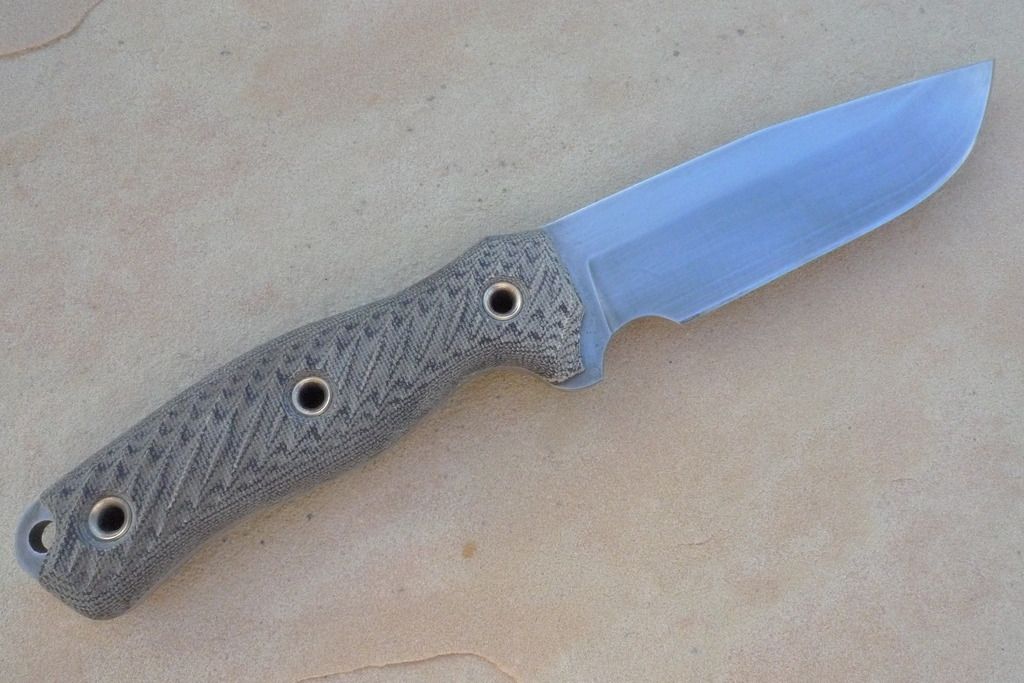

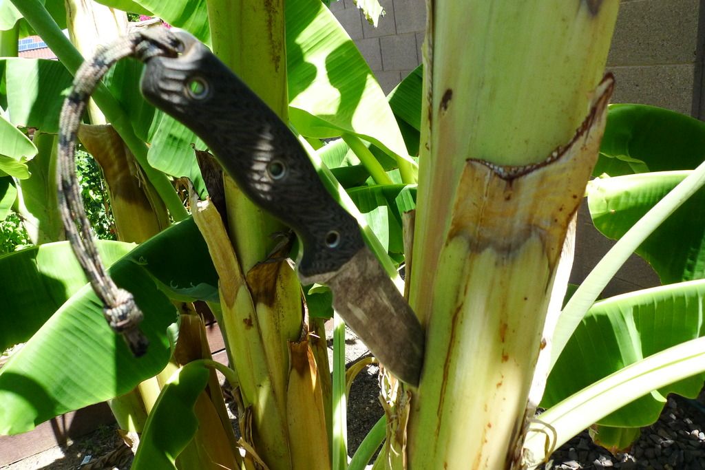

I bought this knife with a Black coating. It has been stripped and sanded to a pretty good ghetto satin. Recently I was out in the yard for about 1 hour cutting back the Banana Trees. See the pretty cool natural patina that has developed. Do you guys let your knives patina? I will probably leave this as is for a while to see if I like it.
Lets see your PATINAS!!!
Before

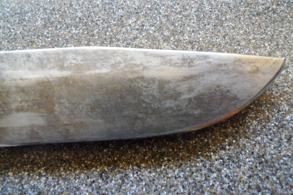

After
SR101 takes a great patina!!

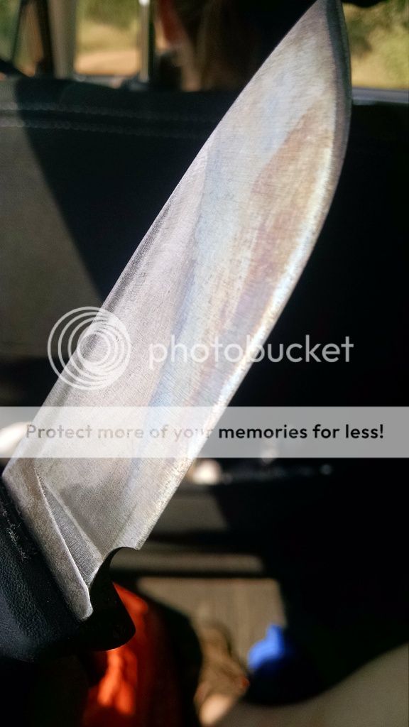

Mustard and Vinegar both work very well. Here are some of my favorites from years gone by.
Vinegar followed by mustard
Vinegar

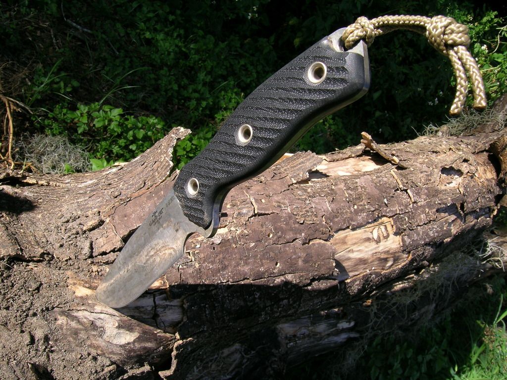

Here's mine with some patina, It's a RMD custom shop full flat grind. It's got the original convex edge that I've stropped a few times.

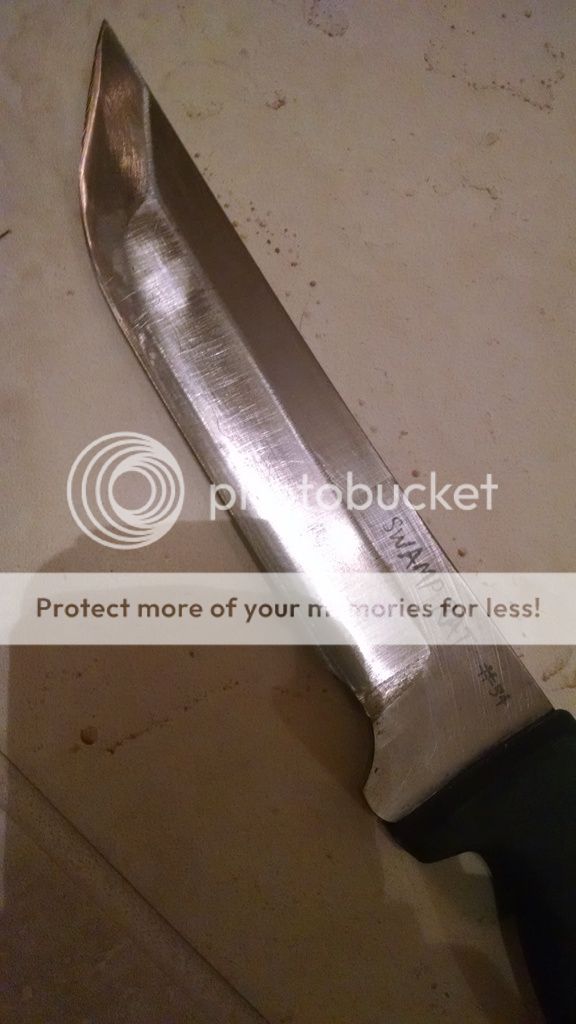

It started spotting so I forced a patina. Would much rather have a patina than a coating.

Boil white vinegar and bathe your uncoated blade in it and then buff with fine steelwool and repeat until its how you like it. I boiled the vinegar in a pot and then poured it into a 9x13 brownie pan with the knife in it. I dont think it is hot enough to mess up the heat treat but I didnt want to risk leaving the knife on the heat. I dont have any stripped rats, but i did it to a TOPS knife that I stripped and it looks awesome. Its the knife in my profile pic.
