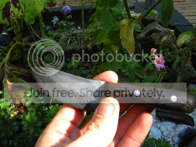

If you want a nice even patina FeCl is the way to go. Best way to do it is clean the blade, soak in a 5:1 water to FeCl ratio until you get the color you want. Usually a minute or less. Rinse with water and clean with 000 steel wool. Repeat as desired. Be sure to oil after etching and cleaning.
These are some trade knives I handled and etched with FeCl. They were really shiny and rough, had lots of black pits on them. Cleaned up and etched they look pretty good.
