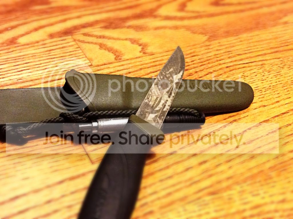

This was done by soaking paper towels in lemon juice then wrapping the knife in it for about 5 hours
