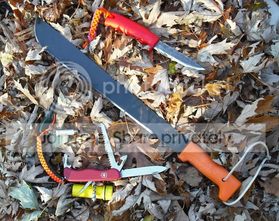

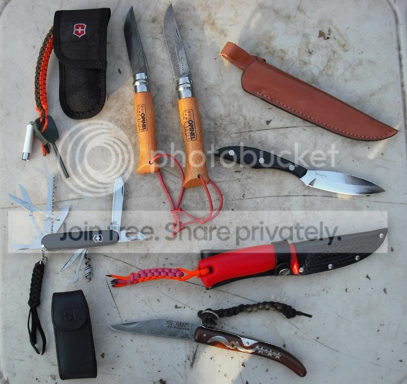

Using this method, I turned my shiny Opinels and Okapi into these...
and my Mora from this...
into this (the very top knife)...

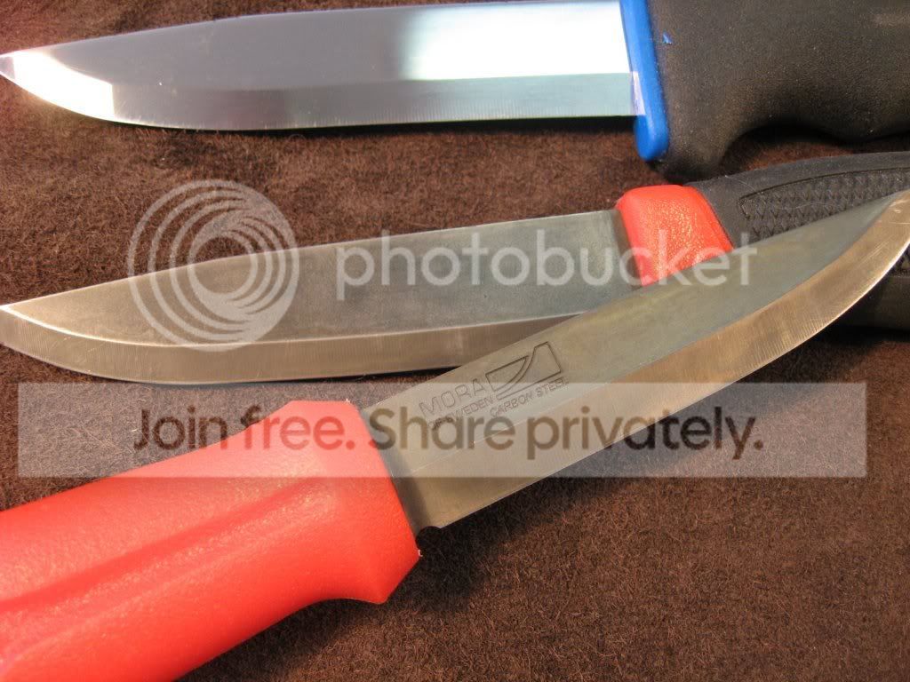

Before:
After:

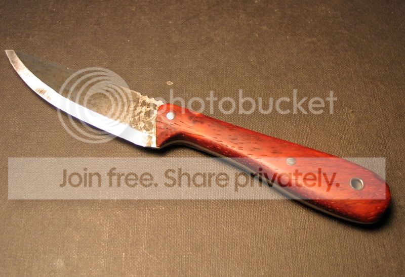

here is a knife i made last year. i put yellow mustard on the right side in rows then let it dry for a few hours. once it was dry i put some on the left side and let it dry. then i soaked the blade in vinegar and agitating the blade when bubbles formed. once the mustard had soaked off i ended up with a neat looking patina on the right. i need to redo the left side one of these days.
