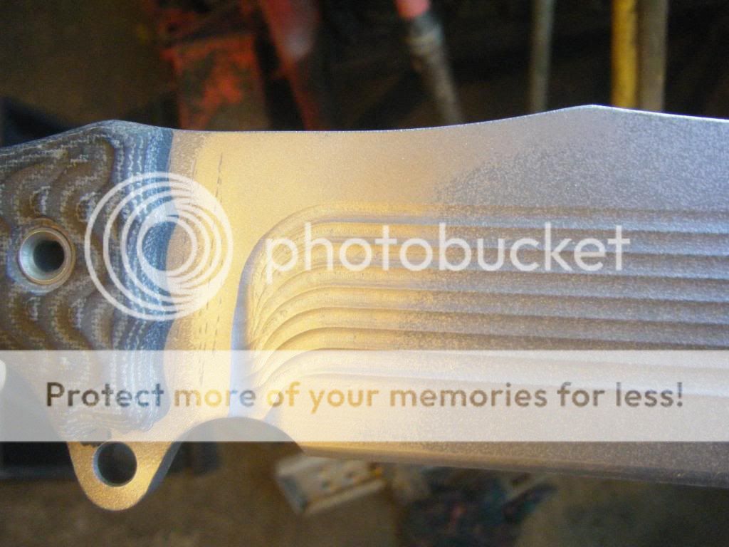

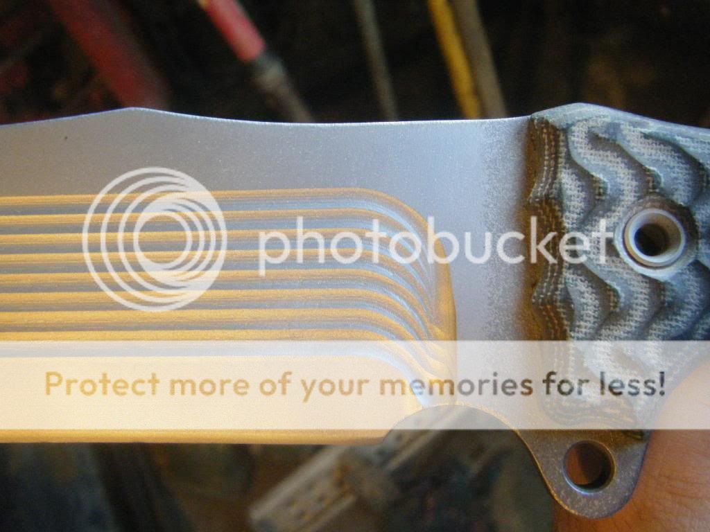

i tried with a cgfbm that i sand blasted to remove th de-carb. i was using mustard to do this, i left it on for 24 hour's and nothing really happened. toward the grip's where i did not blast rusted a little on the de-carb, but that was it. i'll try and get some pic's up for ya.
here are a few pic's of what i was blasting off the blade. this was under the black coating. look close you can see the finish is differnt. i can't find the one's with the mustard right now.
Satin INFI won't take a patina. Some success has been had with stripped CG blades. The surface of the steel under the paint will sometines take a blue.
