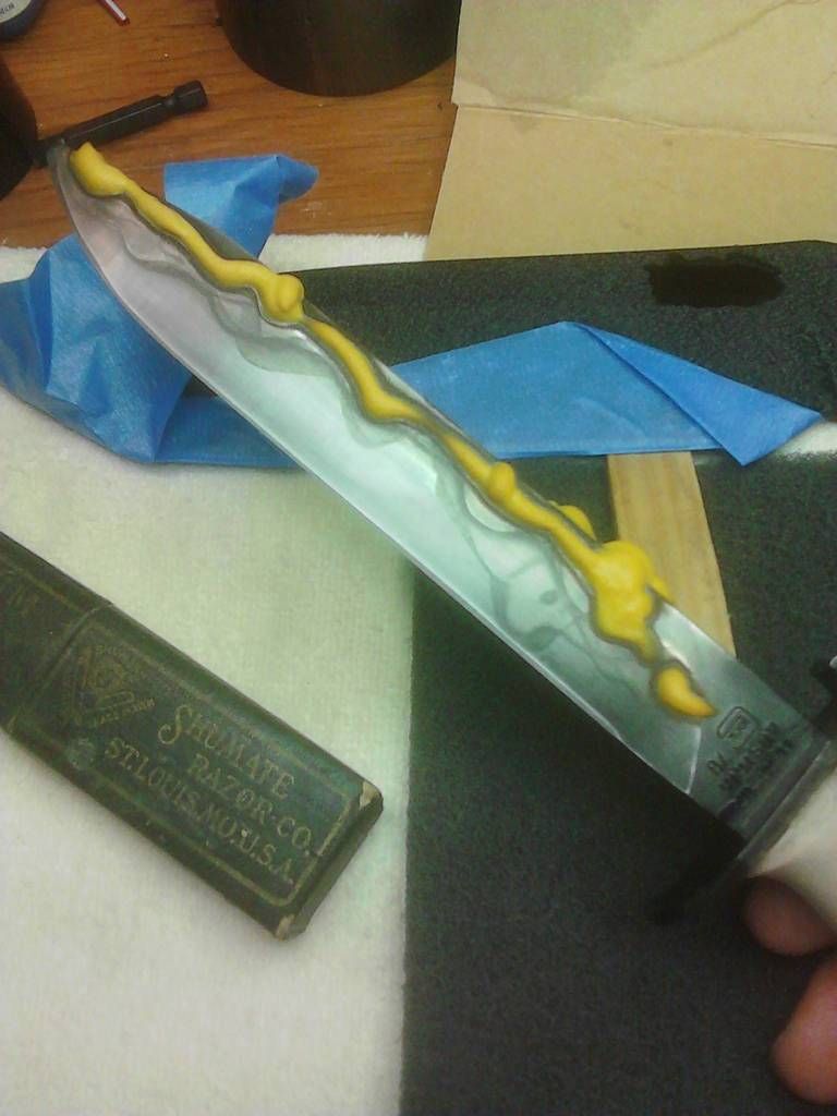

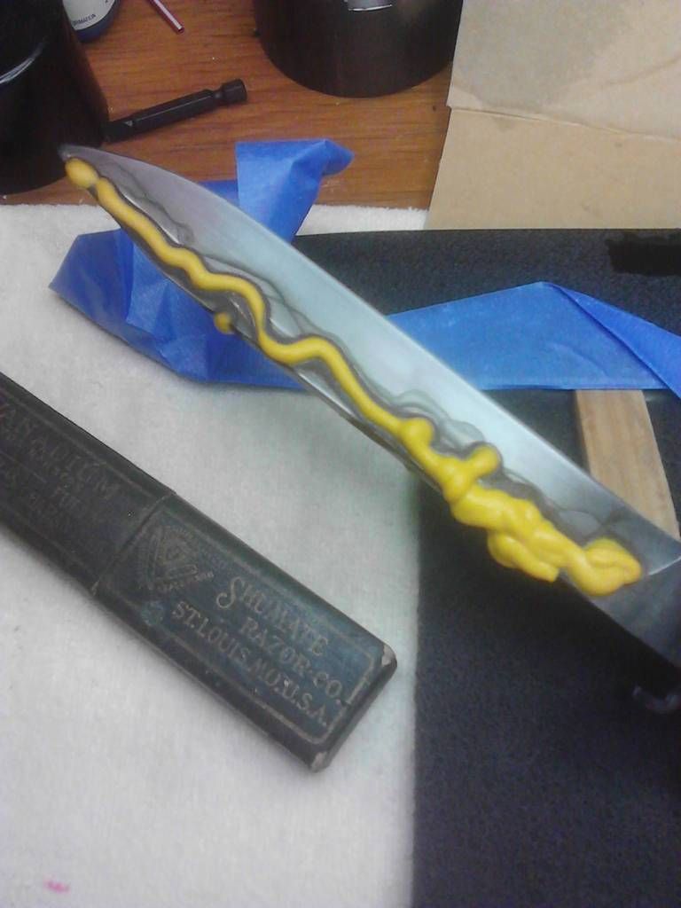

I did this one with a mixture of brown mustard and Frank's red hot.

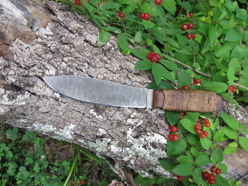

I only did one side, the other side I let it patina on its own.
2 more weeks down and many more dinners made. This is how it looks currently with oil on the blade:
