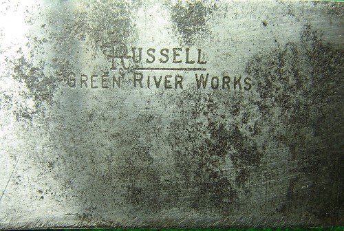

Here's my best patina...All natural. And Red bone any day over plastic.
Sincethis photo was taken a small chip ended up on the scale where the can opener tap hits.:mad:
