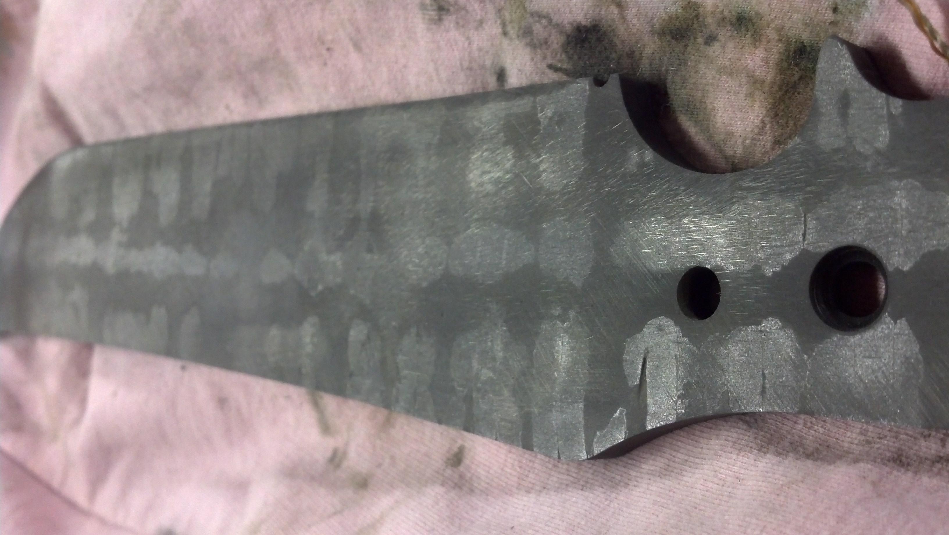

This is spring steel wrapped tool steel i was experimenting. It is an actual spring wrapped around a tool steel round stock.
