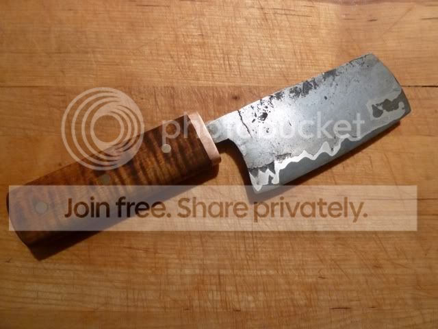

Here is one of my first 'sub optimal results' with wi/nickel/15n20. I had huge areas of delam in the billet between the wrought and the nickel (the nickel welded perfectly to the 15n20) and lots of huge inclusions in wrought. This is what I was able to salvage from the drawn-out billet. It managed to stay together throughout the heat treat. I think the delams were due to a combination of extremely unrefined slaggy wrought and insufficient soak at temp. The weld I did right after this had no delams but too many inclusions in the wrought. If I continue to use this wrought I'm gonna have to do some refining. Sure etches well though!
This knife isn't done yet... Needs more polishing and handle sanding... I may not even finish it..... That crack in the wrought at the spine is just a little too gnarly.
If you have wrought with lots of inclusions it is best to save that for fittings as that is what we like to see in fittings. Get some cleaner wrought to do the san mai with. Also wrought needs a higher temp to weld, if you had a thermocouple you could bump the heat up 50 degrees and soak a bit longer. To my eye I look for a bright yellow.
