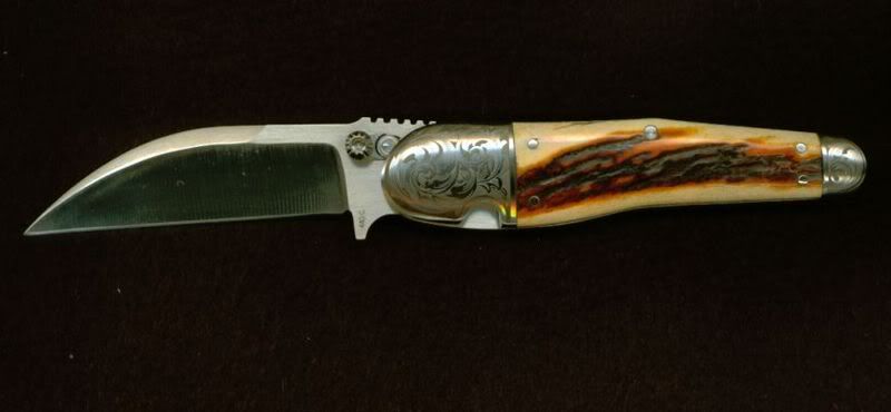

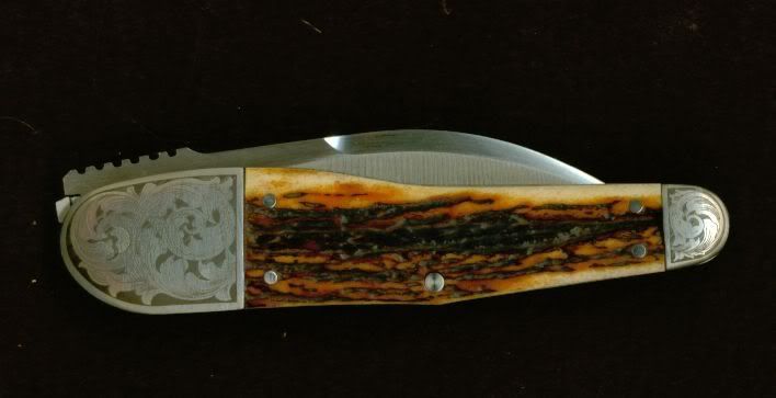

Whenever I buy a knife sight unseen, I make a mental picture of what to expect. Then rate the knife above, at, or below expectations. This one is definitely above my expectations. The folder is a perfect fusion between modern and traditional styling. The Wharncliffe blade is both practical for most chores and just looks cool. You can see the blade was painstakingly polished in a brushed style in two directions (vertically at the cutting edge, horizontally near the tang and around the edges).

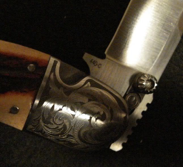

It has an open design like a modern folder and a locking system that is truly unique. I included a picture because it’s hard to describe. Basically the stud acts as an opener and a lock release too. The round disk in front of the stud is the locking piece. The locking piece actually turns like a wheel and rides along the bolster as the blade is opened and closed. The disk acts as a detent when the blade is closed.
Overall the fit and finish is perfect, the engraving looks to be hand-done not machine made. I'll use it as a gentlemen’s knife for light chores. I didn’t photograph it with another knife but its’ about the same size as a Kershaw Leek.

;) The engraving is possibly hand-done - it's a lot cheaper over in China.
Very nice looking.
I've seen something similar to the locking system, but I'm not sure where.... CRKT or SOG?
P.S. The "brushed polish" look is from using machines to give the blade a final shaping (horizontally for distal taper, then establishing primary bevel).

I'm a bit of a Stag-aholic and this knife looks really good to me.
Nice score.
Fantastic collection of bone and stag there! Excellent pix that do justice to the knives,those Barlows are very appealing.
If I'm understanding the lock description correctly, it's a Michael Walker design. Columbia River produced it in their BladeLOCK series of knives.
http://www.gunaccessories.com/ColumbiaRiverKnives/BLADLOCK.JPG
I had one of the original BladeLOCKS for awhile--really is one of the neatest and most solid lockups I've ever seen for a folding knife. In this particular case, unfortunately, it was paired with an AUS-6 blade and one of the least ergonomic handles I've ever held. Good to know that the lock is available in something else, though. As far as I can tell, the only way for the lock to fail is for the metal stud that goes through the blade to actually be sheared off, which makes it far superior to liner locks and lockbacks. I think the principle reason it hasn't found a lot of acceptance with manufacturers is that it is a far more complicated (read: expensive) system than the others.

I'm not familiar with the lock on the CRKT product, but the locking piece on this knife is actually the little disk in front of the stud. The disk turns like a wheel along a small track on the inside of the bolster. It sinks into a depression when the blade is opened.
and yes it does look complicated, I opened and closed it several times before I realized the wheel has actually moving.
