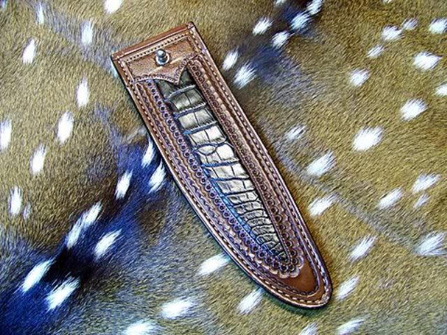

As my first sheath for the stag handle Southwest bowie was eaten by my dog, we decided to change the second a bit.

For those of you who may be interested, one of the changes in this sheath was a departure from the use of deer skin as a full lining. Using the same leather as the rest of the sheath is made, I mechanically split the leather down to a fraction of the original thickness and then used that as a lining in the usual manner. We still have that nice little roll at the mouth of the sheath, but this time the lining exactly matches the rest of the sheath. The other obvious change was to have the front and the back equal length in the tradition of the true sash sheath.

very very nice. Hope ya got alot of raw hide chews for the dog.
Yep Joe, I got some rawhide chews, as I can't afford to have anymore sheaths destroyed, not to mention that my carelessness ruined what I consider a work of art.
