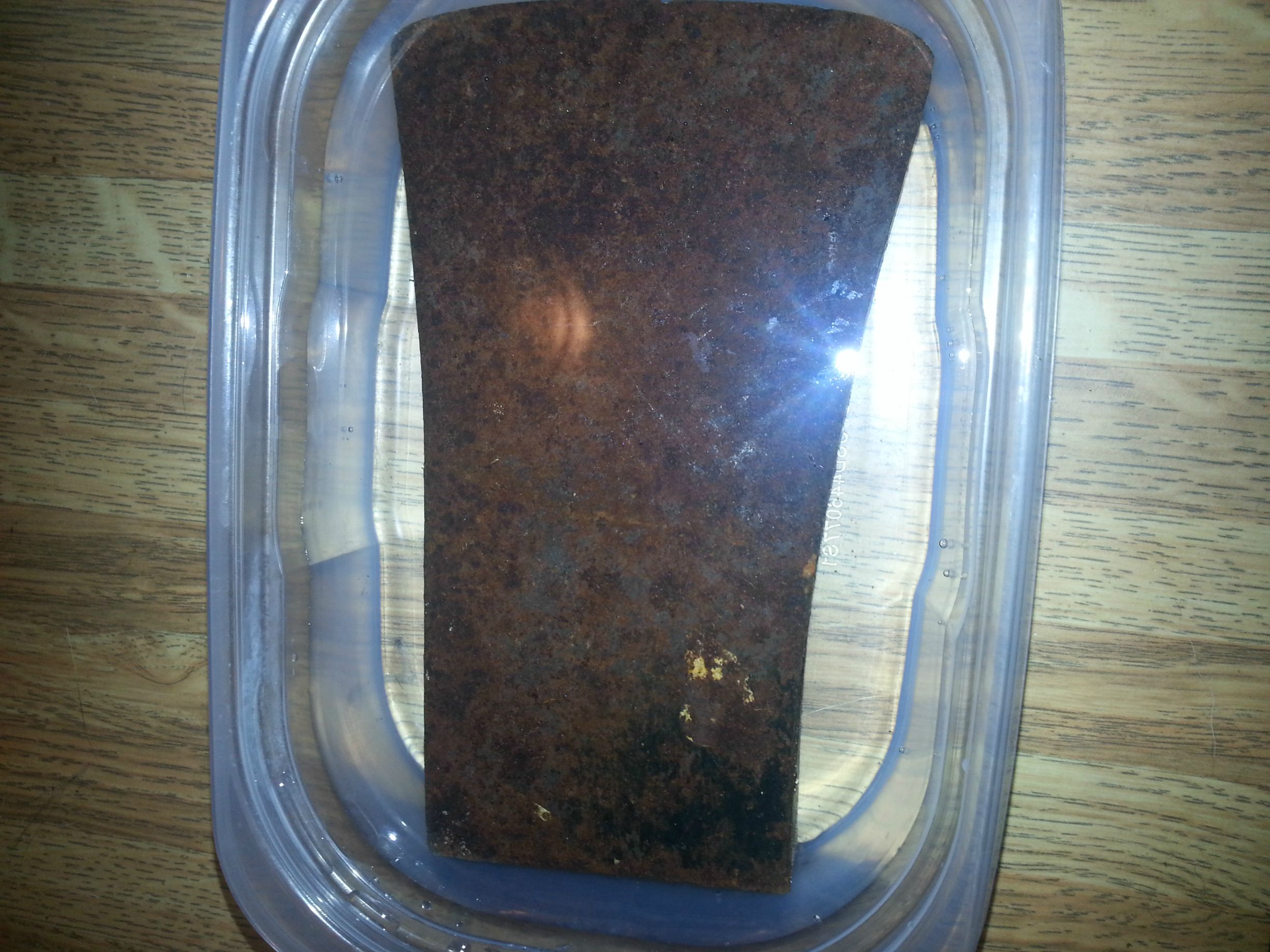

found this at a pawn shop today
only name on it is PLUMB I think, its pretty rusty
as you can see its swimming in vinegar rite now
Any suggestions on what it was, and how to make it a nice axe again?
this will be my first attempt at resurrecting a old one.
I cant go wrong, I paid more for the gallon of white vinegar than the axe head.
all told I'm in under 5 bucks rite now.

sliced lunch meat container from the grocer
didnt want to ruin one of the
wife's nice containers with one of my "projects"
so this way if I toss it when I'm done no loss
and I keep my hide intact
It does indeed say PLUMB in distinct block print
now that its had a few minutes in the liquid to clear up a bit

in less than 30 min in vinegar I'm already seeing a lot of paint coming back up
out of the rust patina, even appears that there maybe some kind of number under the plumb imprint
its kind of in a rectangle and maybe a size below, have to wait for the rust to clear a bit

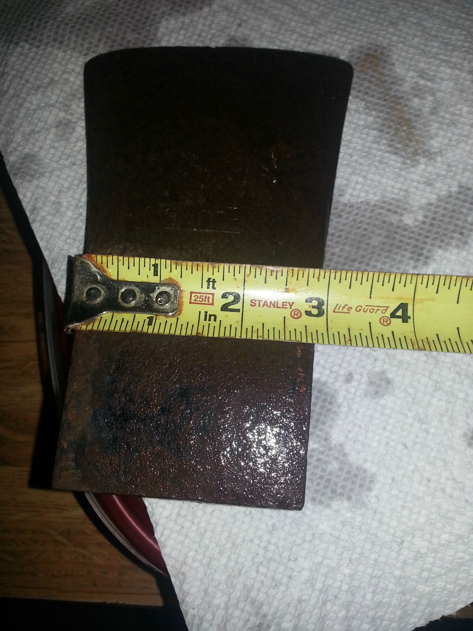

so here goes tape in pic to give sizes
if I had to guess from feel, its around 4lb(ish) but again its a guess

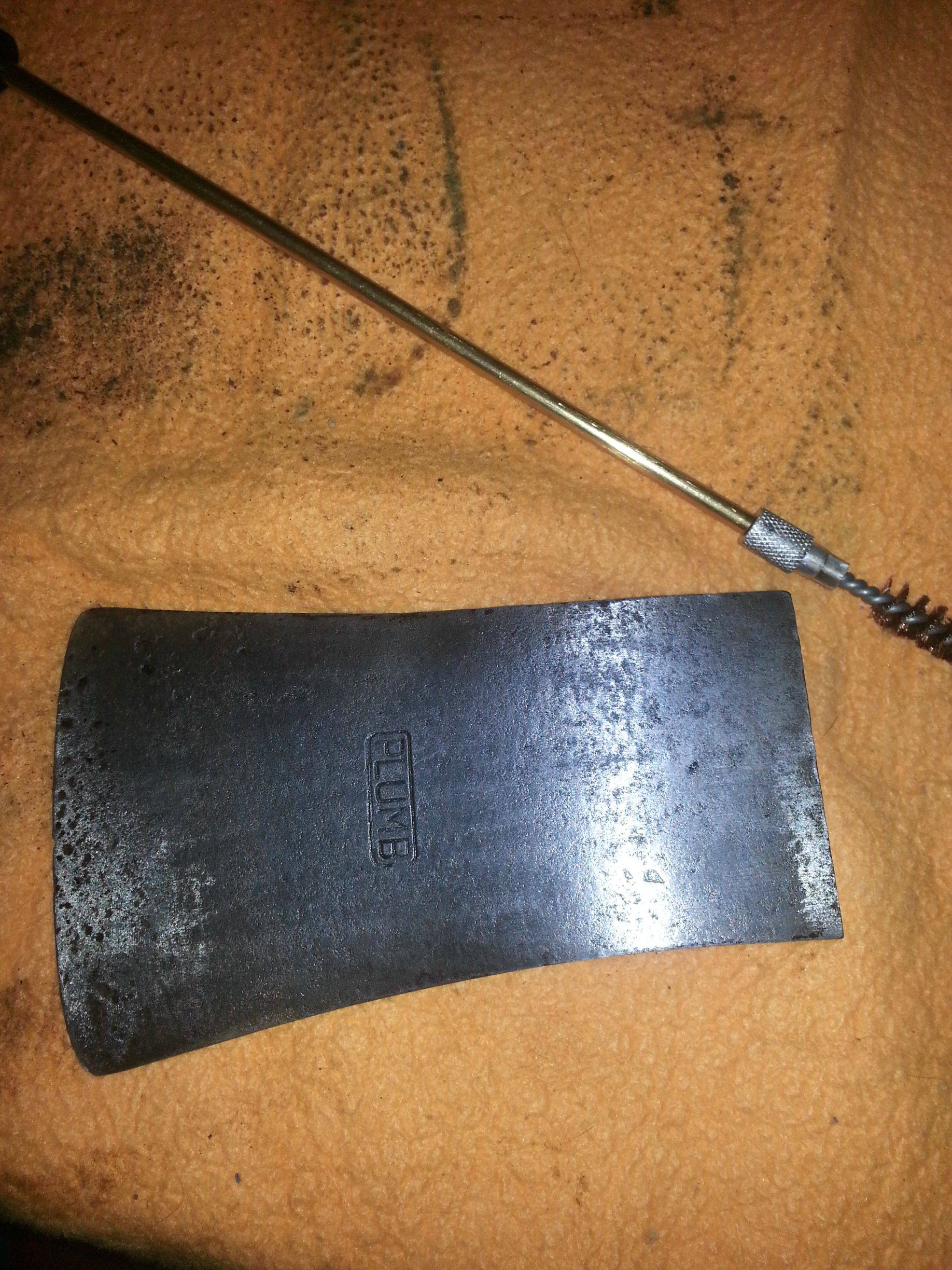

well not sure which it is splitter or boys axe regardless here is what it looks like today after a bath
and some stiff bristle nylon brush and green scrub pad work
not sure what oil you guys used on the rest here, new to this
I had my gun cleaning kit handy so I used what I had
cleaned up ok so far, not happy yet but this is what it looks like today
The impressive part is that the head was never used as a hammer or sledge. The majority of previously-enjoyed axes have been improperly used to pound spikes/brake drums etc. An axe file will sharpen up your blade no problem and there is lots of blade metal left for you to work with.
Nice find. There is a rule of thumb formula for determining handle length but only use and experience will tell you what your own preferences are. Getting decent handles these days is difficult with the major manufacturers having down-sized to 3/4 inch stock thickness rather than the traditional 1 inch of years past.
