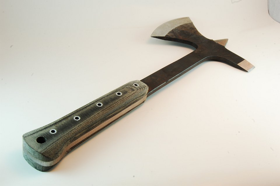

not as difficult as you may think.
buying wide plate stock is expensive, but you can make 2 hawks and several decent sized knives from a 1/4 x 8 x 18" plate of O-1 if you plan things out well. (the below were made from 6" stock and were cutoffs from someone else's project, which limited my ability to have a back spike)
