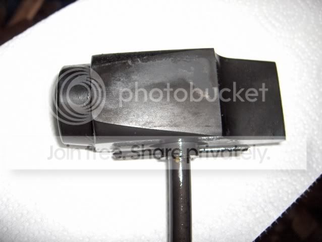

I have not used any anti scale compounds for three years now. That includes three lbs hammers that require much longer soak times. Got tired of the mess and the burn through spots. I use a very lean hot flame to bring the forge up to heat and then back off the air and increase the gas to make a very dirty flame. This is the last hammer I ht'd right after quenching. No pitting or heat scale after 15 minutes of soak time.
