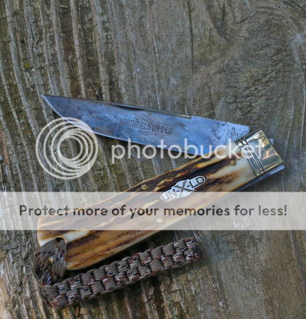

Now thats it's spent some time in the pocket, it's changing very rapidly.
This is not at all a complaint, more of an observation. I haven't done anything to lighten the stag, I like to let things go naturally, but this knife actually pealed some, like the stag had dead skin on it that flaked off.
I was wondering if anyone has seen this before?
The other side is loosing a little of it's darkness too, which I like.

The same thing happened to my 73 single blade. It just flakes off or rubbed off very quickly. I don't know if its because it was just dirt that was making it dark or what. On the other hand my new 57 in stag is stable. The colors also match that of stag died with potassium permaganate.
You know how antlers in the wild usually get dark just from dirt and crud? I almost think that is what it could be. I died my 73 and ever since it hasn't changed. Even when I went after it with a buffer just to see.
I could be way off so please don't take this as fact.
Kevin
Great looking knife! Ive seen that peeling on slabs ive bought before.Sometimes i peel it off and it looks ok,but sometimes it looks terrible,just white underneath.I dont know why.Just a natural thing i guess.Perhaps the darkening chemical lifts a thin layer sometimes?

Stag: I work with stag every day. When working stag you must remember a few things. First...most of the dark color of stag is dirt...velvet and most times a combination of both. If you wire brush a pc of stag it will turn a light tan/yellow/cream color. Then into the potassium permanganate where it may stay for a few minutes or a couple of hours. People began to like the look of dark stag when the Indian people sprayed the stag with PP to alleviate the critter problem before exporting to England. It is a product to control pests, bugs, critters!! It is still used for this and to contol water born fungus and a few other things. Not really sure on this one. If the color is rubbing off on your new knife it was probably not cleaned very well before burning with PP. It could also have been very lightly burned. Burning here does not mean burned with a flame but...oxidized by the PP. You can control the amount of brown to black with time and the right piece of stag to begin with. You just have to experiment with the piece and the PP. The texture of the stag often determines the amount of burning. Porous stag oxidizes more rapidly and darker than smooth worn stag. Knife companies often do not have the time....$$...do clean the stag well...thus you have a quick lightning of the product. Smooth as well causes this. The best stag for burning is a piece with lots of popcorn. Unfortunately everyone wants it and no one has it any more...or rarely has it. The Indian government has stopped all collection and distribution of Sambar Stag. What is here now will be it for a very long time.

Most of the stag I've seen peel was burned (with a flame) stag. I'm in agreement with John on the dirt or
whatever is on natural stag. Best way I've found to clean it is sand blast and wire brush after. I believe the
pinnacles in good popcorn stag are taking the burn from the sides of the "little mountain" as well as the surface
hence a deeper darker burn on the high spots and the resulting depth look to the oxidized burn.
