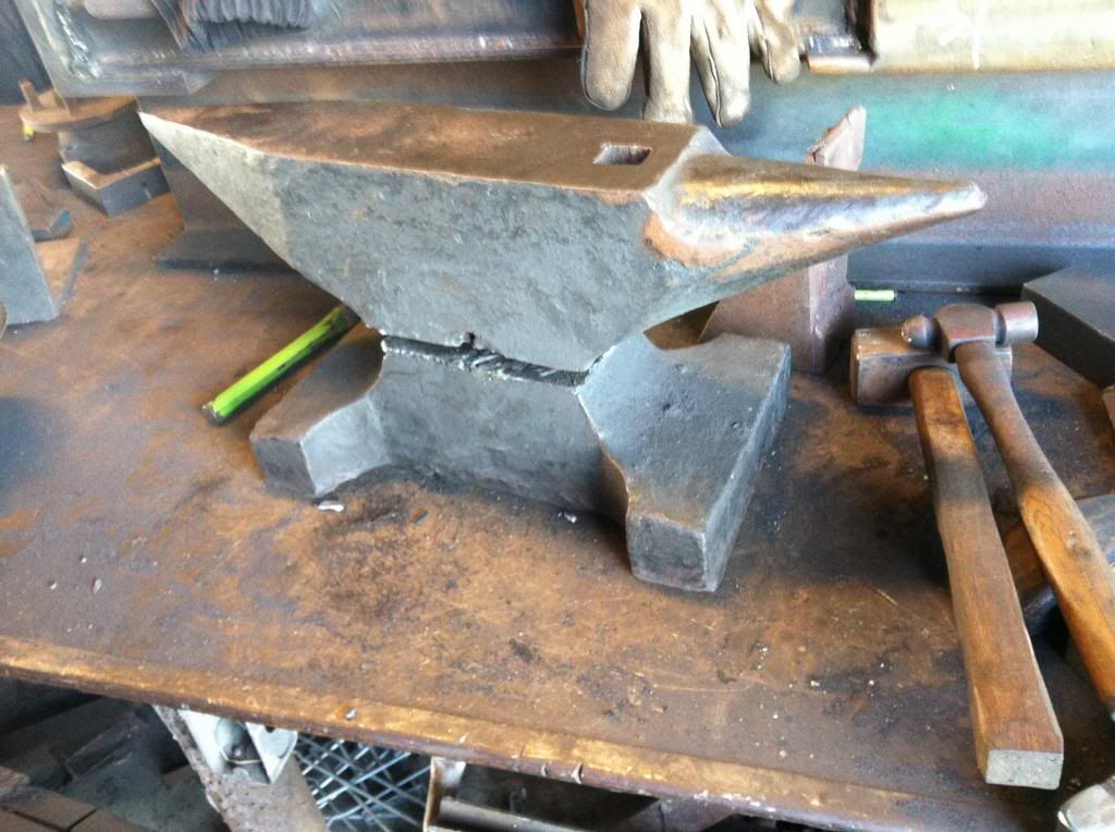

I thought some of you might find the construction of these beasts to be quite interesting... After all, how many people do you know that would spend the time cutting an anvil in half???
That actually is interesting. At first I was mad that the anvil had been cut in half. I'll bet it still worked fine. But then, the contents proved interesting. It seems like maybe Peddinghaus should not have let this one out the door, but who knows.
I just hope it gets welded back together.

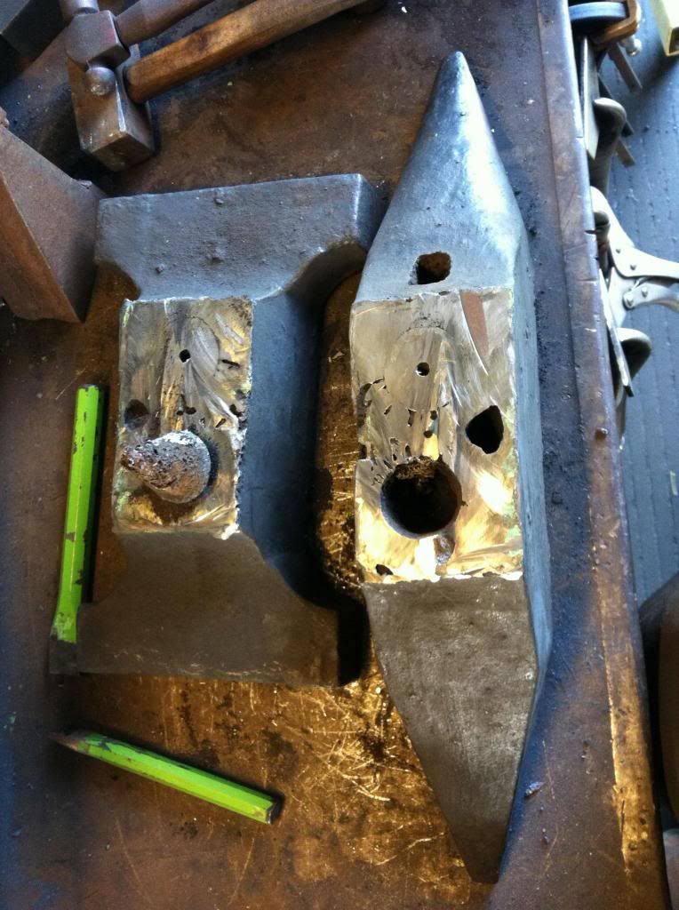

Yeah, the void that you see there had the volume of almost two 16oz bottles of water, and the rebound was 40% max... I've restored a few anvils so far, but this one's issues were a different monster all together. I'd planned on drilling the cavities out and filling them in with weld but this cavity is huge! I'm back to the drawing board as far as ideas are concerned...
Send the vid to Penddingauus for comment. Jess
I wonder if they would honor the 40-50 year old return policy? If I were them I'd honor it just to get the pics and vid of the internets... Seems like an interesting way to construct an anvil to say the least, as if these cones were meant for tensioning after press-fitting the two pieces together? If you take a close look at the center of the circular pin i cut in half (not the cone) you can see a center hole... That little hole is threaded...the thread pitch is huge...
I had a machinist friend of mine take a look at it, and he'd never seen anything like it in his 40 some years of work...

I honestly hadn't considered bronze specifically... I'd originally thought lead, but bronze sounds a bit healthier. The anvil itself is quite hard, a file skips across the top even when you try to dig. If I can keep the interpass temps lower by running weld beads it might be a better option..? True challenge; I just have to keep it from losing it's temper all the while filling in the huge void. A fools errand to say the least but I have a real passion for getting anvils back in service.
I've thought seriously about just going to town on it with the stick welder, not worrying about annealing it, and just rehardening it by my own means... I just cant for sure tell what kind of steel it is?
I get very small/faint short bursts of red with red-orange clusters, then I'll get longs streaming sparks of yellow/white with a lot of fanning clusters...I'm no metallurgist, but it's weird stuff to say the least, almost as if the the steel isn't the same consistency throughout...?

I contacted RIGID through their website option yesterday and received a phone call from them this morning. I spoke with the regional sales rep Larry, who directed me to their customer service representative Irwin, who promptly transferred me to a tool tech by the name of Mike. In spite of how awkward my question came across within 5 minutes I was talking to the right guy, which is pretty uncommon in my experience dealing with customer service.
Mike stated that the tensioning system that was utilized in the earlier Paul Ferdinand Peddinghaus anvils was obsolete technology regarding their modern manufacturing methods. My guess in their reasoning and utilization of the two-piece option was due to limited industrial capabilities. I pointed out in the video what I thought to be a faint arc weld in the #12 RIGID; this was a false observation. Apparently the RIGID Peddinghaus anvils are all one-piece drop-forged tool steel, which is actually quite impressive. "Simple is Betterer"; there is more consistency in the anvil and less that could go wrong with the one-piece option.

Awesome to see the void from the casting. Surprising that the maker didn't offer to replace the faulty anvil.
Repairing the anvil.... I wouldn't try to fill the void with something other than welding rod. You want a good bond between the two types of metal, and just pouring brass or bronze into the cavity isn't going to give you that.
On the upside, I don't see a need to weld up the void. If you look at it like an older anvil with the welded-on top plate, what you've got is a fairly thick top plate on a good base.
I would just fill the void with some lead shot and a squirt of oil, then weld the two pieces back together. Invert the anvil so the face is in direct contact with the metal work table. Use a sheet of copper between the two so heat transfer is maximized. The heat from welding will be pulled from the anvil into the work bench, minimizing any chance of softening the anvil's face.

Please disregard any of the aforementioned content associating Peddinghaus with the anvil above. With a great bit of discussion and due diligence, along with some very thorough research from a friend in Germany, the manufacturing of Peddinghaus (Rigid and Paul Ferdinand Peddinghaus PFP) have never utilized the pressed cone method, even for R&D purposes. They've manufactured P'haus anvils the same way, consistently, throughout the age of modern industrialization, since the first original PFP anvil became available to smiths in the early part of the 20th century, even when they expanded manufacturing to the domestic US in Bradley, IL.
I will post an updated video to counter the earlier misrepresentation and misinformation disseminated in the previous video. I'm sure everyone can respect the notion of deleting the video in it's entirety. I'm not one to even entertain the idea of spreading fallacy and or even assumption. Thank you all for watching, commenting, and taking part in the discussion. The new video will not disappoint! :thumbup:
