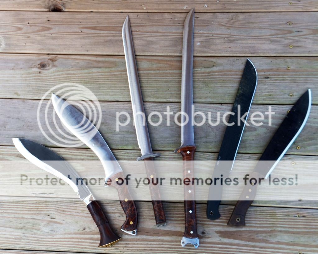

Lol, I almost posted something similar to LVC's, but thought better of it, glad I did, because I couldn't have said it any better ( probably quite a bit worse actually) than he did. If I have time, I may shoot a video of a waki, skizzy, Zilla, 1311 and a HI kuk chopping 2x4s

I hope you can make your best effort to shoot the video...I´d be much thankfull. a thorough test is much needed.
Getting it together, probably be a few days, need to build a sturdy stand to chop on. Got all the participants sharpened up though
