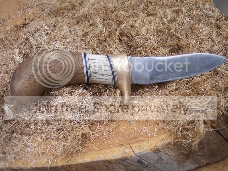

i have been kicking around the idea of developing a set of non destructive tests for knive to test for performance. what i have come up with so far is this.
blade geomatery test. tests blade shape and grind in relation to thick.
sharpness test. a repeatable test to test just the sharpness.
flex test. test to see how much force it takes to flex a blade a preset distance.
what else should be tested for.

Jarod, I would applaud your testing as long as it is well thought out and for the right reasons; you can test in any way you like and be happy but if anybody else is going to care about your results it needs to mean something. Believe me the knife business already has enough meaningless tests for little more than shameless P.R.
I would immediately suggest defining exactly what you are measuring by your flex tests, or not bothering with it. It is a paradox that there are so many "flex" testing their knives to measure things that "flexing" has nothing to do with. So here just be aware that heat treatment or alloying will have no effect on flexing whatsoever despite the number of tragically misguided people who believe it does. If you are going to "flex” pay very close attention to the cross sectional geometry and thickness of the blade so that you can measure its properties via its modulus of elasticity. You may be able to find the best cross section geometry for rigidity in your knives and actually come up with something useful from flex testing.
The test for sharpness that you suggest is good and often attempted and it would be great if you could find a nice standardized method, but the aware that if you actually come up with a good accurate test you will never get everybody on board as there will always be those who will out of hand reject your test especially if it has the potential to contradict theirs.
I would strongly suggest tests for the part that is most often forgotten in testing- the handle. This is the human interface and is the major contributor to whether a knife "feels" right and is a proper hand tool. All the blade tests that are done are fine by themselves only if the blade will be mounted in a machine and never be used by people. But if we want to determine if this thing will function as a hand tool for humans we should be testing the most critical interface in that regard. Not just how comfortable it is the moment you pick up the knife but how will it feel after using it for an hour. How does the shape and angle of the handle affect cutting ability? How strong is the handle and the handle design? This is very often overlooked. I see some handle designs that are very popular these days that have some serious weak points.
There was an article written many years ago in KI that stirred some controversy which involved field testing of camp knives made by mastersmiths, it was perhaps the first time this was really done. The results were quite surprising, even in the stuff that made it to print. I am to understand quite a bit didn't make it to print when handles outright failed that were made by smiths with ratings that put them at the top of their field!:confused: A more recent repeat of that field test in another publication once again stirred even more controversy because the author dared to point out what he felt were disappointments in.... you guessed it, handles. Instead of getting angry at the messenger I think we makers should take this as a sign that we obsess too much over blade performance that we forget about the handle. This will not fix itself by killing the messenger. Jarod, I would strongly encourage you to find tests for handles.
Regardless I do applaud your ambition as you are taking on a tall order if it is to be done right. Tests without tight controls, total consistency and repeatability are meaningless and even harmful since they are very prone to influencing or interpreting in the direction that makes you feel best or allows your work to look good. I have said it many times before and it bears repeating- Testing done for the purpose of making your knives look good is not testing, that is called advertising, or marketing gimmicks.
