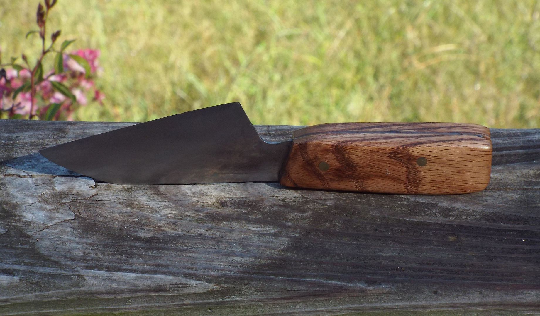

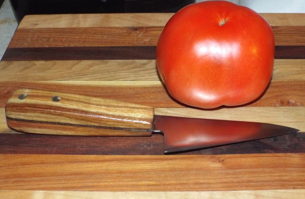

I make kitchen knives to be used in the kitchen. some end up pretty, some don't. on my list of things to do to make a knife, making it pretty is toward the bottom of the priority list. for me grind and HT are one two. for regular kitchen knives, i usually use 1/16" O1 PGFS at Rc62-64, primary bevel about 7 dps, 0.005" at the edge, 0.02" 1/4" up and 0.03" 1/2" up. I usually make handles of book matched hardwood.
examples
1.2519/O7 tool steel at Rc65. canarywood handle
O1 at Rc62-63, red oak handle
the handles fit well in the hand. you can chop on a cutting board and not bang your fingers. will slice proteins, veg and fruit paperthin. will push cut newsprint and shave without pulling. but if you look close, the blades have some scratches and grind marks.
scott
scott

I will admit that I feel that the handles you showed are kind of ugly and utilitarian BUT they probably work great as you said! Lots of Japanese kitchen knives have a really simple straight and oval or octagonal wood handle and those work great for me in the kitchen. It's nice to have a pretty blade too, but once it starts to get used... I've put scratches on soft cladded san mai with just the rough skin on my fingers and wasn't happy at first but it's a tool not a jewel... :)
this is one area where function wins out over form. my handles are straight so they fit in the hand and allow you to find the comfortable position. they are thick because i have very large arthertic hands that need a large handle. I also use handle size, shape and material to achieve overall balance.
