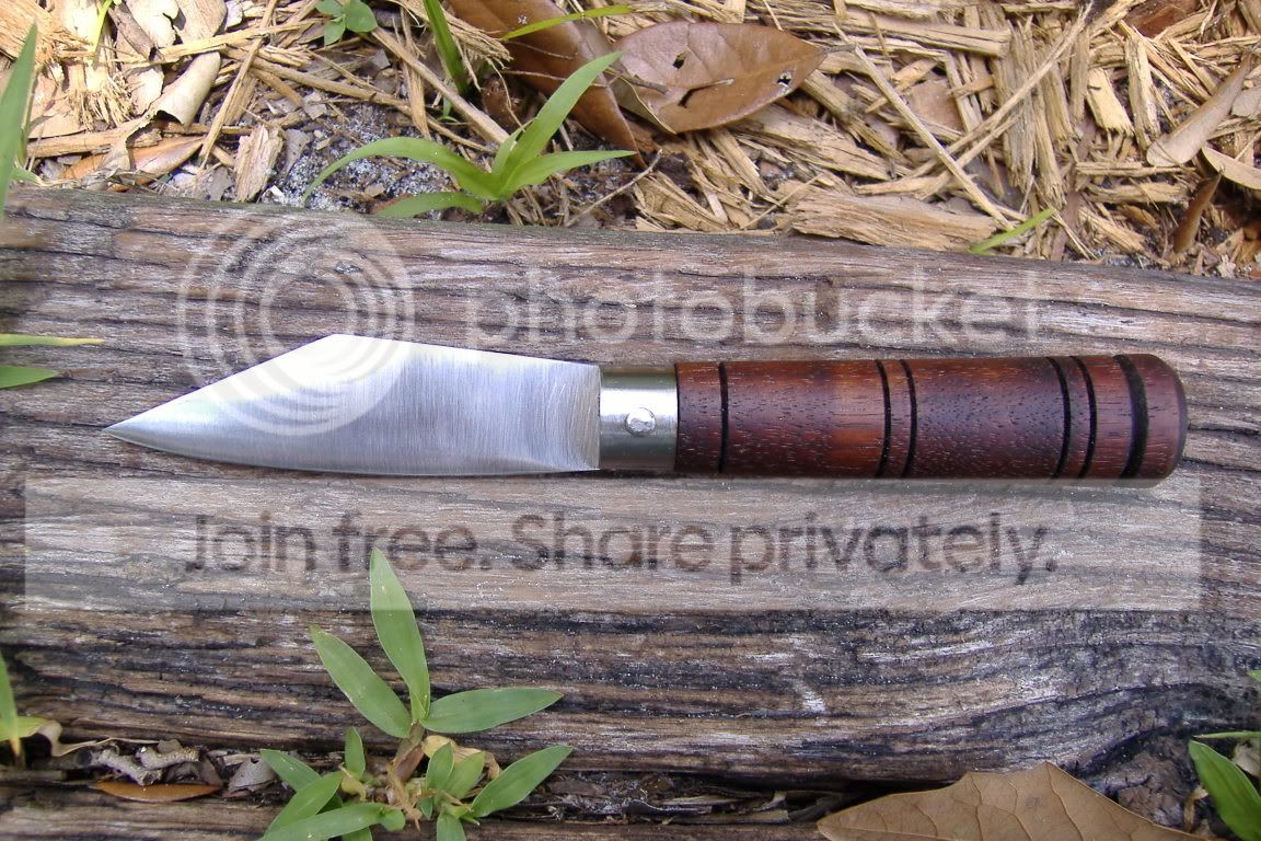

I looked at a "period knife" on the Makers/Straight Knife side of BF and looked at Stephen5's French Period Knife. Rather than walk all over his thread, I thought I would ask your opinions here.
Stephan5 has evidently studied this style of knife and done all he could to make it historically correct. In it's time this was evidently a mass produced knife made in large numbers in a factory to be used for sale and trade and the exact replication is important to some reenactment people.
Reenactments take place in everything from the revolution to cowboy days and everyone has their own ideas about how these dress up knives should be made. All agree that they must be made from tool steel but differ in thier opinions of style and workmanship. Does a period knife have to be poorly made with a sloppy fit to be a good replica? I am sure that most historical knives were made by local smiths, each with thier own standards of workmanship and design. Some good, some bad. I personally feel that if I make a period knife I will do my best workmanship and try hard to make it look like an antique. My opinion is that any knife that leaves my shop should be a good usable tool with the best of workmanship if it is a $90 period knife or a $500 collector piece.
Dunno, looks like he took a bar of steel, bandsawed it out ground an edge on it did some woodwork and called it a replica
To make it period correct it would be forged, possibly with a slight distal taper, actually to be period correct it would likely have been steeled wrought iron if the original had been made on this continent, possibly indirect reduction if it was produced in Europe. I disagree on making "reproduction" out of tool steel without at least a disclaimer. I am currently working on making a reproduction of a 14th century knife based on the "Knives and Scabbards" book published by the British Museum. The blade is ultimately going to be wrought iron with an edge forgewelded on of steeled wrought iron, steeled until it properly passes a period style break test. My test blade so far while I work out the process has been antique wrought iron with 1070 forgewelded on for the edge, ultimately it will be wrought from my own smelt, with the edge of steeled wrought, or bloom steel with a high enough carbon to harden (If I am so fortunate) The handle will be of a specie that would have been used according to the archaelogical finds, any glue will be hide glue, and the sheath will be oak tanned and sewn with linen thread, tooled as the originals. The knife will be finished as a new knife with hand tools, and as clean and well fitted as I can make it, not as an aged sloppy "antique"

It depends on which period of time you are wanting.Pre 1800 French and English Furtrade period most were factory made and not blacksmith made.Materials and quality varied greatly and basic junk was usually refused by the buyers. Simple to more time consuming and elaborate designs were availible. Photo of my 1800 time period cartouche knife.
This is one of my French Boucherons, and an English penny knife. I use 01, stock removal, and heat treat with an oven. The Boucheron has a distal taper, and a tapered tang as the originals.

1) No - most knives of the 18-19th centuries were quite well fitted, whether factory or local made, dependent on the market, low end or high end just like today. While the majority were factory, local made products are well documented.
2) Actually as today, MOST historical knives of the 18-19th centuries were in fact factory made. For instance, the majority of fur trade knives from 1763-1840 were imported from England as were the vast majority of Bowies post 1830 or so......

Here's just a small sampling, but all of the follwoing were made "new" using as many period techniques as possible and with the view that they were made by a smith here in the Old Southwest, which maintained a long tradition of local iron work. Once together they were aged to certain look as a whole, just as any used knife does.

I and several others (including Shakudo), have had artifact blades of the 18-19th Century analyzed and in all cases I've seen or read (about 30 or so altogether) the steel analysis was/is virtually indistiguishable (just minor %'s in the trace elements) from the 10XX series steel, in the .55-.85 carbon range. In the the market for reproductions, it has long been understood held that certain products (such as the type steel except in the case of Stainless or other exotics) are used without disclaimers - while adding the fact you made your own steel can be a good marketing tool, most see no reason for more than that.....
